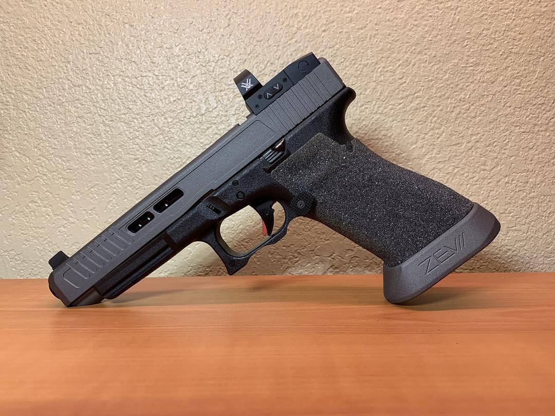

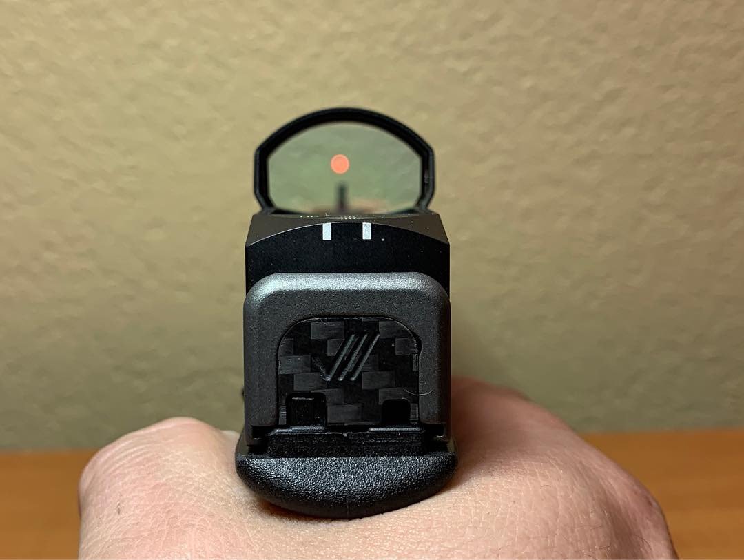

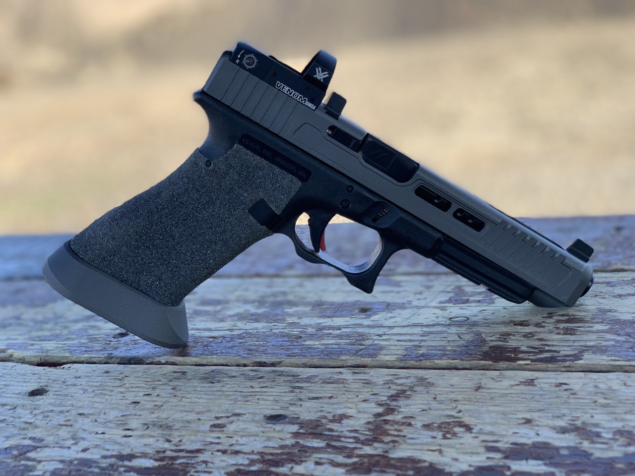

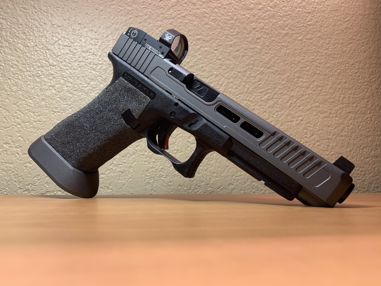

    Here are a few pics of my G35. Slide was done by Boogeyman customs. It has a Zev 9mm conversion barrel, mag well, mag release, and Fulcrum ultimate trigger. The color is Tungsten with 20% Graphite Black added. I did all the frame work myself.

    I usually don't care much for the highly modded Glocks but that looks clean.

    When using the zev barrel, are there any other parts that need to be changed for reliable function? Thought I read that the extractor needs to be swapped as well.

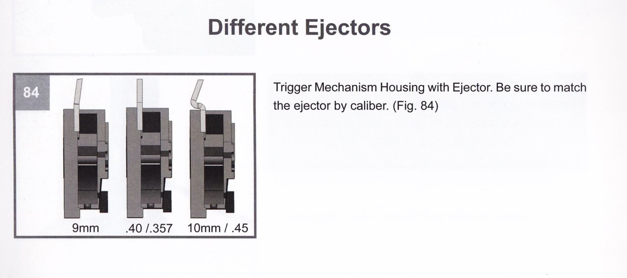

    It worked as is, but ejected almost strait up. You can install a 9mm ejector, but I just bent my original very slightly until it ejected properly. its only $7-8 for a new one though.

    Thanks! Been wanting to switch too. So the ejector is different, but the extractor is the same? Curios.
