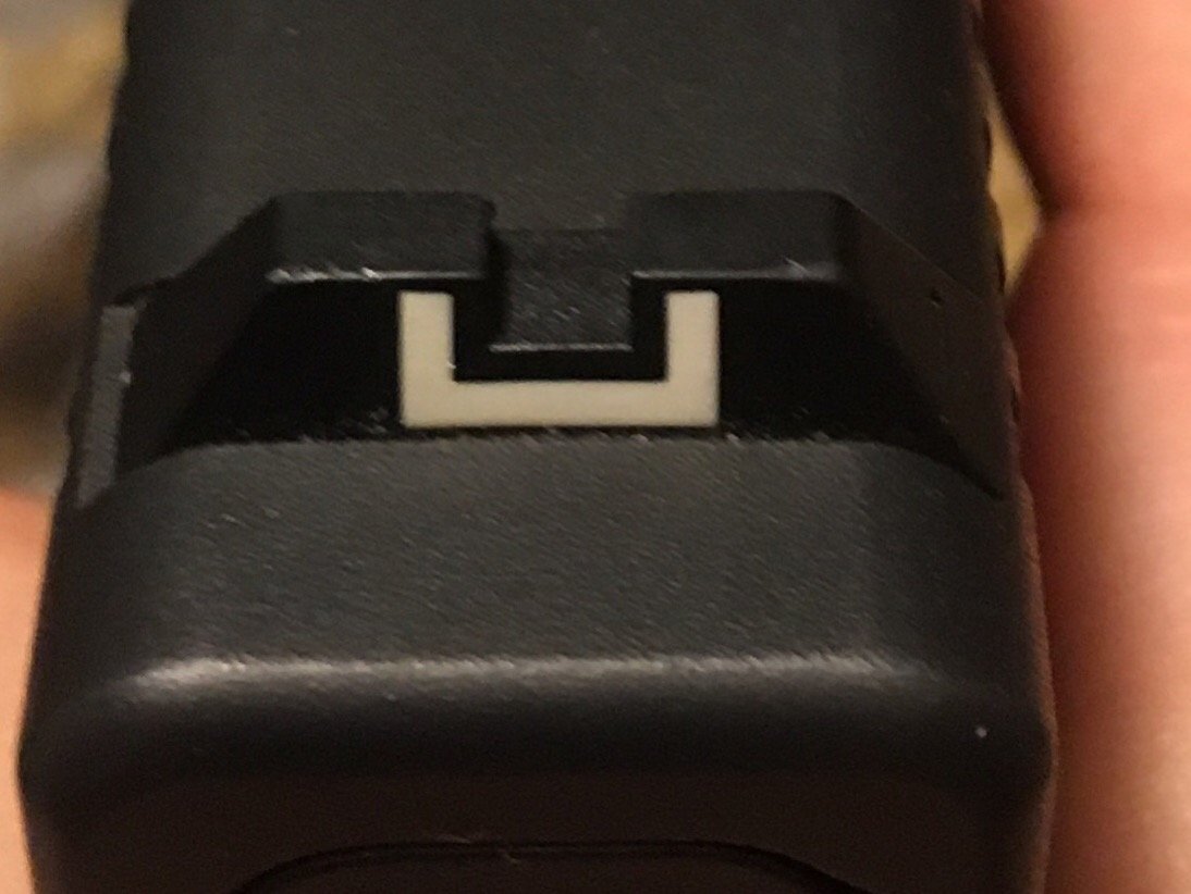

    Exactly what I had to do with my Gen 3 Glock 23. Dead steady hitting left every shot. I drifted the rear sight (factory) to where the base of the site is flush with the slide and it's hit dead on the money ever since.

    Pic for reference.

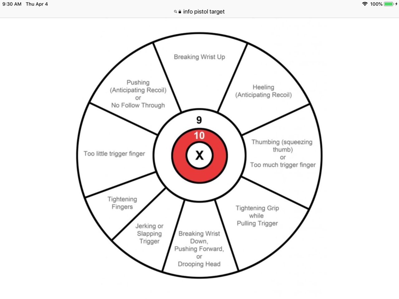

    Maybe this will help point you in the right direction.

    Yeah I've seen that chart in my CCW class, and it's definitely helpful for a new shooter. I've actually been planning to go shoot with a friend who's just getting into shooting pistols and that chart could be helpful, so thanks!
    If that was the case though, I must be using much too little trigger finger on that pistol only, and then great trigger control on all my other ones. I'm not 100% able to rule out trigger control until I go to the range and shoot over sand bags, but seeing as I shoot all 3 other pistols just fine, I don't think that's going to be the main cause.

    if its like the pic above wouldnt you move the sight to the left more?

    I would move my sights to the left. Follow your shots if your to the left move your sights to the left.

    You would move your front sight left to make it shoot right, or your rear sight right to make it shoot to the right.
    You move the front the opposite direction you want the point of impact to move, and the rear moves the same way you want the POI to move.
