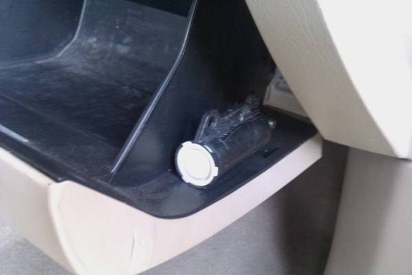

    Anyone tell me what this is ?

    Its a thing that is supposed to go on your glovebox so it doesnt slam down hard.

    Its to keep the glove box from slamming down. Even though every time after I put mine back right, it just falls the next time I open it.

    its like the glove box 5100 strut

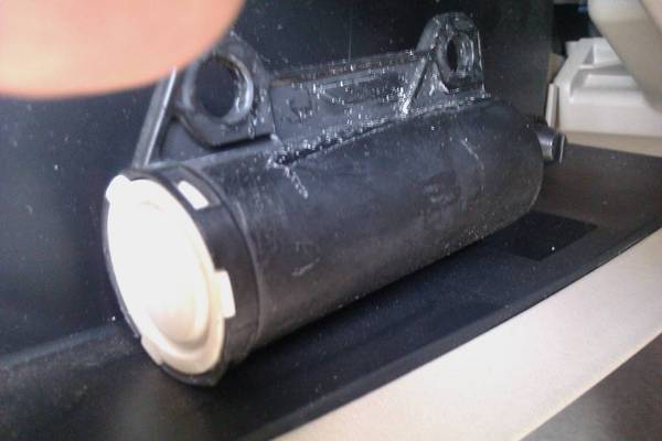

    Definitely not a container
    Those two holes need to connect to a gray tab on the inside of the dash that looks similar to the black one it's currently connected to.
    Mine works great :cool:

    XJuice, take a pic of it assembled correctly and send it to me or post it ? Can ya ? :rolleyes:

    youve gotta put the thing back on then put a screw into the post it snaps onto to keep it from popping off again. Its a documented mod on here somewhere with pics if you do a search(I threw the damn thing away, but thats me )

    Mine works but I almost broke it first time I took out the cabin filter. It is not robust to say the least. Very fragile.
