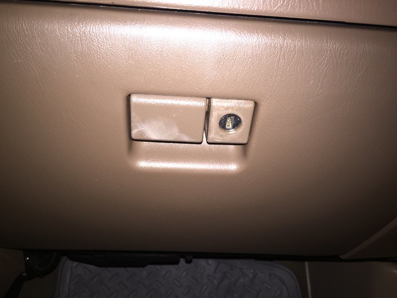

    Buy one from a 4 runner. That way you have the option of a locking glovebox.

    42,919
    Is it compatible?

    2004 White D-Cab TRD
    Absolutely. I did it........
    I think the mod cost me I think $20.......

    Iowa

    "Access" Tonneau cover. Bed Mat. Hitch, Timbren SES
    I like this. IS there a thread on this?? Looking for lock to fit 2012 base 2dr 4x4. Use a 4 runner 2012 latch/lock?
    I assume you'll not be able to use your ignition key?
    You'll have to see if the mechanisms are the same. I only first gen.
    I got the locking mechanism from the junkyard free. The locksmith charged me 10 or 20 bucks to match my ignition key.

    I assume that for a locking glove box for 2008 Tacoma with gray interior I would need to order 2 parts: 55506-35020-B0, Lock (for an '05 4Runner) and 69056-60160, Lock Cylinder - Toyota (for an '03 4Runner). Is this correct?
