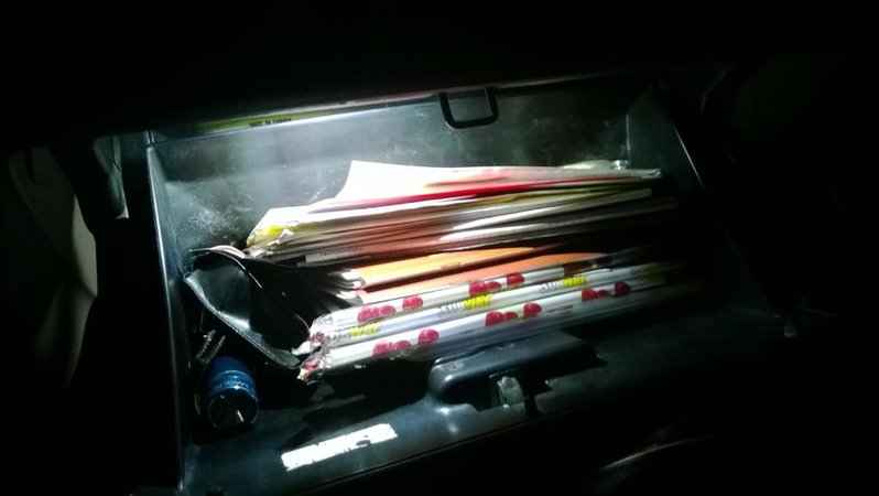

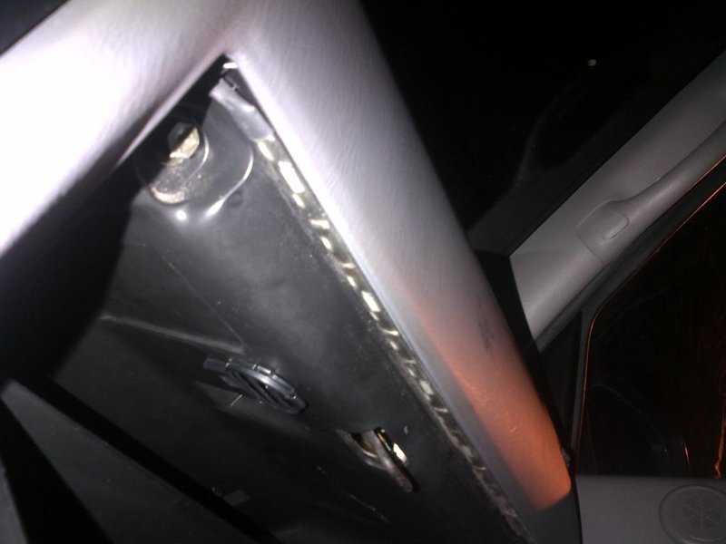

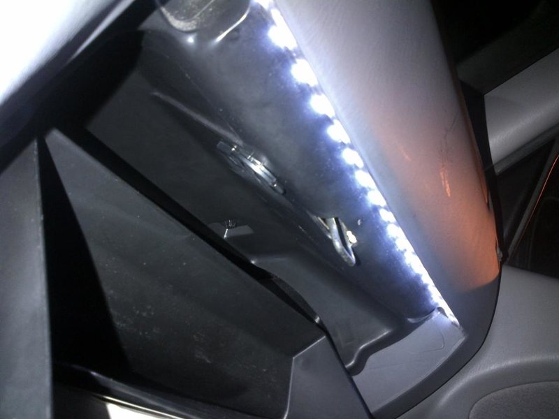

    Here is my setup:
    I added a LED light strip that is wired to the bulb socket. A lot brighter than the standard bulb. This is also a good option if you don't have an existing light socket, but can find the wiring harness.
    Factory light location - just left of the latch hook:
    LED strip. Factory light location and grill is also visible:
    And the LEDs on:

    I got the LED strip at Advance Auto Parts. (Autozone, O'Reilly's, Peps etc. have them also) It is fexible and can actually be cut to any length you want it.
    I don't have a plunger either (yet - thinking about adding one) For now it just always stays on when the headlights/parking lights are on, same as the factory light, which is probably the reason why everyone's bulbs are burned out. Seems like most people don't even know there is a light.

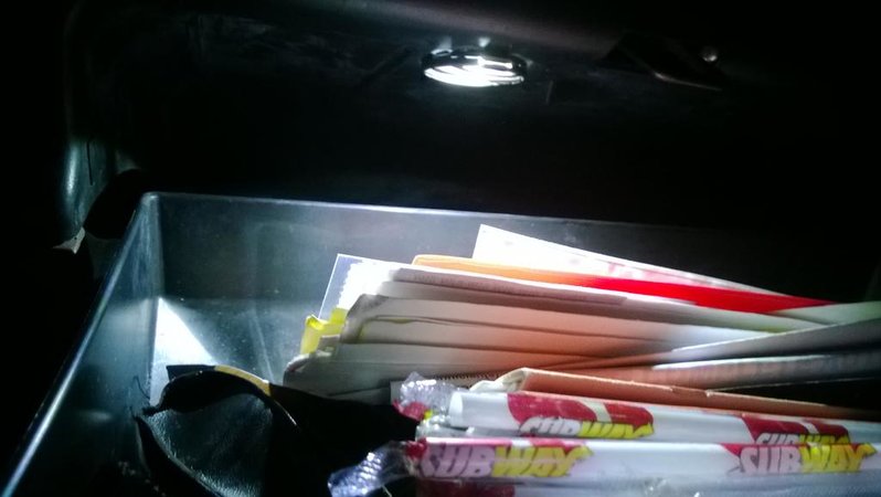

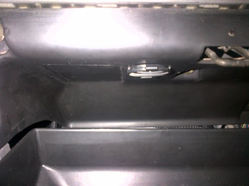

    Plug and play. The bulb is pole specific, so it will only work in the socket one way. The first one I threw in it was a little loose, but I found a good fit among the six I ordered. Pics to follow.

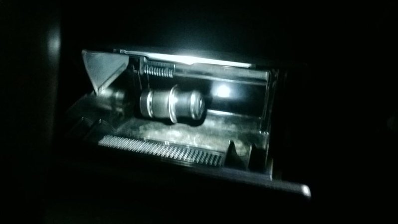

    Pics below are what I have to work with. So far, I'm very pleased with the improvement.
    I also replaced the shifter light with the same type of bulb, and swapped the instrument cluster lights with 194 style LEDs. Still have work to do, but it's looking great.

    Knew about the ash tray light, since it still works, but never thought about upgrading it to an LED. Ordered LEDs for it and the glove box (now that I know about it having a light). Eagerly awaiting delivery...
