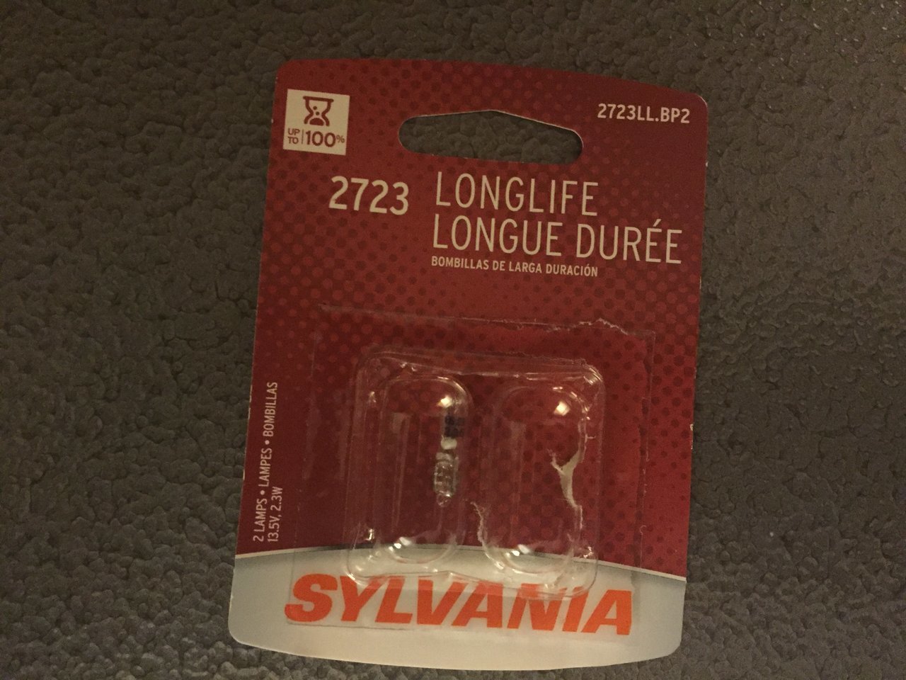

    Just found out I too have the glovebox and ashtray lights. Ashtray light works, still original bulb, not very bright. But, I don’t care since I don’t smoke and hardly ever open it. Had to change glovebox bulb though I just went with the incandescent bulbs; I may switch to LED’s in the future.
    Got the glovebox bulbs from Autozone if anyone plans on staying with incandescent bulbs.
    Didn’t have to disassemble anything. Wear some disposable rubber gloves for grip and you can easily pull the bulb out with your fingertips.
