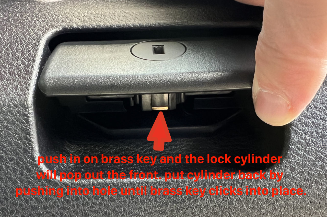

    i took my glovebox lock out to get it powder coated and this is how i took it out and put it back:
