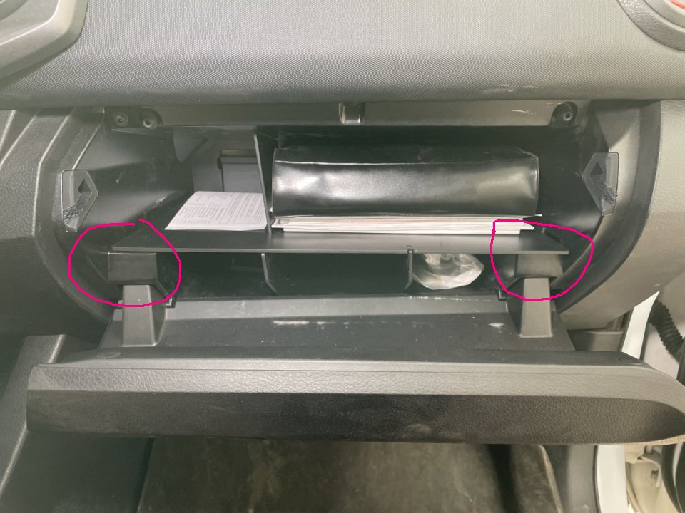

    I also had an occasional glove box rattle that took some time to isolate. It was the organizer shelf I installed where the horizonal shelf laid on top of the glove box end pieces. Simple fix was to put felt pads under the shelf.
