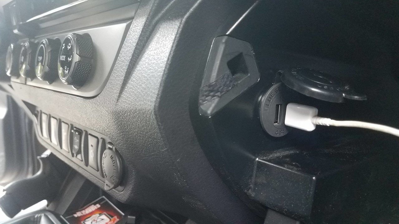

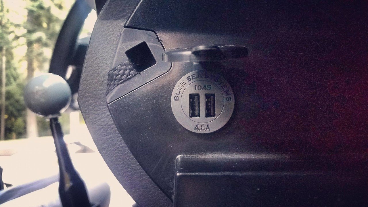

    Disclaimer: This write-up is only a description of what I did to MY truck. I am in no way an expert in the electrical field (if anyone notices any flaws in my setup please feel free to call me out).
    So for the USB I chose the Blue Sea System's 1045 Fast Charge 4.8Amp Dual USB Charger. It was around $40. I chose it because I intend on charging my phone and iPad when they are mounted on my dash and it had the best features compared to their regular USB charger.
    I removed my glove box which has I think 4 screws and a few clips that release when I pulled it out. I had to remove some other molding panels on the far right side and I also removed the left hand bolt on the airbag underneath the box (the airbag is mounted on a metal bracket which bent out a little but didn't really affect it when I reinstalled it).
    The hole I needed to drill for the charger is 1 inch in diameter and requires some plastic trimming on the main dash panel behind it (I used a utility knife for that part). Once I inserted it there is a plastic nut that threads on the backside holding it in place.

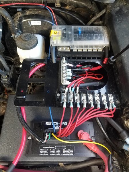

    For the wiring I used 14 awg and a 5 amp fuse. Again I'm not that electrical savvy but I'm pretty sure that will work just fine. I routed the wiring through the center console's base and through the fire wall under the steering column. I then attached the wires to a Blue Seas 12 Blade Fuse Block I have mounted in the engine bay. Pelfreybilt makes an awesome panel for mounting the fuse blocks which is the one I used.19830356_1527693163918611_624188016_o.jpg 19866940_1527692970585297_742899361_o.jpg
