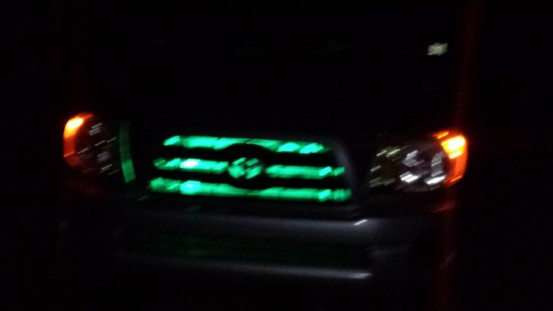

    My pictures are horrible but..Do you mean like:?
    If so..
    Mine is inside the groves in back of grill
    (I have 2nd gen ) to protect from rain and it is pointed towards radiator just cheap rgb 50/50 led strip from ebay
    Been few years and holding up great.
    Wired it off my running light fuse.
    I ran a add a fuse to toggle switch then to my streetglow (not sure think it's a junction box or terminal)
    Then I have my grill..glovebox..center console. footwell.. cup holder..ect.. led's running from that.
    :thumbsup:

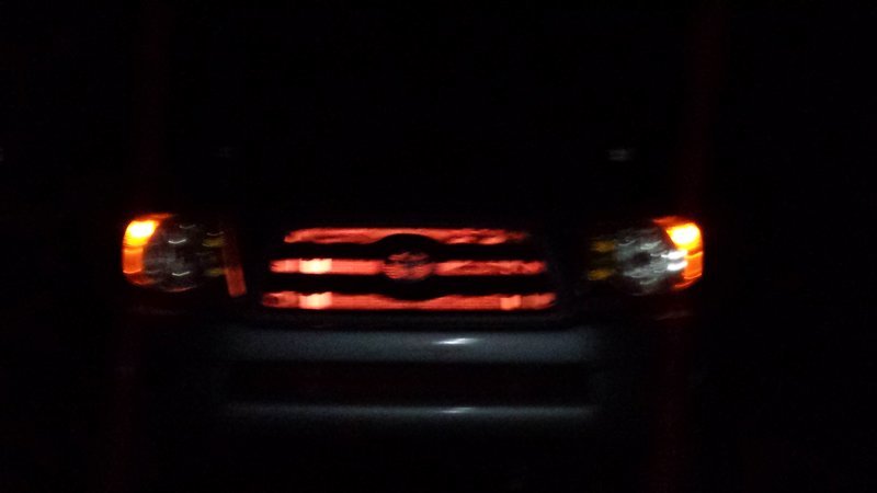

    Just a few LEDs...
    I used LED strips attached to the grill. For better reflectivity, I painted the AC condenser and radiator with high temp silver paint.
    The strips I used are the Alpena 77708 Amber Max LED Strip and are a pretty close match to the DTRL and parking lights. These are a true amber and not orange.
    I bought mine at Autozone when they still had them but I found them on Amazon too.
    https://www.amazon.com/Alpena-77708...d=1506644807&sr=8-4&keywords=alpena+max+led+s
    Here are a few pictures of what they look like on my truck.
    *** WARNING: You may suffer from temporary loss of night vision or LED envy after viewing these *** :rolleyes:
