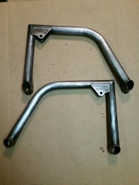

    Shock hoops and 2.5 x 14" Kings to go with them. Thanks @Evenflow !
    Just need to find the time to get all this stuff preped and welded up. Stand by.....
