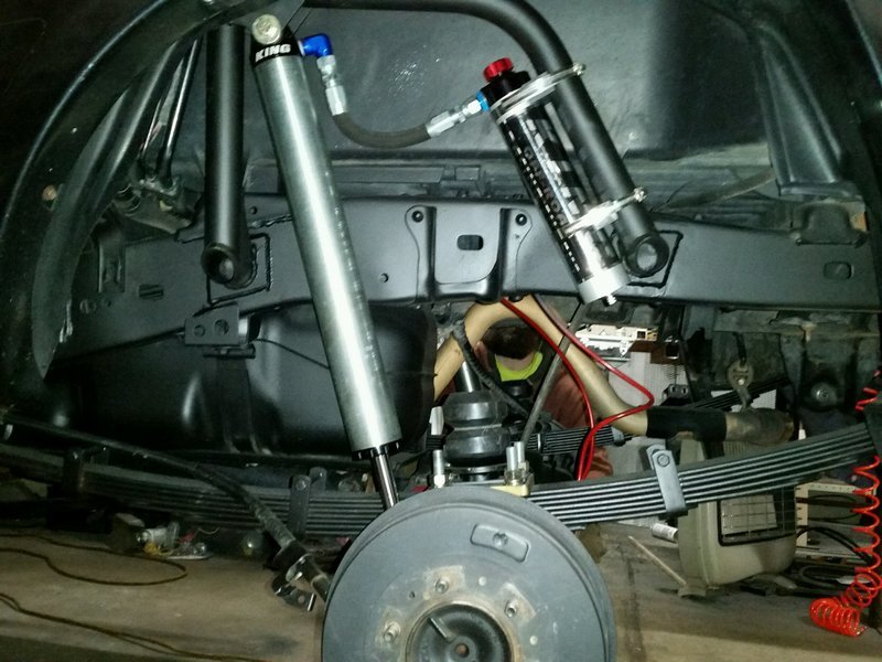

    6 inch Douche Bag lift...what else do I need?
    Leaf packs, Flip kit and Timbrens are in. Next stop, welding in the shock hoops.

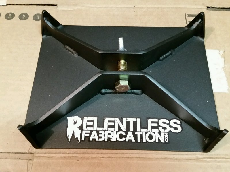

    And got something for the Hi-Lift... @RelentlessFab

    How do you keep your undercarriage so clean?

    Its not normally like that. I cleaned it all up really well and just finished up with a lot of rattle can.

    What do you use to clean it? I've got damn dirt/mid/clay stains for days...

    Simple green + Pressure washer.

    Sweet I'll have to try that thanks. What lend the of shocks did you go with for the rear?

    14" Kings

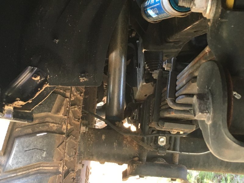

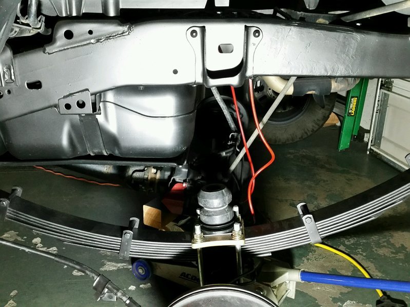

    Damn shocks bottoming out before bumpstops come in contact and still have an ass of shock left.
    This
    With this little amount of flex
  13. Mar 24, 2016 at 5:00 PM

    Interesting... do you just need different bumps? I can't understand why that would happen with the BAMF relocate and 12" shocks.

    I'm not fully sure yet. Still trying to break it down. I'm going to be ordering a shackle flip kit and some bigger bump stops

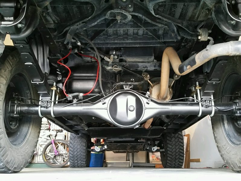

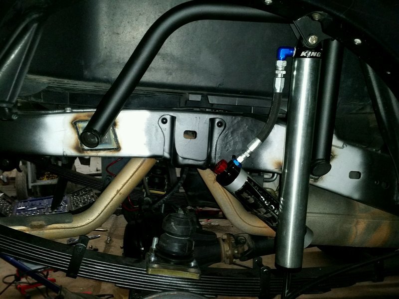

    Finished up the rear set up. Welded in the shock hoops and installed the 14" Kings.
    Looks like I'll be getting about 6" up travel and 8 inches down.
