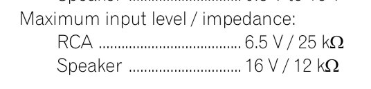

    I haven’t measured the output of the older radios but I know the newer ones far exceed the rated input stage on your amplifier. You should check with a 0dB sine wave and meter (no amp or speakers connected). Your entire gain structure and equipment selection is built on this knowledge.

    The new head unit will exceed 16V well before it starts to clip. Is it crackling at low volume or do you have to turn it up some?

    low volume is fine. input voltage is something i didn’t look into or even think about. il look into the jl. so you think its worth keeping the stock headunit sound quality wise? i did notice it is actually a pioneer headunit

    muffled and crackling indicate to me that the input is being overdriven. a LOC like the lc7i from audiocontrol would give you the adjustment you need.
