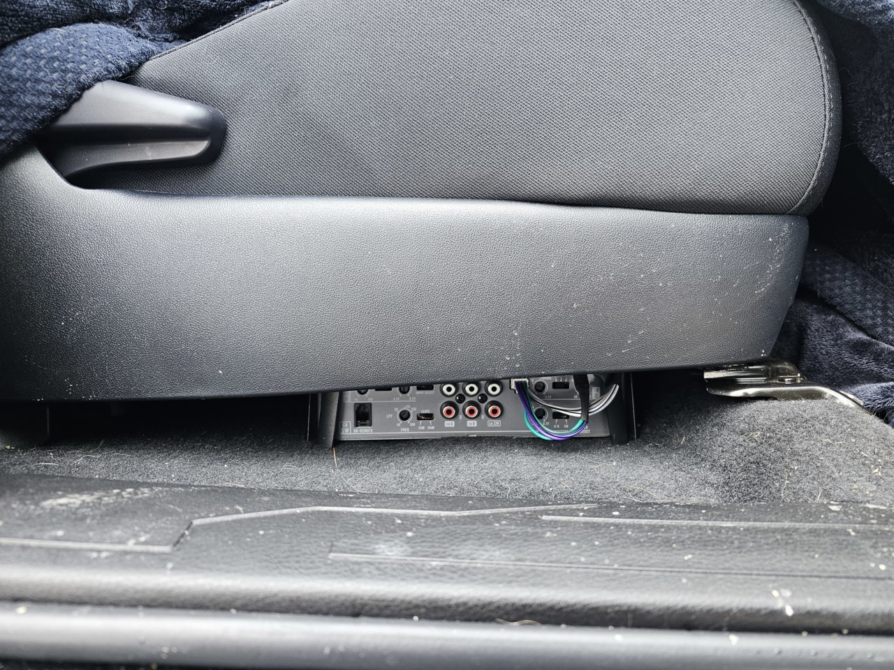

    anybody have this amp under the seat of a 2020+ truck? searching i found a guy with a 2017 that said it fit but just looking at my 2023 there doesn't look like very much space at all.

    There was a lot more room with the manual seats. The motors and stuff for electric seats take up a lot of space. If your passenger seat is manual, there may be room under there

    thought id update. amp does infact fit under passenger seat with millimeters to spare. i put some washers under seat mounts just to be safe.

    With seat risers in my ‘21 I fit an XD 400/2, Fix 82, and a Twk D8
