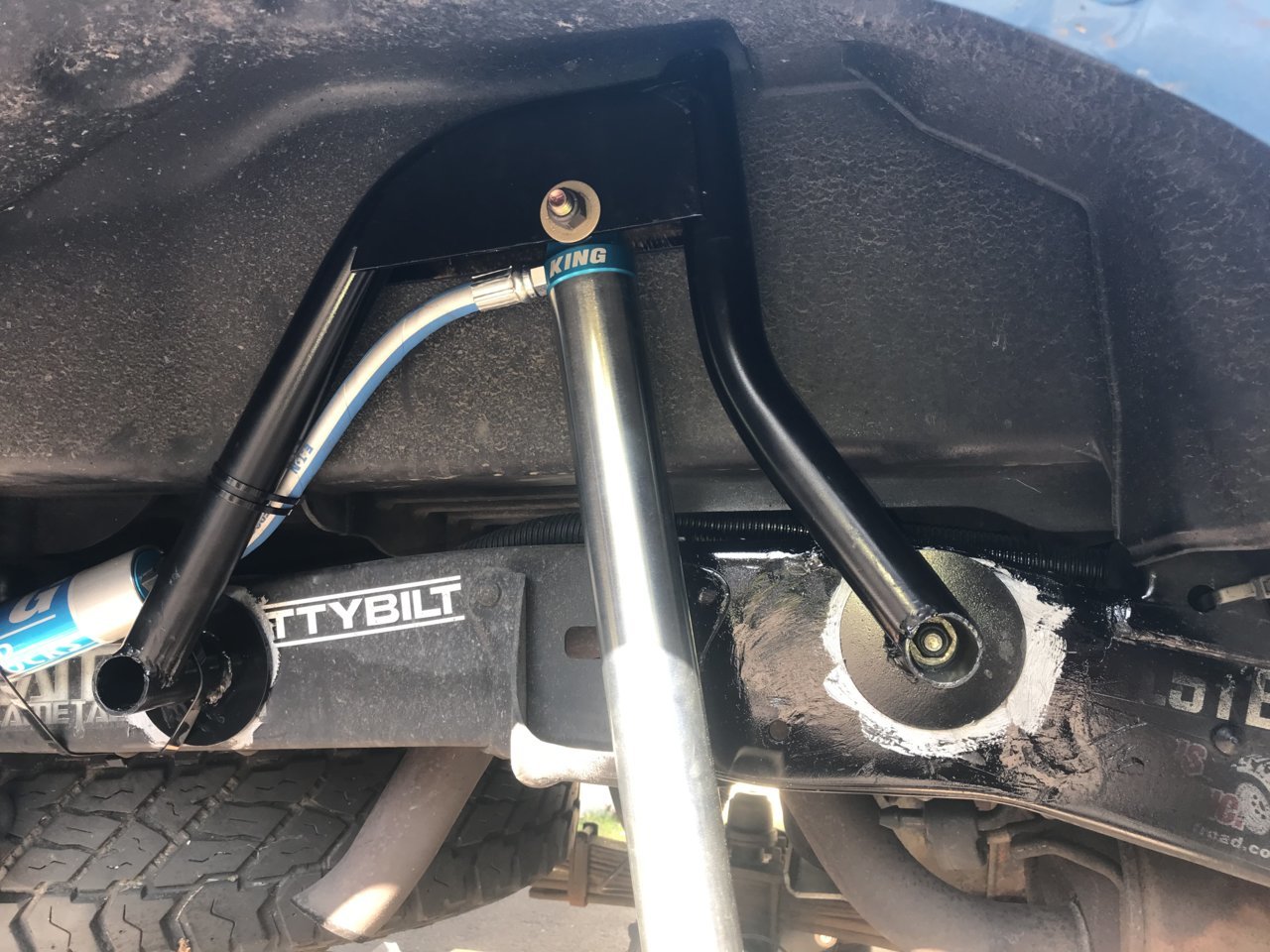

    If I knew both shock mounts would be running towards the front of the truck then I wouldn’t have had any issues . Should of looked at the pictures better

    Looks good.
    The whole thing could be rotated forward a bit to get the front foot completely on the frame.

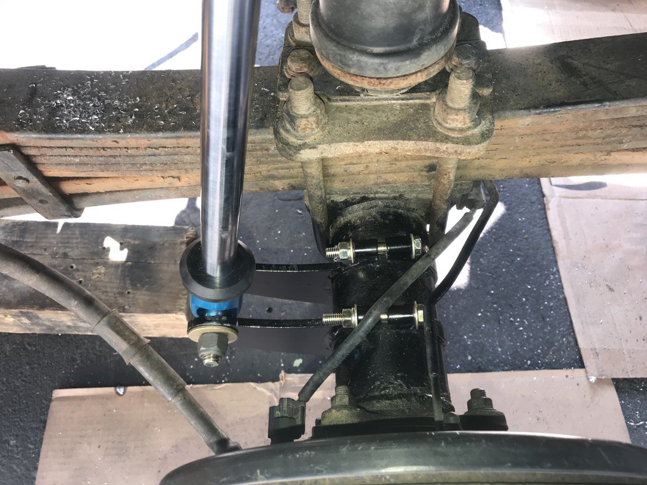

    Sprayed on etching primer.
    I used longer bolts to pull in the two halves together. Then switched them out with the provided grade eights.

    Everything is coated in self etching primer, and should definitely be painted before or after install. I like the rust-oleum spray in bed liner, because it takes rocks and sandblasting pretty well, but you can use whatever you like.
    Please send a picture of anything you need to cut/file/fit so I can make sure it's changed on the next batch, but yes if you need to do minor fitting do it up.
    They got longer bolts than you, so they should be long enough, but if not then a long 1/4" bolt will make a good puller.

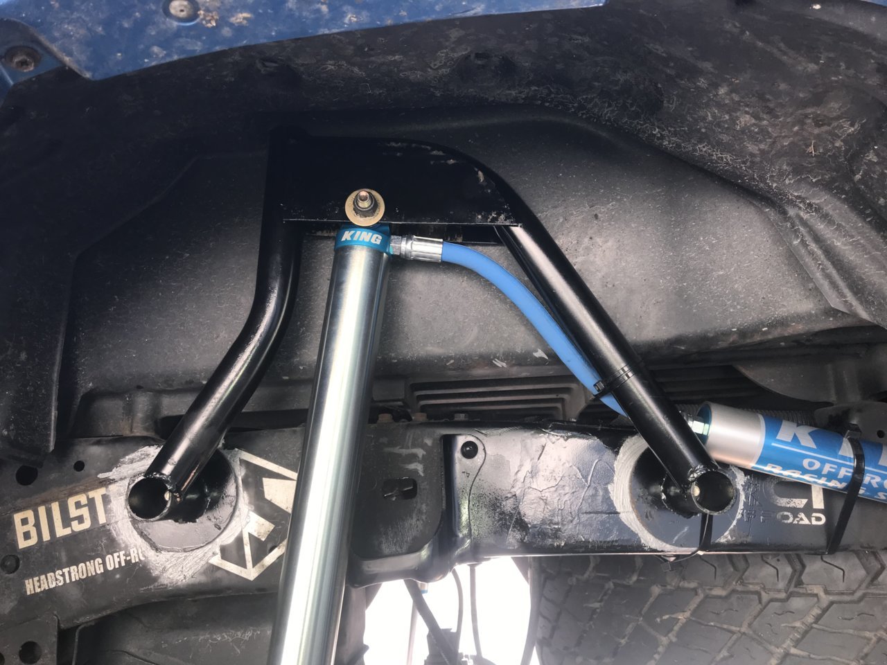

    I put King hydro bumps on mine, they had to be cut pretty far into the frame to clear a 2" shock. A 2.5" shock would be tight, but you should be able to fit it. This is a 2.5x2.5 bump can burned into the passenger side.

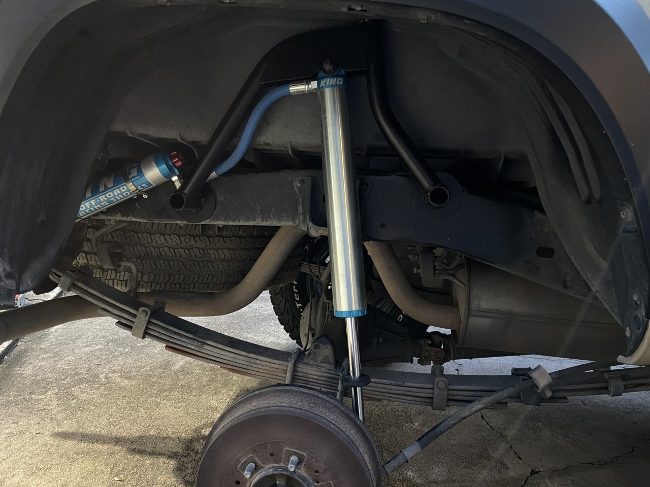

    This is a clever solution for a bolt on kit and I'm tempted to grab that last pre-order spot. I'm researching shocks to pair with this and would like to confirm that these shocks sound correct for this kit.
    Fox Racing
    P/N # 985-26-054
    Performance Series 2.0" Reservoir Smooth Body Shock
    Extended 30.450
    Compressed 18.350
    Travel 12.100
    Top Mount Eyelet Sleeve 0.506 ID x 0.625 OD x 1.48 TLG
    Bottom Mount Eyelet 0.506 ID x 0.625 OD x 1.48 TLG

    Yes those would work with this kit as would most 12-14” travel shocks with top and bottom eyelet mounts. You would just set up the lower tabs and hoop based on your measurements as recommended in the first post.

    Yes, those will work. That's the shock @TwistedTLM4 is using.
