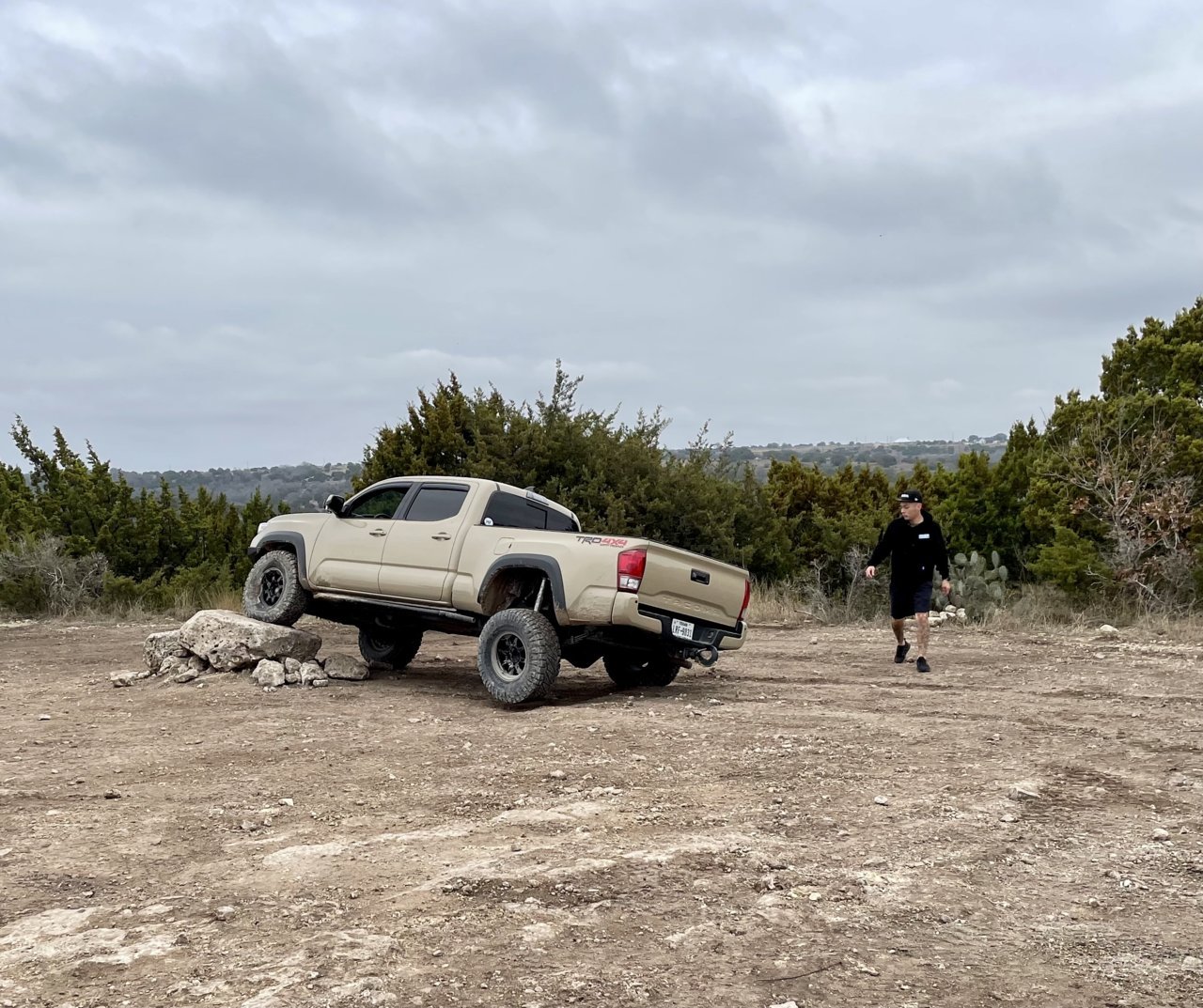

    Pushed the truck to the limits yesterday at Hidden Falls. Loving the new setup so far, still need a new leaf pack.
