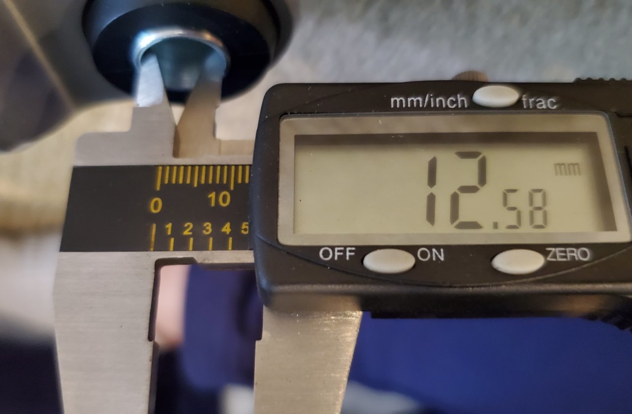

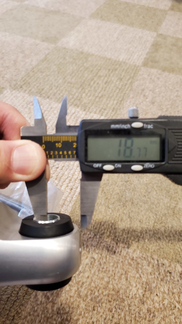

    Here's the measurement from center of bolt hole to top of shock body. I'm also assuming the bolt hole you're asking about is the "top/tube" one and not the shaft end.
    I only have calipers for accuracy. Sorry, no micrometer.
    18.77mm

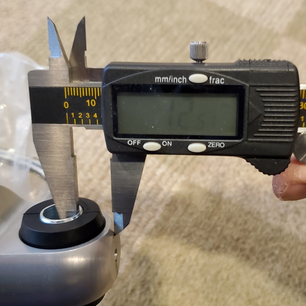

    As you can see, the 18.77 (18.8) was an eyeball measurement.
    I tried a 2nd way that was more precise and got a similar answer.
    1. Width of eyelet (12.58mm). 12.58/2 = 6.29mm
    2. Edge of eyelet to top of shock body = 12.51mm
    6.29mm + 12.51mm = 18.8mm
    Close to the original eyeball estimate.

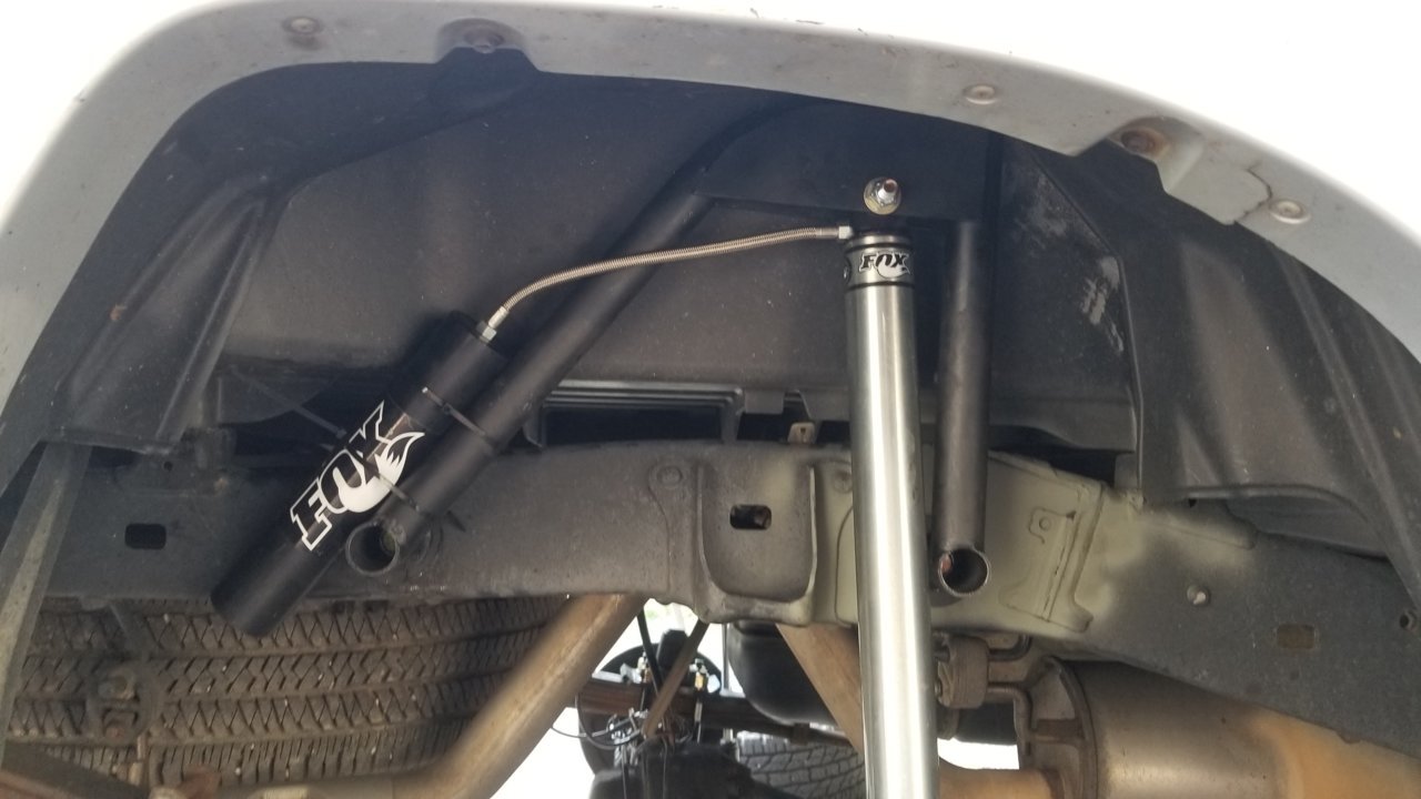

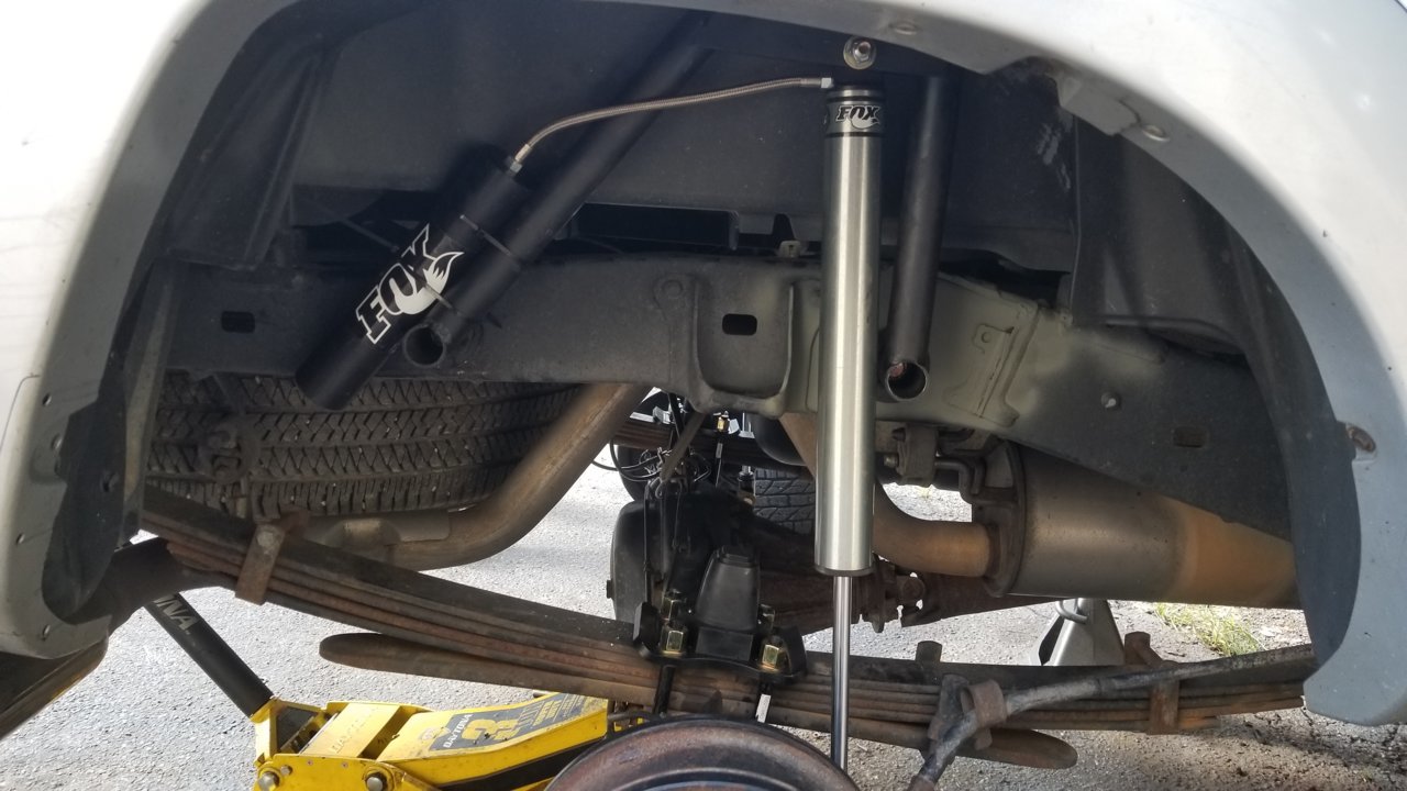

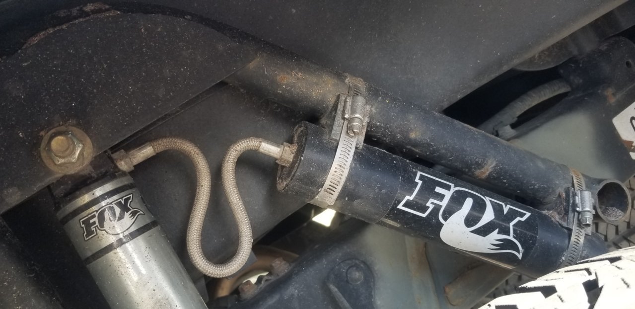

    @TwistedTLM4 you got a pic of your setup?
    Arcticelf[OP] likes this.
  15. Jan 29, 2021 at 10:17 AM
    #255
    TwistedTLM4
    TwistedTLM4 Unknown Member
    Jul 6, 2011
    #59396
    3,131
    Philadelphia, PA
    '05 DCSB TRD Sport
    WeatherTech Floor Mats, WeatherTech Bug Shield and Vent Visors, Audio Upgrade, RaamAudio RaamMat & Ensolite, Mr. Marv's Custom 10" Sub Enclosure, Pop N Lock Electronic Tailgate Lock, mattgecko's Bedlights, Demello Offroad Single Hoop Bumper, Marathon Seat Covers, Leer Topper, OME885s on 5100s, @Blackout14 HD Leaf Pack
    Here's what I currently have on my phone:
    Brian422[QUOTED] likes this.

    This is the first generation with a straight front leg. The ones you guys will get have the curved front leg to provide more room for the shock.
