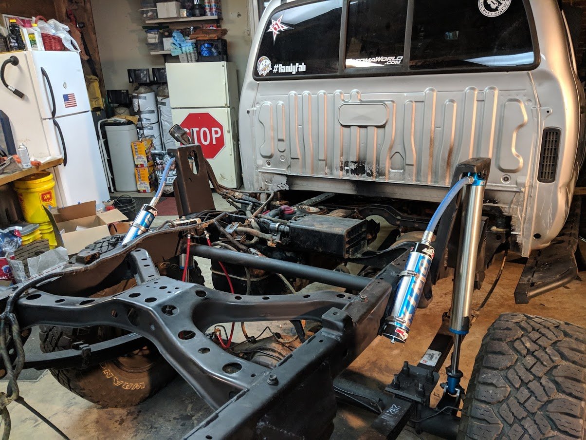

    @ovrlndkull where's your lower shock mount sit? Mine should be inline with the axle so if it hits the tab it the axle as well.

    Shit mine is way up. But I also raised my AG relocation an inch higher with my 1" BL. I also set them for 1/3 bump and 2/3 droop approx. with 14" kings. The lower eyelet is about 1/2"-1" above the top of the axle tube. With how I have it set I can go to a 16" shock and then be below the axle tube ~1" and gain 1" droop and 1" bump.
    I spent probably 3 months measuring, calculating, researching, and reading a bunch of different set ups since I was going 63s
    This is the best pic I can find right now I'll see if I can find a better one

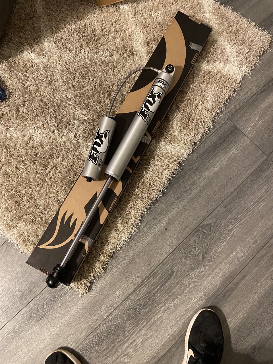

    You should read more thoroughly and completely. Sandwiched between what you pointed out was this....
    https://www.tacomaworld.com/threads...ctive-1-set-left.691150/page-13#post-25020187
    and this
    https://www.tacomaworld.com/threads...ctive-1-set-left.691150/page-13#post-25030829
    The fox shock that i have in my hand right now with p/n# 985-26-054 is a 12" shock with eyelet bushings on both ends. Looks completely correct to me and verified by people who know a lot more than me.

    Wrong picture in the description, my bad.

    Threw me for a loop too.
    Apparently no one selling the shock has noticed though. .
