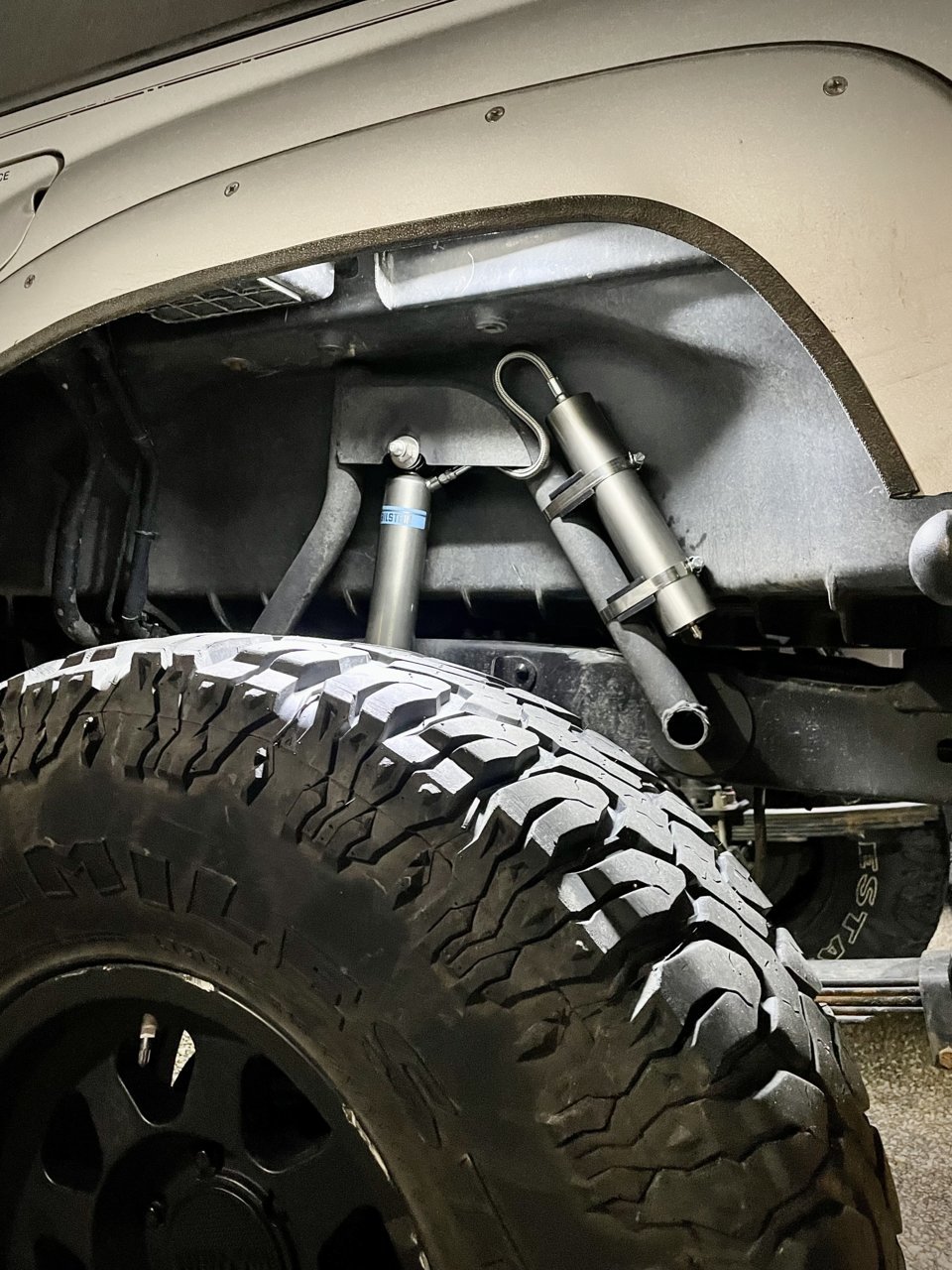

    Got the 7100s I was waiting on in. Worked out perfectly with mounting them to the tube. Love this relocate. Was able to cycle and set lower shock mounts for the 14” short bodies.

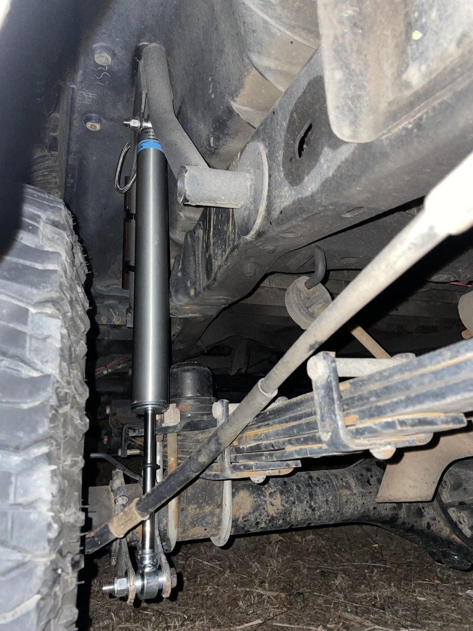

    I only have one not so great pic of it. They are still up and out of the way but the angle of the pic makes it seem low.
    This is also giving me about an inch of play if the bump were to fully fully compress.

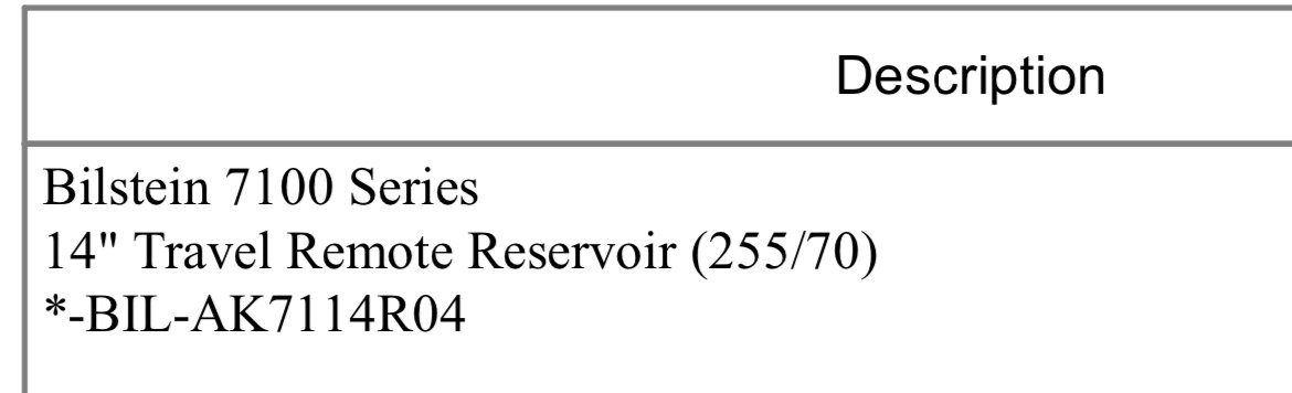

    That's impressive, they aren't kidding about a "short body". Did you already post that Bilstein part number?

    Yeah I’m really happy with how it all worked out. I did have to shim on each side of the misalignment spacers though as they are smaller than the typical shock.
    Part Number:

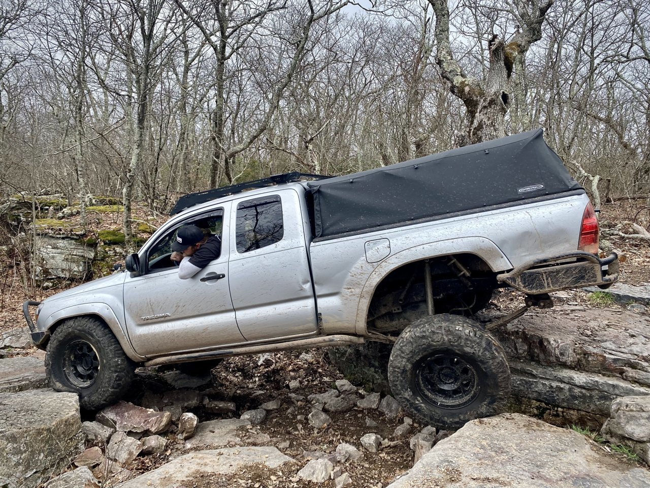

    I was able to get the 7100’s to fully droop out this past weekend. Very happy with how the rear end came out.
