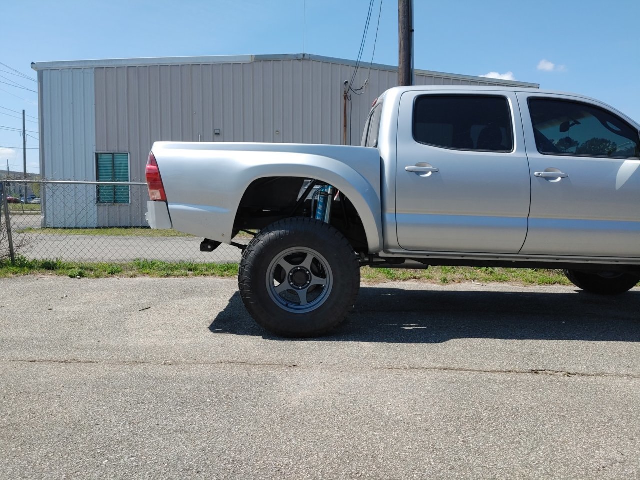

    Bolted on and welded.
    Had to redo the resi hoses but tons of room.
    Everything tested with pack broke down. Ideally need to rotate lower mounts down but at full bump compression I still see shaft.
    Def going to run a peice of dom between the hoops as well.

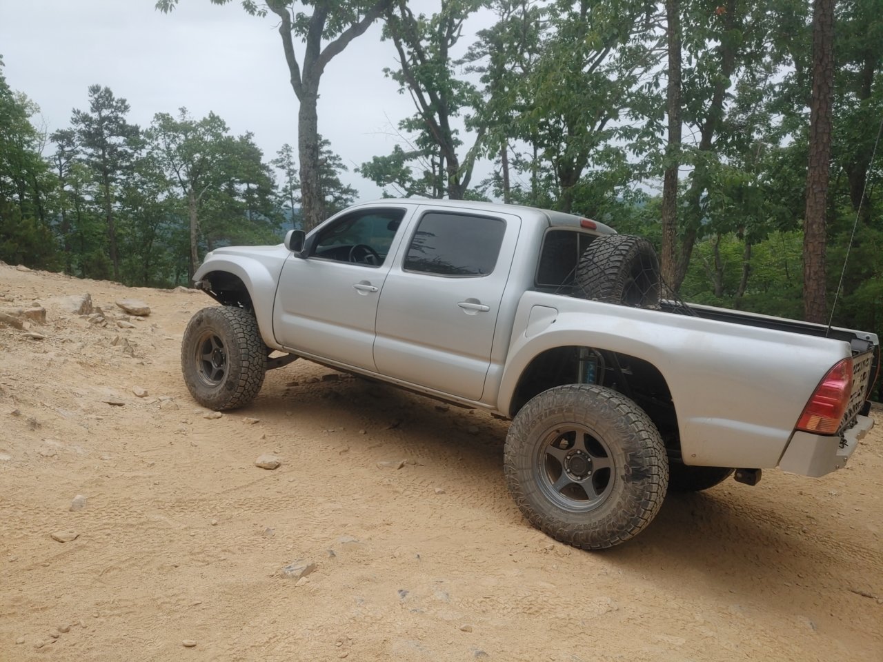

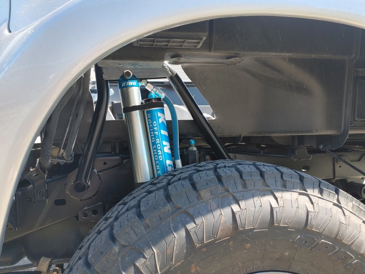

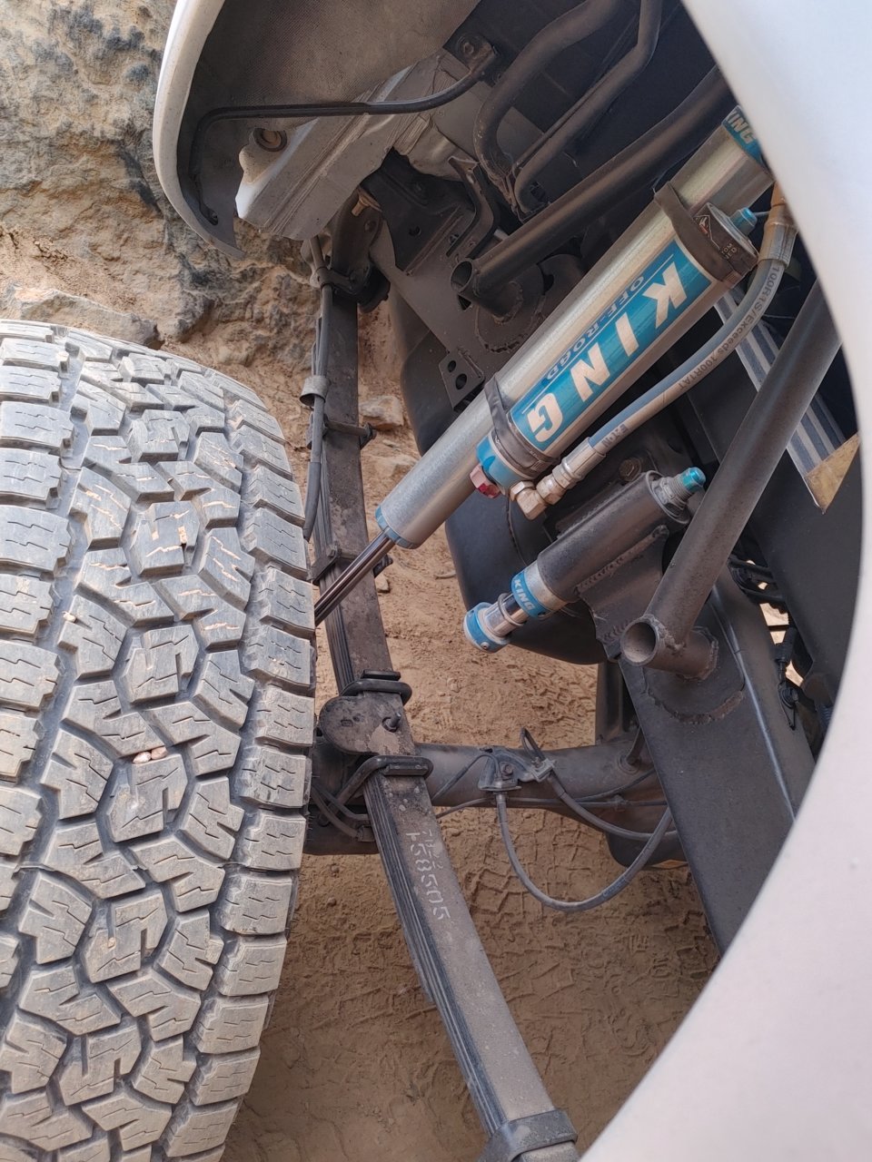

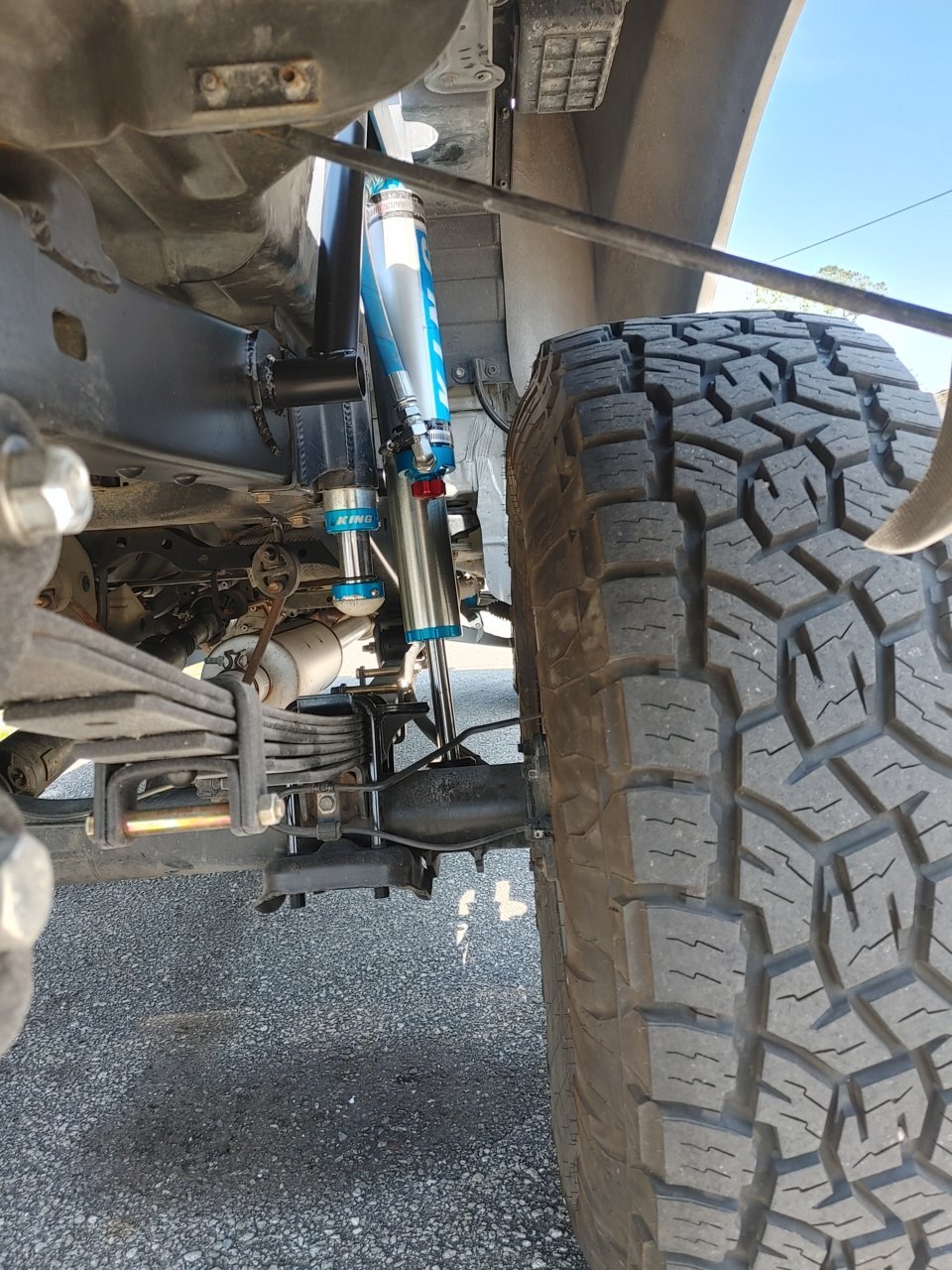

    Got a chance to strech it out a little this weekend, very happy with my rear setup for fast and slow stuff. I need to do a little more welding on them and possibly make a cross bar between the two.

    For go fast stuff the crossbar is a good idea. And easy to add once you've cut through tht bed.
    IvanhoeTaco[QUOTED] likes this.

    I was planning on making a piece of dom with threaded holes welded to the ends and use the upper shock bolt to hold it in. Not the strongest option but it would be removable.

    That will work. You really just need to hold the bar in so it can take the compression force.
