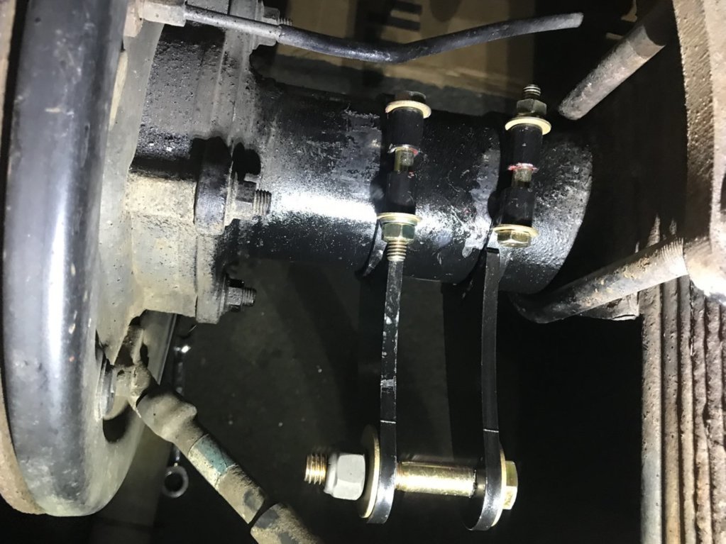

  13. Oct 24, 2020 at 4:45 AM
    #73
    Arcticelf
    Arcticelf [OP] Well-Known Member
    Jul 18, 2015
    #159735
    7,662
    Gladiator
    Here you go. Bottom 2 clamp bolts are below the axle tube.
    TireFire[QUOTED] and ovrlndkull like this.

  15. Oct 24, 2020 at 9:18 AM
    #75
    Glenn_R
    Glenn_R The Unicorn Turd Gen
    Nov 8, 2016
    #201874
    1,142
    Glenn
    17 Tacoma DCSB OR Inferno
    I know you probably didn't want the bolts on the bottom, but doing so would have increased clamp pressure during hard hits (shock being compressed). With them on the top hard hits are trying to open the clamp. I think. Great setup for people wanting a bolt on.
    Arcticelf[QUOTED][OP] likes this.
  16. Oct 24, 2020 at 9:22 AM
    #76
    hoarder23
    hoarder23 Truck fell over
    Aug 14, 2012
    #84787
    12,884
    Shay
    NJ
    15 Pyrite Mica DCSB Sport
    Scratches
    There are bolts on both the top and bottom.
    Arcticelf[OP] likes this.
