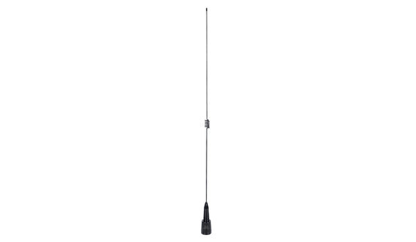

    Follow Up on all of this: hopefully helpful to others getting into gmrs, lots to learn and test.
    - I tested 5 or 6 options back to back. I tested with a mag mount on the center of roof with both a 6db, a 3db, and a 1/4 wave antenna. I tested the same antennas on my corner mount in the original post at the beginning. I did slightly improve my range with the mag mount on the roof, but very minimal gain by doing this. If anything, just an increase in clarity.
    - The last option was to try a Laird b4505cns antenna that requires no ground plane. I put this on the back corner mount. Best reception and transmission of all the different set ups. Super impressed with it. I can hit repeaters at 35mi and 65 mi away.
    - Heres a link to the antenna. https://www.solidsignal.com/laird-4...QqbLF9QrBltctB6KZFZtTsj9-dV8_a-gaAjfUEALw_wcB
    -Also comes in an all black version (bb4505cns).

    Thanks for sharing and testing. I have almost no reason for a radio as I have no one I want to talk to, but for some reason I still want one. The Midland MTX275 seems a great option, but I'm struggling to figure out an antenna option. The stubby ghost antenna is a great size, but I'm not sure it has good range. I don't want a 32" antenna on my roof or rack so maybe the Victory hood mount would work.
    Ideally, I'd like to be able to take the antenna off for DD. What NMO mount did you get and is it easy to remove the antenna and maybe cap the mount to keep water/dust out?

    That’s funny man, I also don’t really have a great reason for the radio but it’s pretty cool lol. Kinda fun listening to the local repeaters. Also figure if I can offroad with a group it will be nice. I have a radioddity db20g which is really similar to the mxt275. It’s been sweet so far.
    So the 3db antenna I described in the post is the midland ghost. I was super impressed with it. Best results were with a magnet mount on the roof. The antenna I’m going to use now is the 32” laird with a little bracket I made for the back corner. It’s a little better range than the ghost but I wouldn’t say it’s like twice as good anything.

    Man that’s tough. I’d say it depends where you have it mounted. If it’s in the center of your roof or hood then no way. But if you’re like me and don’t have a great ground plane then yeah might be worth it. Even with a bad ground plane I got pretty good results with the mxta26. But the laird was a step up with my set up. You can do what I did and buy it on Amazon then return it if you don’t like it haha

    This is the same one you're talking about, just in all black, right?
    https://www.amazon.com/Connectivity...d=1650489644&sprefix=bb4505cns,aps,124&sr=8-1
    I may give it a try...my antenna is mounted to the side of my roof rack in the front passenger corner.

    I think that one is the non spring version. Here is the one I got on Amazon. Now returning and ordered the all black one from a retailer since Amazon doesn’t have it. https://www.amazon.com/gp/aw/d/B00794WID2?ref=ppx_pop_mob_b_asin_title
