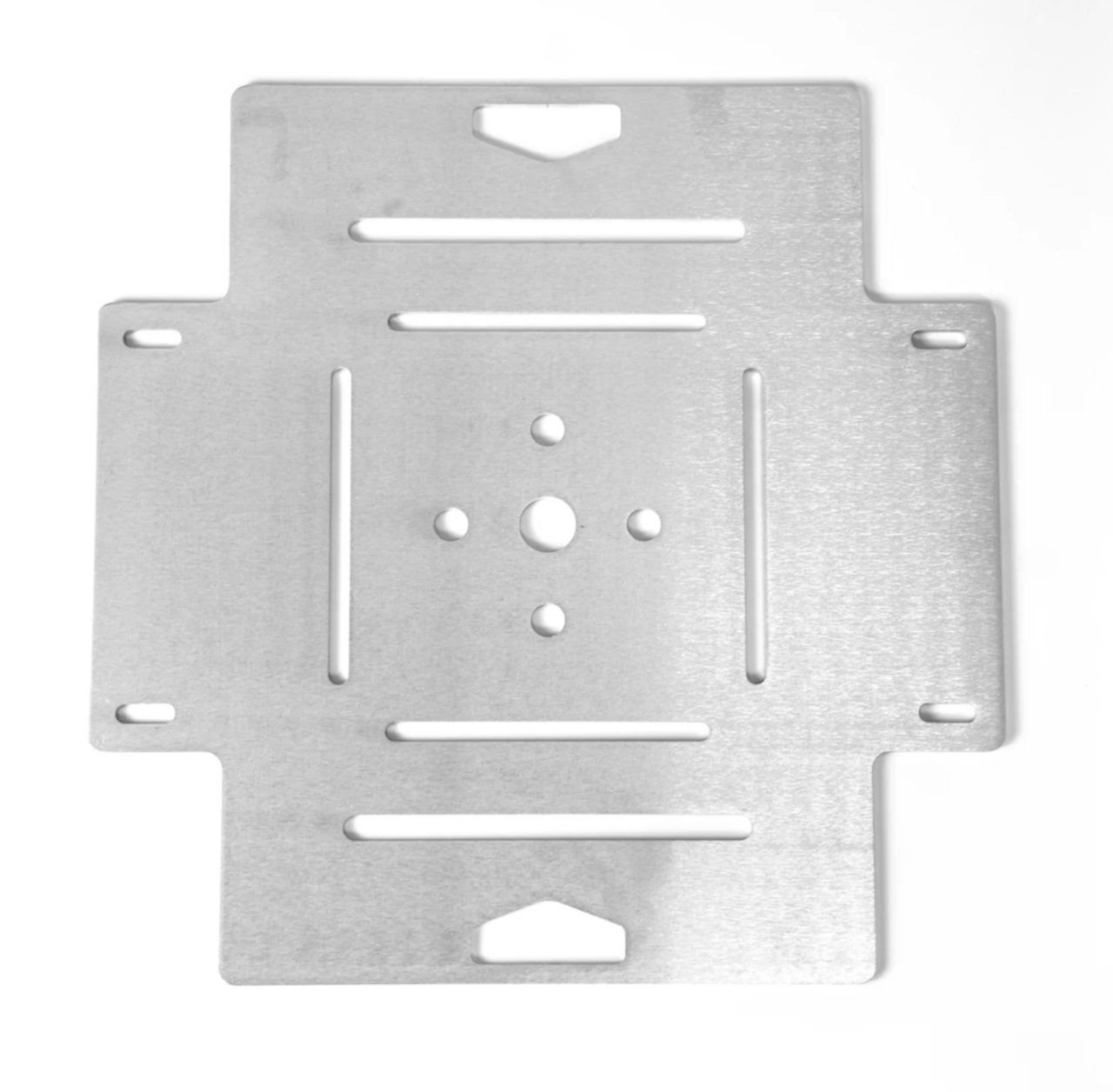

    So for the Ghost antenna or any other needing a ground plane, would this 12" aluminum plate work? I just installed a Sherpa Crows Nest rack on my topper and I was thinking I could mount a short antenna on this plate near the front of the topper (close to the cab) so it would be mostly out of the way.
