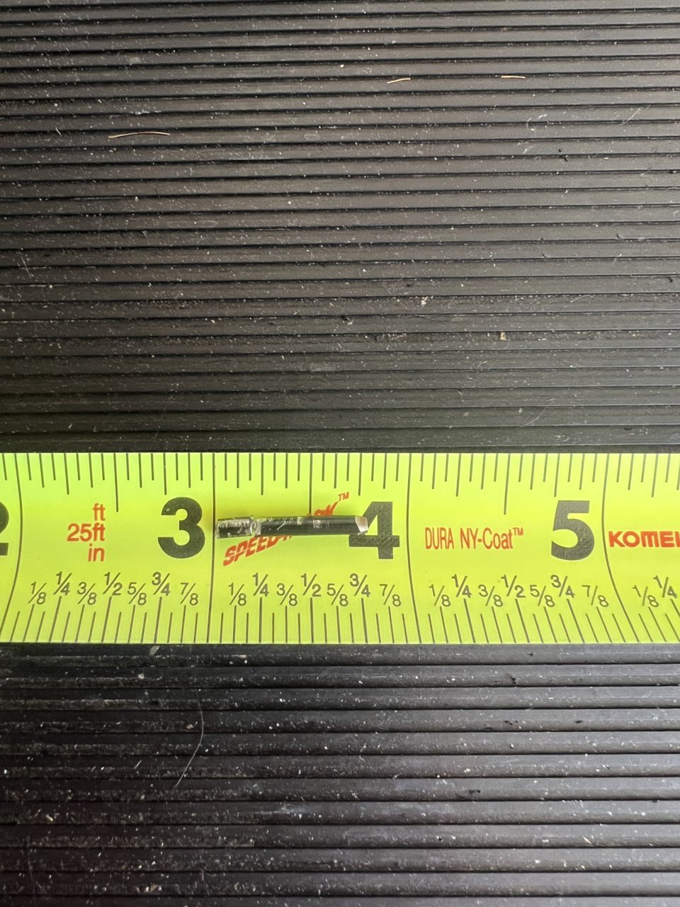

    I just bought a swr meter on Amazon so not sure about cb vs GMRS. I cut off about this much. About 3/4 of an inch and I was dead on.
