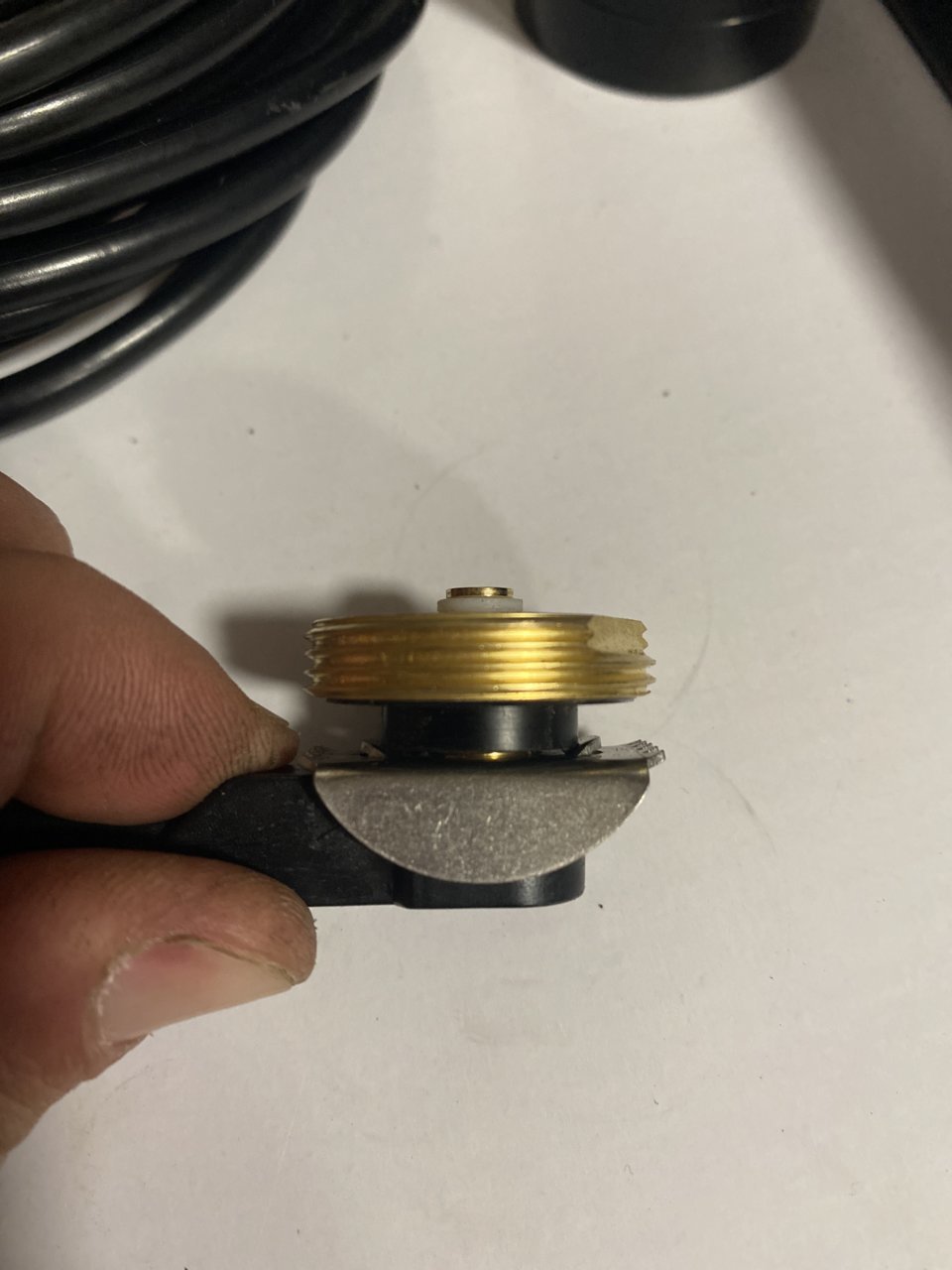

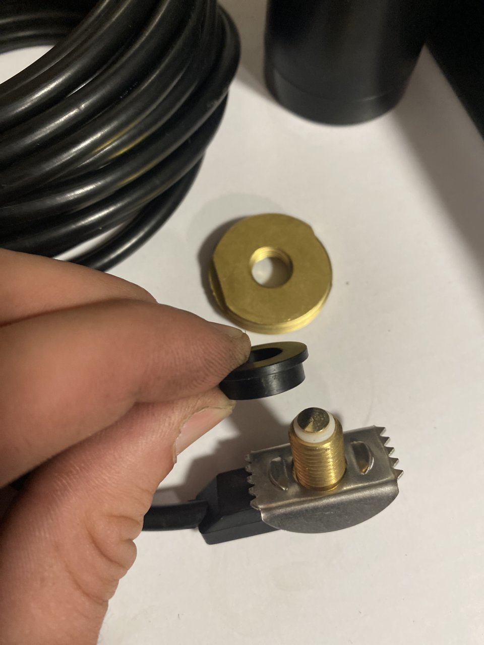

    Anybody on here mount the Midland NMO in their roof? I’m curious why it has a nylon insert around the post that I don’t see on the Larson NMO mount. They’re different diameters, so I’m not about to drill a hole until I figure out which one I need to use.

    I believe the washer allows you to use a 3/4” hole or 3/8” hole without the washer. At least that’s what a number of websites that sell it say.

    With the washer, it looks like a 5/8” hole and without it, the center mast of the mount is too tall and prevents the antenna from screwing down all the way

    The washer is supposed to be with the wider end on the bottom close to the mount. You seem to have it with the wide part on top. The wider part is for the 3/4” hole.

    Are you sure? It came installed with the wide end on the top, and it fits perfectly into the bottom of the brass top piece

    I got it figured out. I had a thick mount NMO from Midland and it was not going to work in the roof. I went to a local store and got a normal NMO and got it all installed in the roof.
