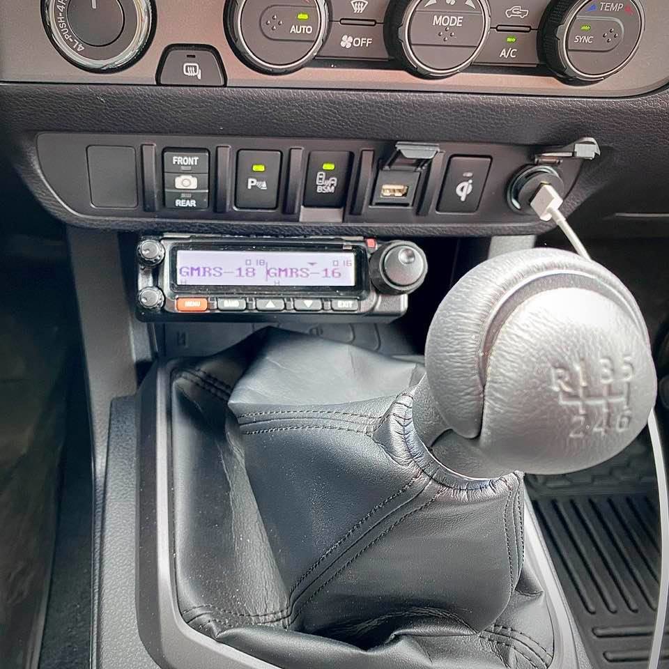

    well, finally got it all hooked up. thanks for all the input everyone!
