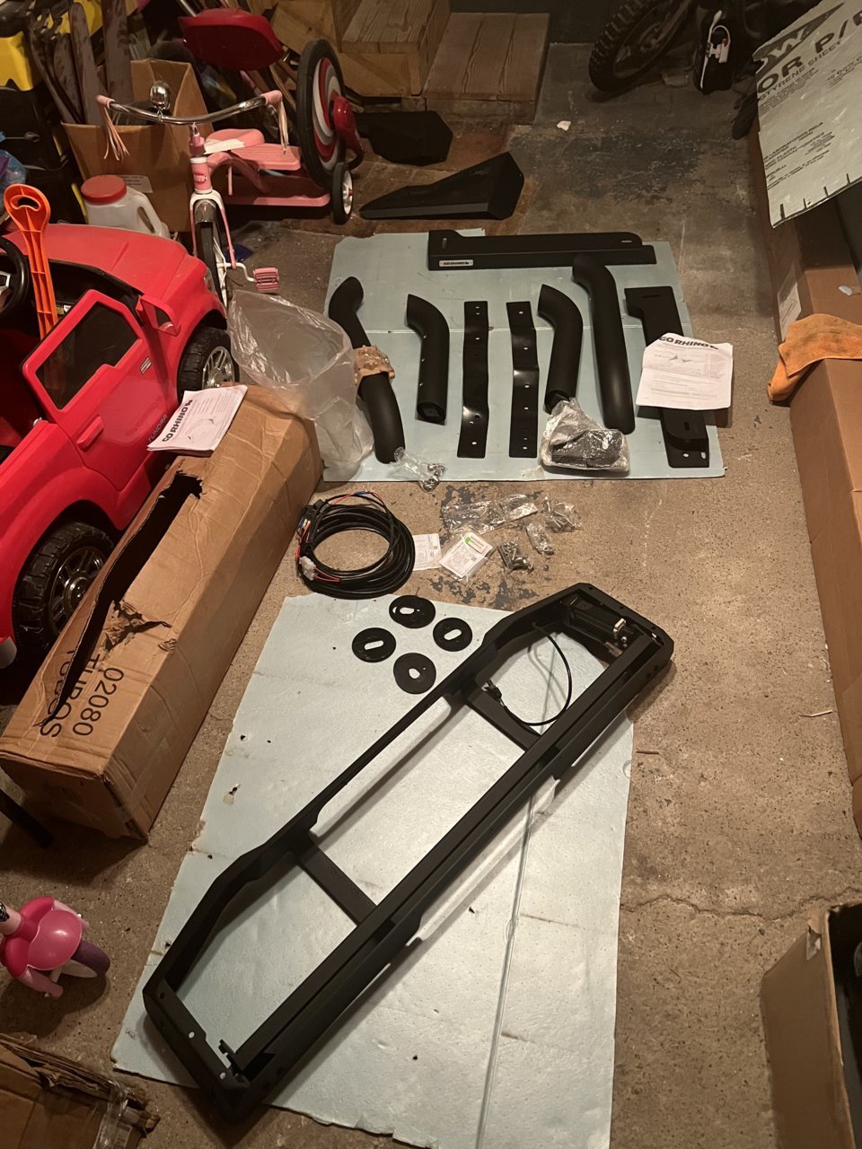

    I just picked one of these up for $250 and then realized you need to drill the bed to install it (I saw a good deal and jumped on it without doing any research).
    I have a TruXedo TruXport tonneau cover currently installed.
    Since the tonneau cover rails will sit inside the sports bar channels, would the clamps that hold the tonneau cover in place be sufficient instead of drilling the bed, or would this be a bit too sketchy?

    • Where did you find a Go Rhino Sport Bar 2.0 for $250?
    • I'm guessing depending on the tonneau clamps to hold the sport bar on would be beyond unsafe.

    It was through a local auction site in my area. I was shocked to find all the pieces were present and the hardware was unopened. Only issue was 2 scratches on one of the parts which I can live with.
