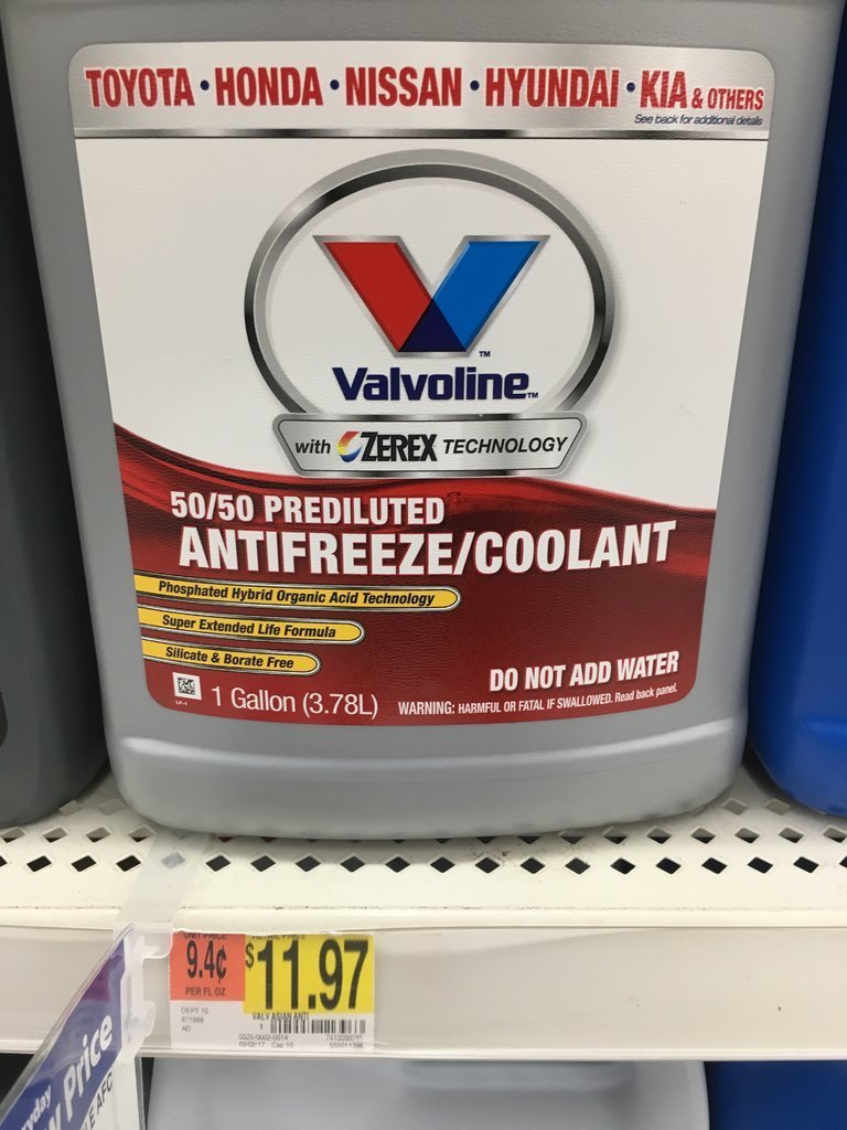

    5100's ALL WAY AROUND, 885X COILS, DRIVER SIDE LEAN SPACER, ICON PROGRESSIVE AAL W/O OVERLOAD, 265/75/16 KENDA KLEVER M/T. 1 1/4 SPIDERTRAC WHEEL SPACERS, GEN 1 TRD COLD AIR INTAKE, STOCK MUFFLER WITH CHOPPED TURNDOWN, 5% TINT OVER FACTORY, DEBADGED, TOYOTA RUBBER BED MAT, WEATHERTECH MATS,UWS TOOLBOX, UNDERCOVER SE, LOCKER MOD, REAR BUMPER, PIONEER DOUBLE DIN WITH PARKING BREAK OVER RIDE, CUSTOM OIL CATCH CAN, FULL LED INTERIOR, ARB BUMPER REPLACEMENT. COVERKING SEAT COVERS. MORIMOTO H1 MINI COVERSION WITH MINI GATLIN GUN SHROUDS AND 5000K MORIMOTO BULBS. TRAILER PLUG RELOCTED TO BUMPER. 20 INCH LED LIGHTBAR MOUNTED BEHIND CUSTOM PAINTED GRILL. STUBBY ATNENNA
    This has worked well in my Tacoma and tundra for many years.481CDF41-31C1-4858-9028-27DBF1BD292E.jpg
    just done a flush with it in my tundra 2 months ago.

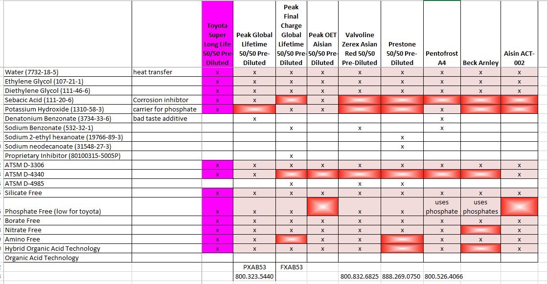

    I've compared the ingredients that I could find on Toyota SLLC to other aftermarket brands and the only one I found that has what appears to be everything the same but one ingredient is PEAK Global Lifetime 50/50. You would think the AISIN would match exactly as they make it for Toyota and maybe it does, haven't made the effort to call them and ask.
    Anyway, this is what I could find.

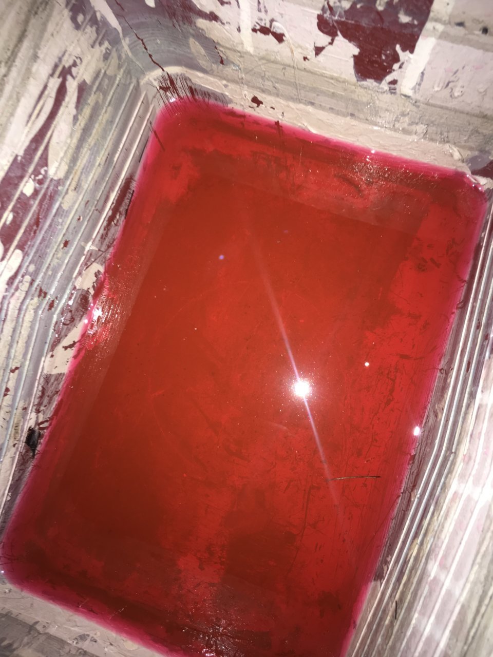

    Here is what it looks like after 12 years
    Rsmallw2 and Rambo MARINE Recon like this.
