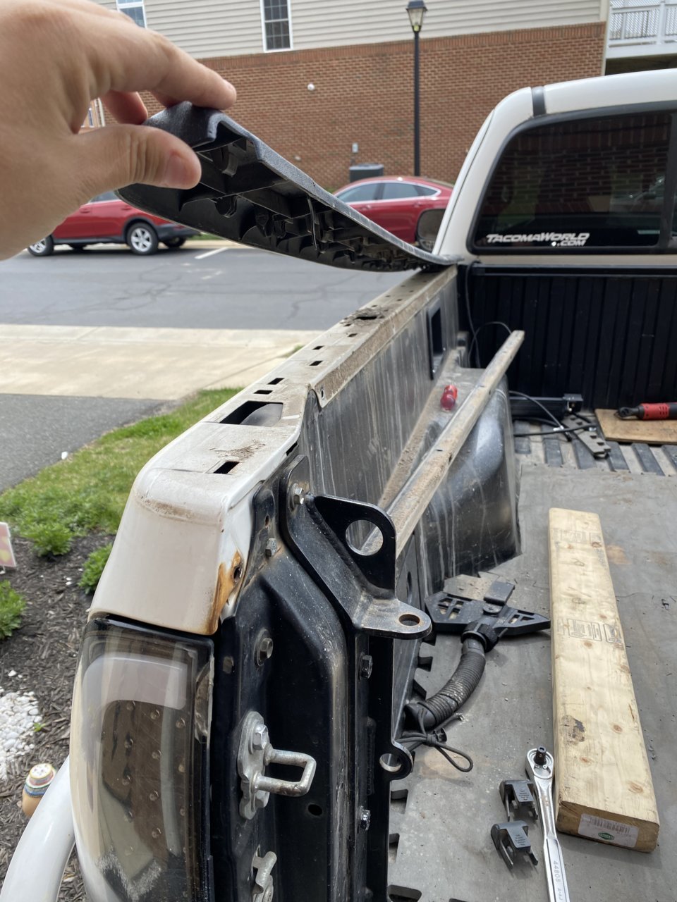

    I have the total control bed stiffiners installed on mine bit pricey but they work great. I bought my truck used and the camper already put a gap where the tailgate is but the stiffners did the job and fixed the gap
    I read on here to remove bed rail caps completely (if you have 2nd gen) because it could leak underneath

    Nice! glad they fixed your problem! If you remove you bed rails the back camper latch wont close completely and could fuck your install. They are designed around the height of your rails. But I believe it was @fatfurious2 removed his rails and taped off under them and did the kb voodoo rails. Still hear mixed reviews if you can use them or not.

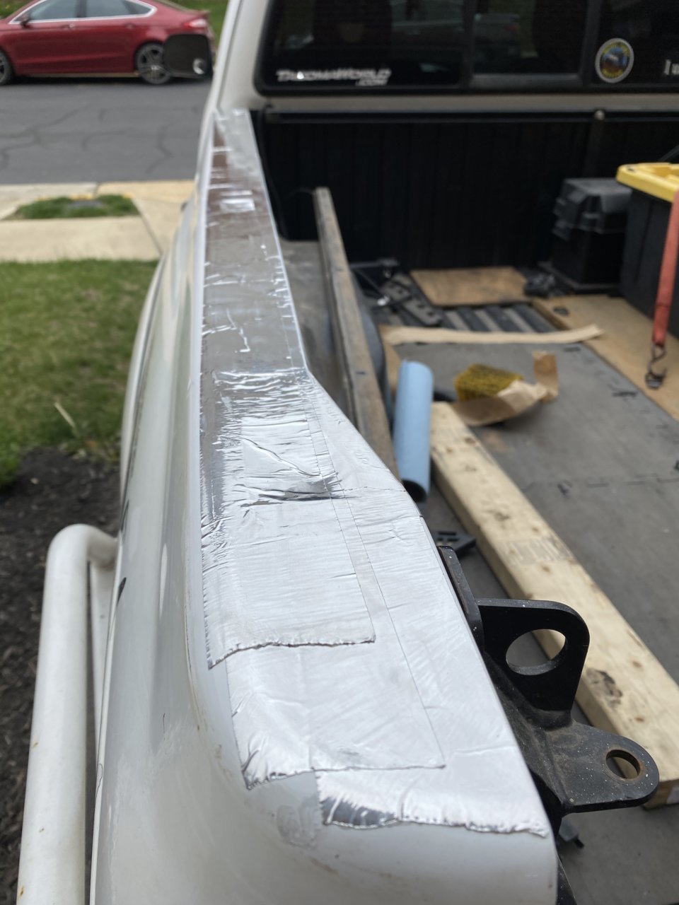

    I picked this stuff up. Pulled up the bed cap rails. cleaned, layed this down to be sticky both sides and put back on the caps and just pushed the clips through. Same for the T-tracks and front rail. Pulled, put this under and reinstalled.
    https://smile.amazon.com/dp/B004IZCRGS?ref=ppx_yo2ov_dt_b_product_details
    Edit: its very very sticky. Put in fridge to get it cold and stiffer and a tad easier to work with.

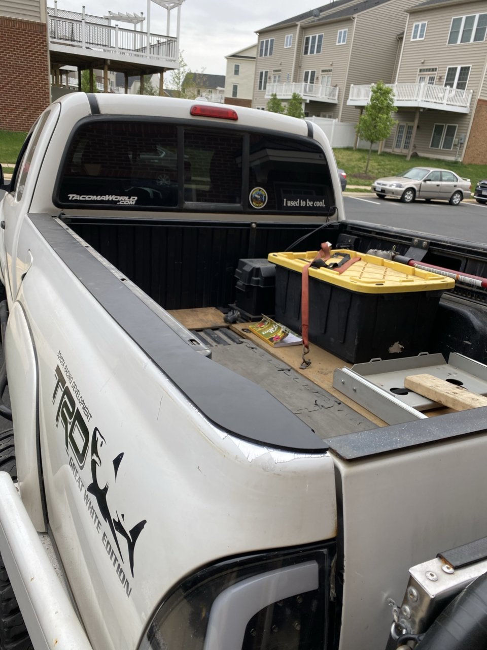

    yes I did kbvoodoo rails on my 2nd gen. They say to NOT do it, but if you have an 05-11 with the low cab antenna or no antenna, then the V2 will fit. I went back and forth many times in my research, and turns out it does. But it also messes with your tailgate cap. I havent redone mine yet. I had a Mobtown tailgate cap and reinforcement panel (which have both been removed. I made my own panel, but havent put the tailgate cap back on yet because it needs more clearance)

    Do you have the stubby antenna? I reached out to a few people from the Pro page, a year ago in August they were in the 1600s. If you try to find my truck, its probably way back, as Im build #1670.
    But yea, they say no, but like me, a couple people have done it with kbvoodoo or Relentlessfab rails, which are hard to get. Just tell them that you dont have the stock bed rails anymore. Also, maybe bring some beer for the install guys.
    Or if you're passing near Virginia, ill give you my stock bed rail caps.

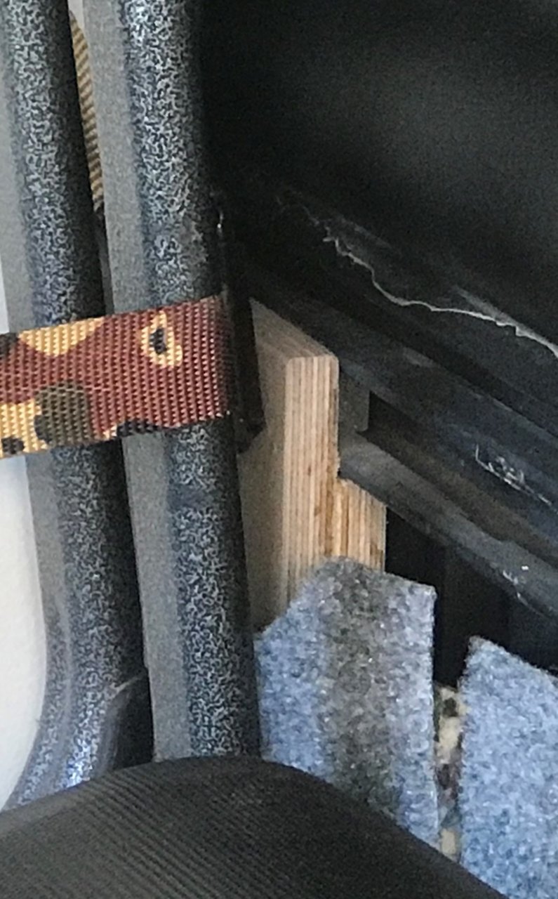

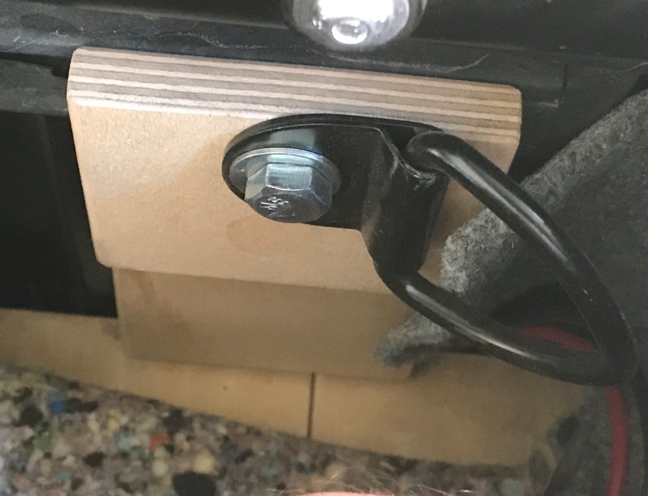

    I have my drawers installed without a base plate, I cut a piece of plywood and have it jammed between the front mounting rail and the top of the drawers then also bolted to the rail so it doesn't fall out. Also have a tie down point so it serves a dual purpose. I didn't want to lose the height of using a base plate. SO i have extended the drawers out fully loaded and put my weight on it, there is no lifting of the front after installing the plywood blocks. I can load a picture if anyone wants.
