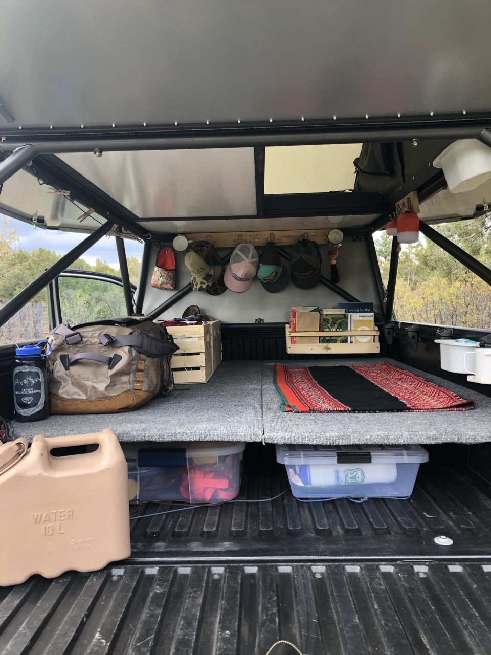

    How did you you join the deck pieces and support it?

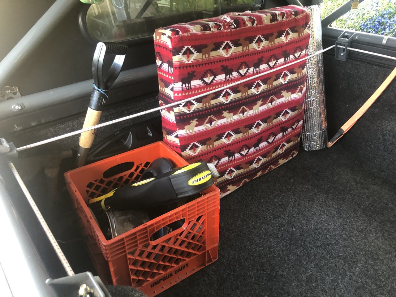

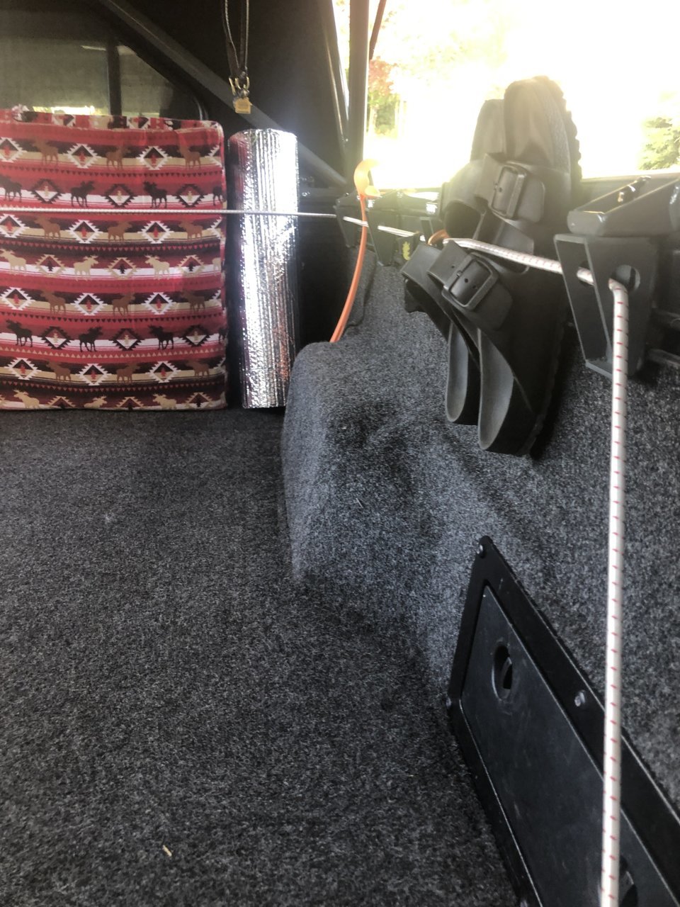

    This one is real simple, but I use it all the time and have forgotten the GFC didn’t come this way.
    It’s just a length of shock cord run around the perimeter of the bed, routed through the GFC mounts and tied to the tie downs at either end.
    It does daily duty holding the bed square and rear window insulation against the cab, but on a trip it holds a million things: shoes, coats, water bottles, etc. 5D4C70F6-358F-48B0-8A3F-957892E4E221.jpg7ED2394B-C67B-4396-A8EB-AAEAD2275EF3.jpg

    Saying that it keeps the bed square is a stretch, but it certainly has a lot of utility

    Ha! I was referring to the leftover square from the GFC bed, but in hindsight I could have made that a bit more obvious.

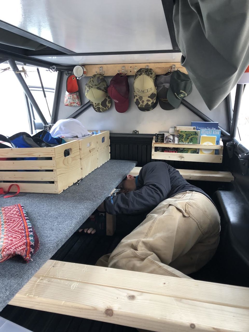

    Here's a picture of the underside of the platform. Those 2x4's just rest in the bed of the truck, on top of the wheel wells.

    What's that support with the metal piece you have your hand on?

    2x4 screwed into the bottom of the platform via joist bracket, for a little extra support when I'm standing right in the middle of the plywood!

    I have an F150 with GFC due maybe in August. Trying to figure out how to set up bed like yours as I don't have the same set up on wheel wells. Thanks for info.
