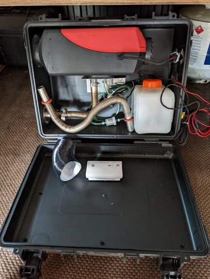

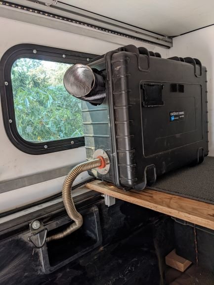

    [QUOTE="fatfurious2, post: Planning on routing the ducting into the bed through the cubby above the wheel well[/QUOTE]
    I think that might prove to be tougher, more of a hassle, than you think. I went the other route and keep the heater inside the camper and exhaust the diesel out through the cubby. You do get heater fan and pump noise inside, but I don't find it bothersome.
    [​IMG][​IMG]
    fatfurious2 likes this.

    I found the supplied fuel container to be a pain. The geometry is simply hard to work with. I went with the one below. Fits inside the case and is mounted to a bracket that allows you to easily pull it out to add fuel. I'm not sure what the extra muffin does for you. There is nothing to vent from inside the case-except heat which has not been a problem with a passive approach. I cut a hole in front of the heater's fresh air intake port, and another below for ventilation I route control/power wires through the second hole. FWIW I have used the 2kW heater at 20F without issue. I turn it on and off as needed ( a few time a night) and burn approximately 1 L fuel a night.

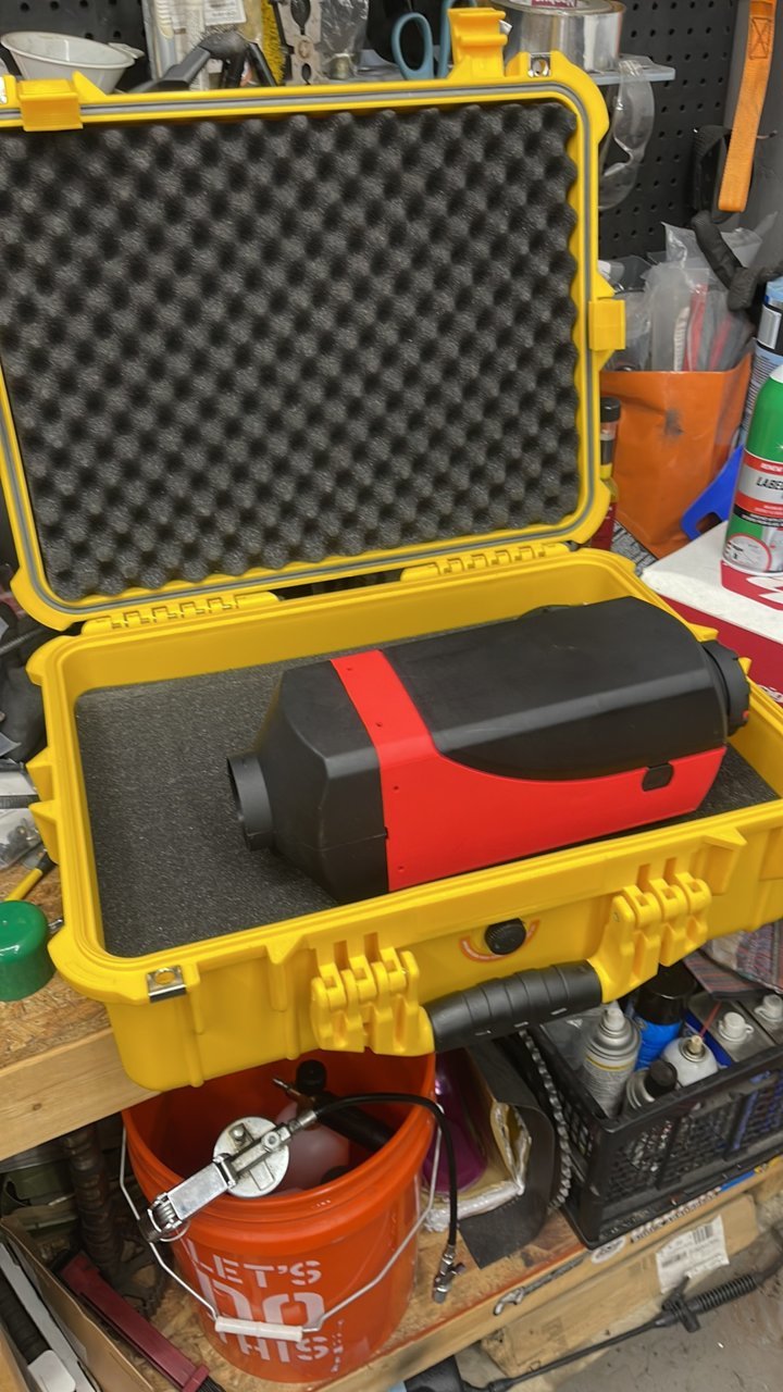

    Starting here
    medicfung likes this.

    Yellow for diesel... very clever.
    fatfurious2[QUOTED] likes this.

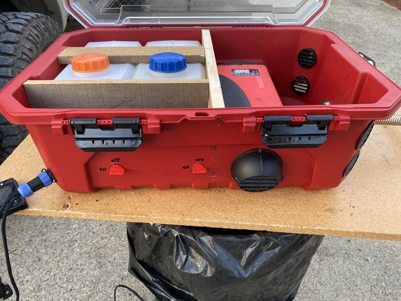

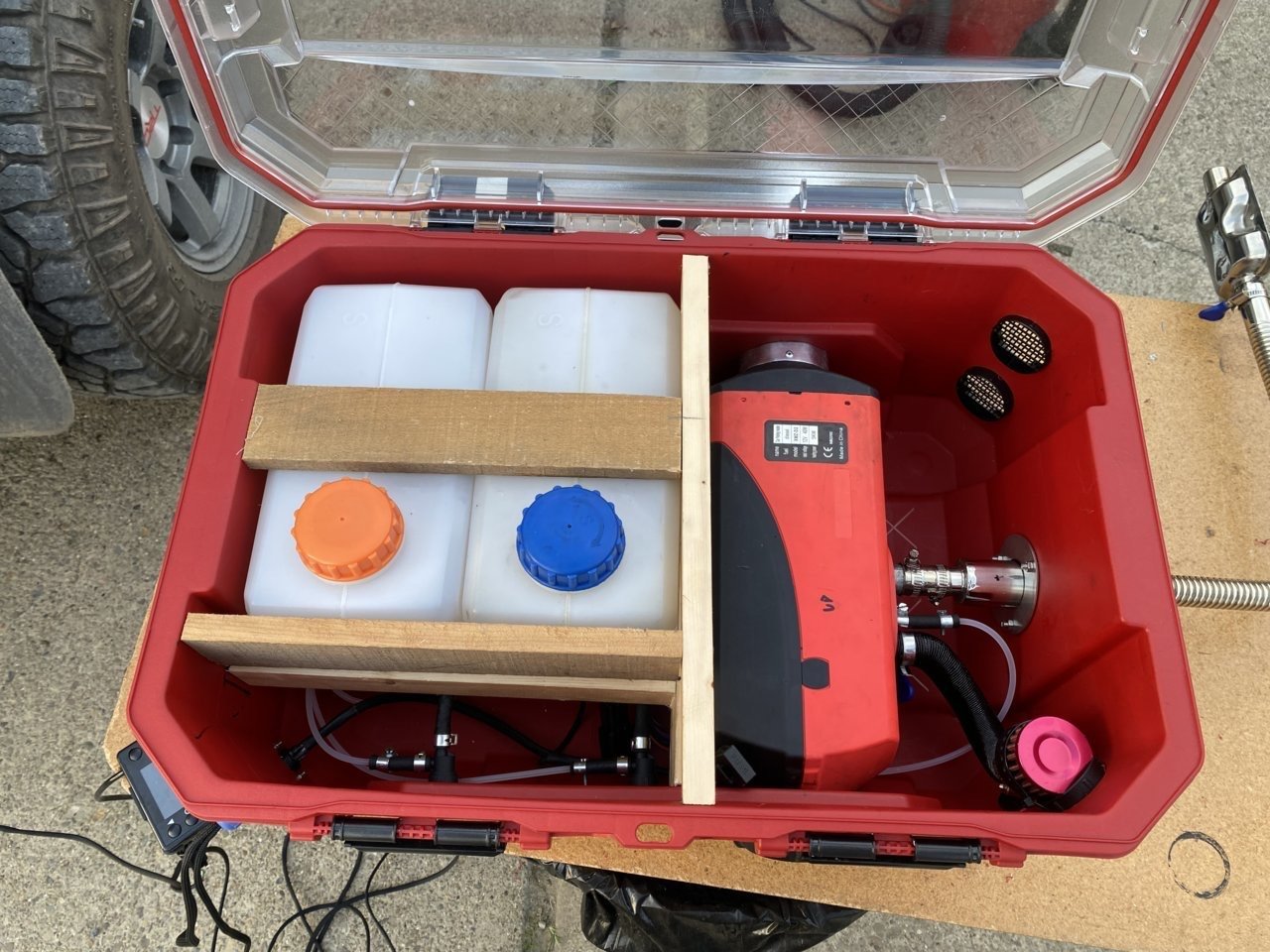

    I found stuffing 2 5L tanks in build to be the easiest.
    Each tank has a shut off then they run into a T then in to the heater.

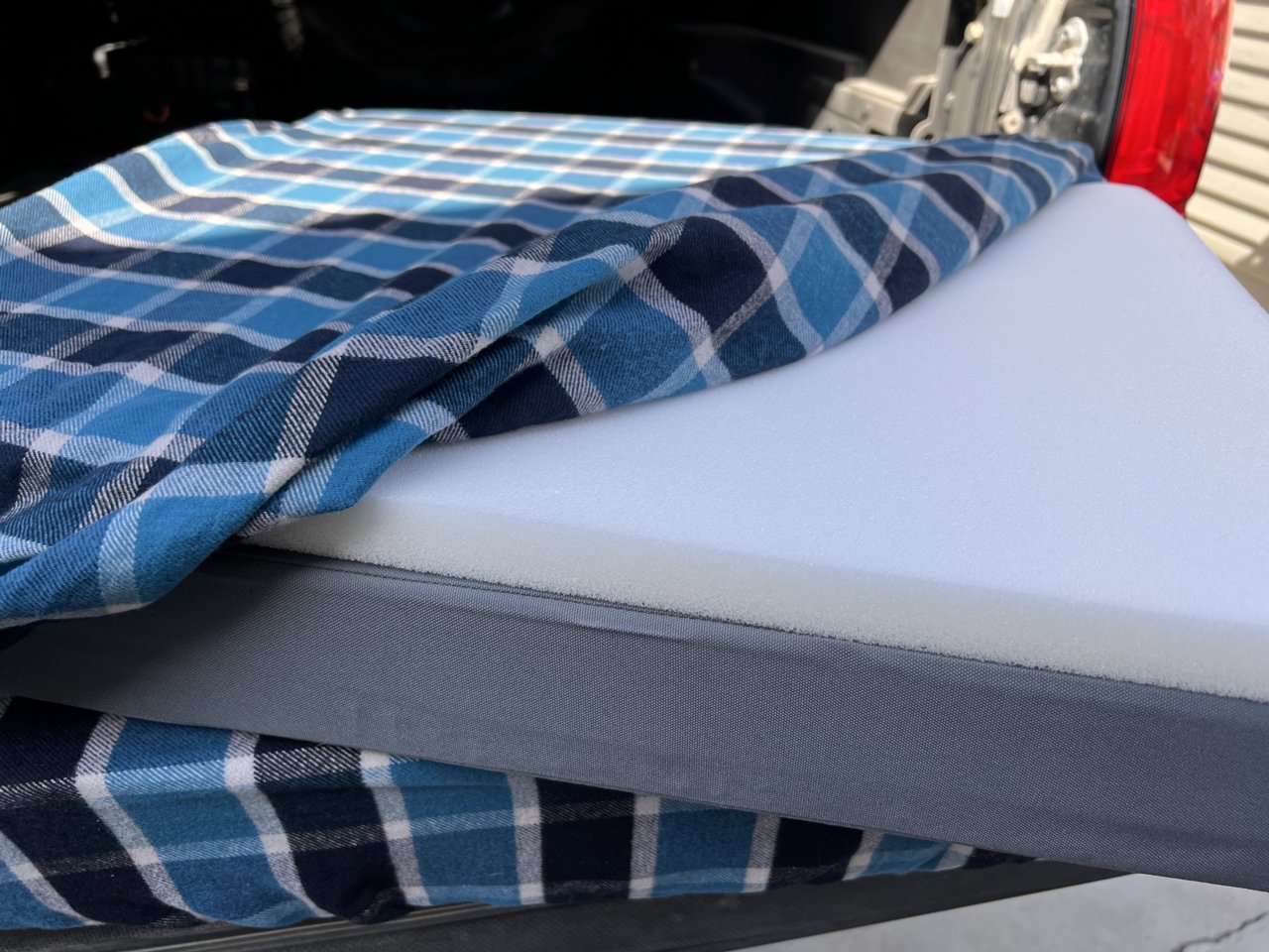

    Does the camper still close with the mattress topper installed?
    i assume there are 4 foam toppers that come with the kit and then sheets to fit each section of bedding?
  19. Oct 18, 2022 at 9:18 AM
    #2199
    d.shaw
    d.shaw Well-Known Member
    Aug 15, 2016
    #194653
    1,103
    2012 Silver TRD-OR
    Vagabond Drifter, King 2.5 coilovers, King 2.5 rear, Pelfreybilt front / rear bumpers and skids, rock sliders, Safari snorkel, Smitybilt winch, Baja designs 20in, wide cornering spots, S2 rear. Deaver expedition series stage 3 rear leaf.
    we are having no problem closing it with the topper, it is of course a bit tighter, we purchased the overland softwood sheet set too although I think the GFC ones would also fit (albeit tighter) Yes 4 sections to place on top of the factory mattress pieces
    definitely money well spent - for sure

    It definitely fits but it's not as tight in the middle (halfway between the front hinge and rear latches). It looks like the aluminum bows just slightly and exposes just a bit more of the rubber weather seal. Nothing to be concerned about, but it's noticeable if you're looking. <will post photos in a bit>
