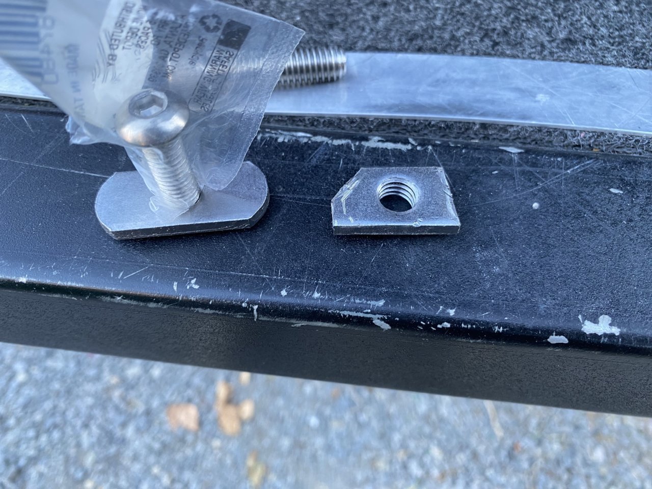

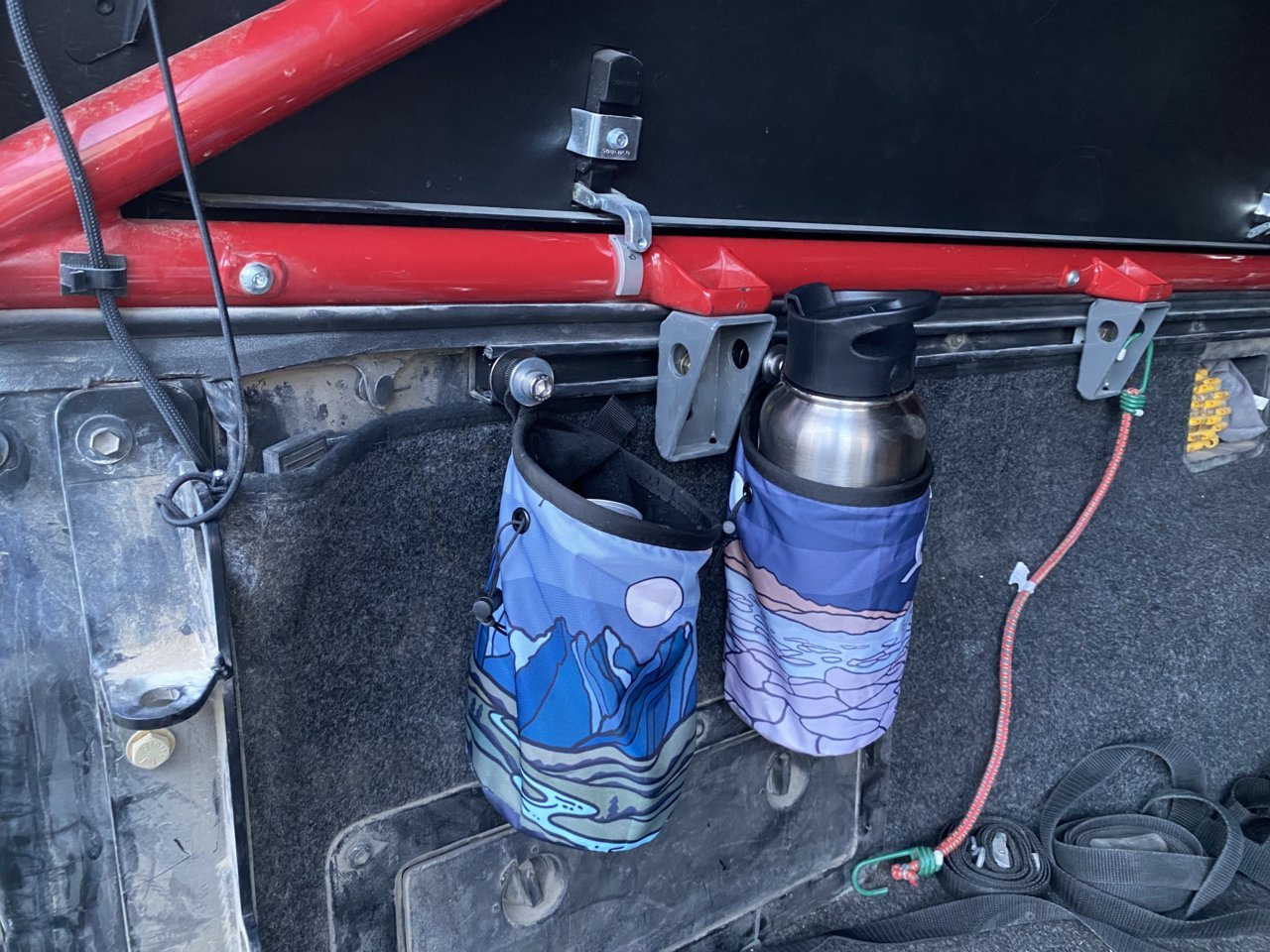

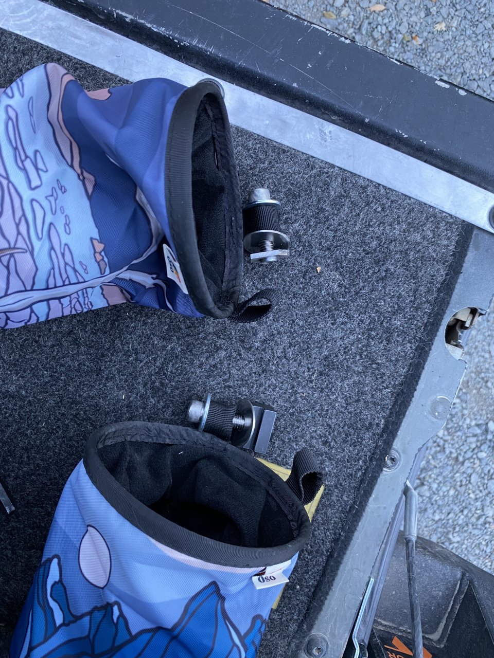

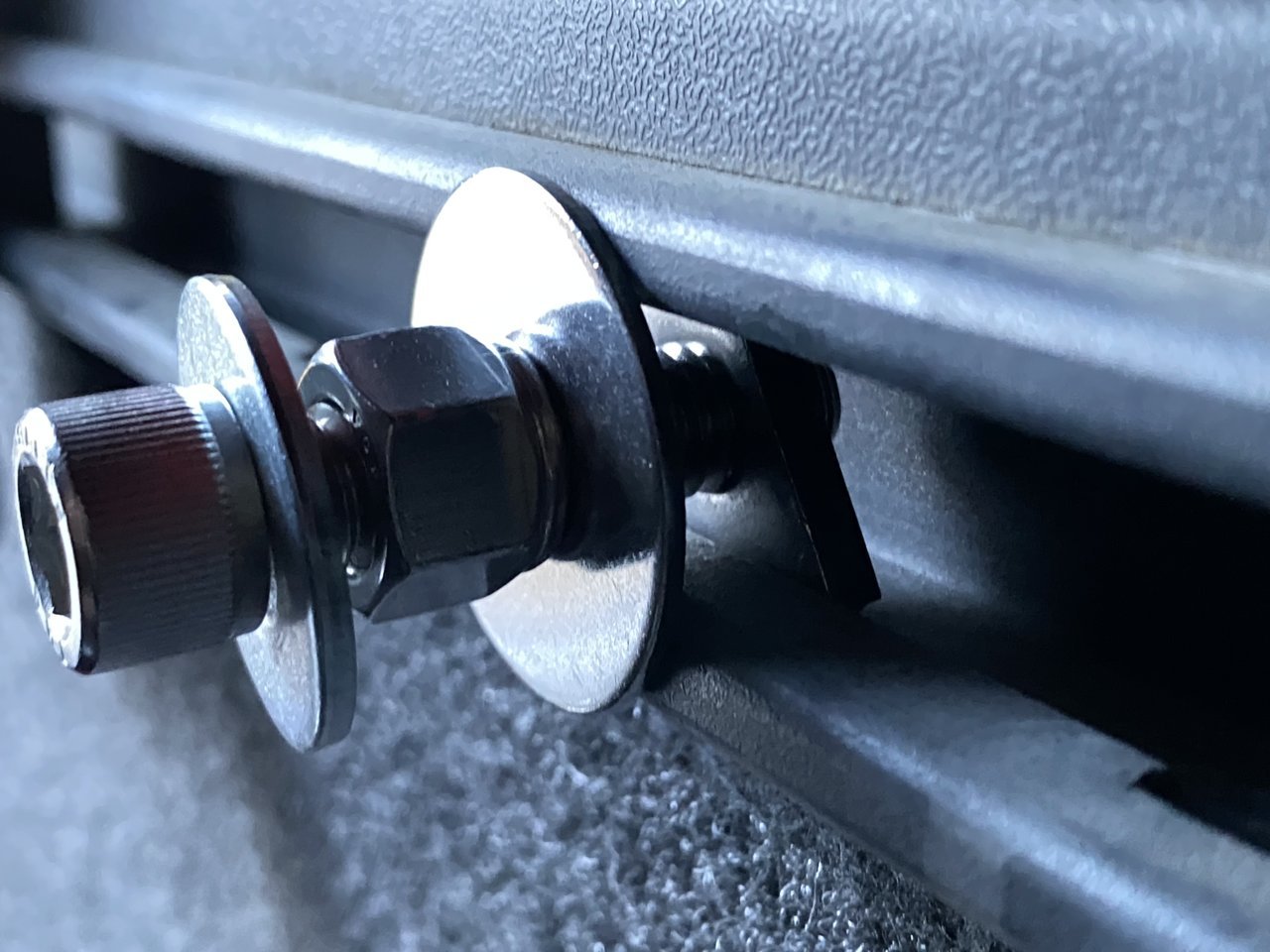

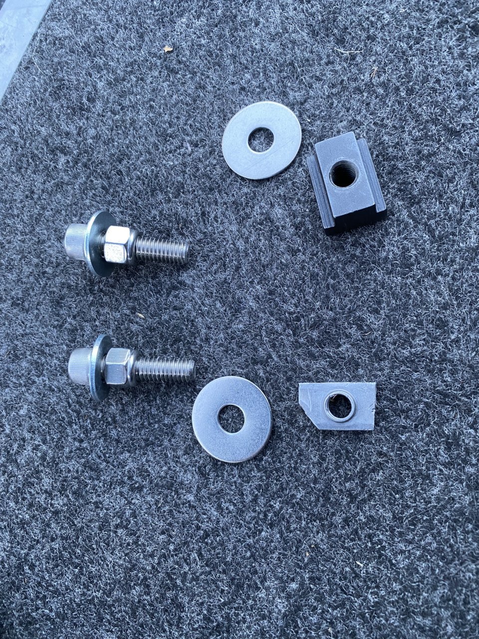

    Modified a weld on nut to tighten in the t-slot on the bed and installed the chalk bag cup holders.
    I used 3/8 stainless hardware. The outer washer is to hold the chalk bag on then I used nyloc nuts before a larger washer that allowed everything to be tightened.
    Here's the test fit showing how the spot weld nuts worked. Like the GFC fasteners, I could insert it into the track then it locked in place as I tightened it. This was a better option for me than having to remove the rear GFC mount to slide a T-nut past it.
    Everything assembled and ready to install.
    They're a bit large for 12oz cans but a coozie and something to help raise it up will solve that.
    For now I'll just toss a couple of these in there.
