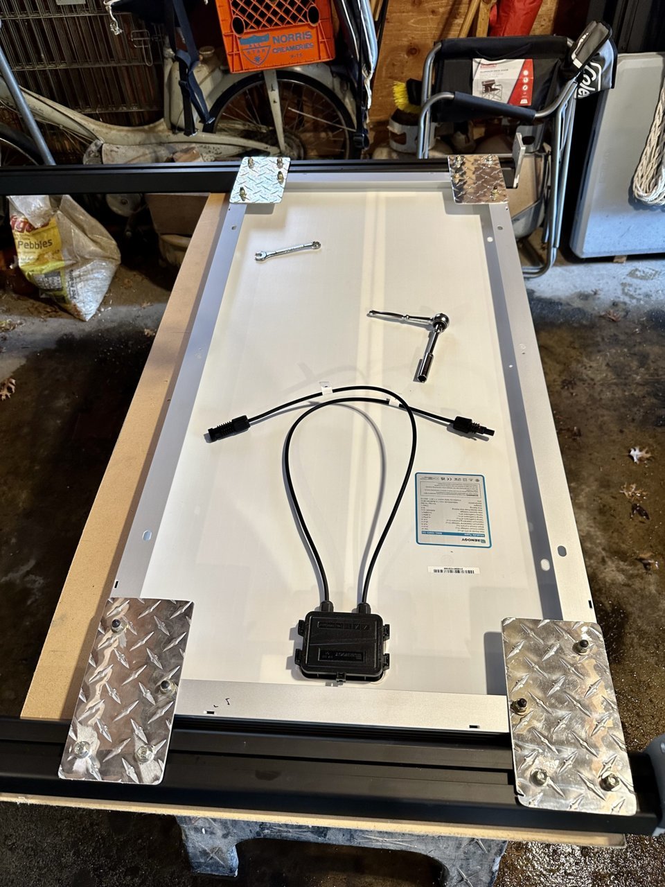

    Finally got around to mounting my panel. Went with a 100 watt Renogy. Mounted to the underside of the beef bars. Managed to sneak the wires through the small gap where the side of the bed meets the front of the bed. Nice to not have to drill any holes this way.

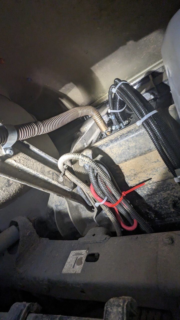

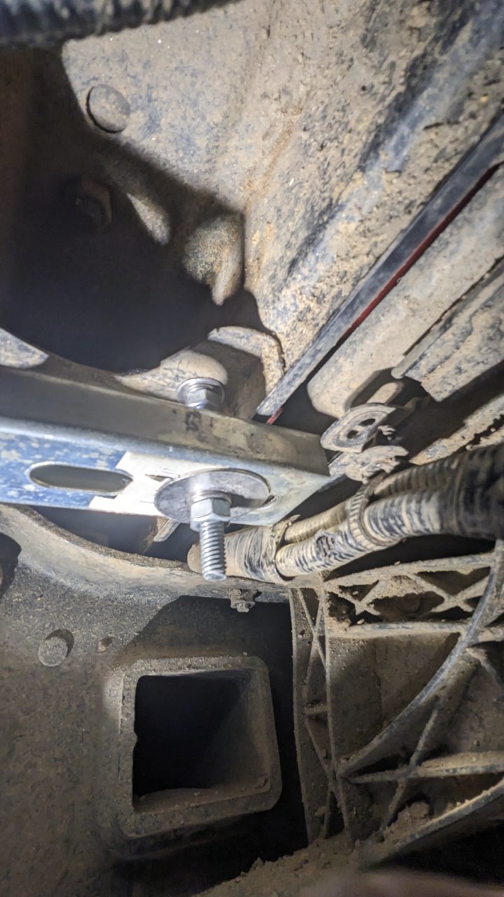

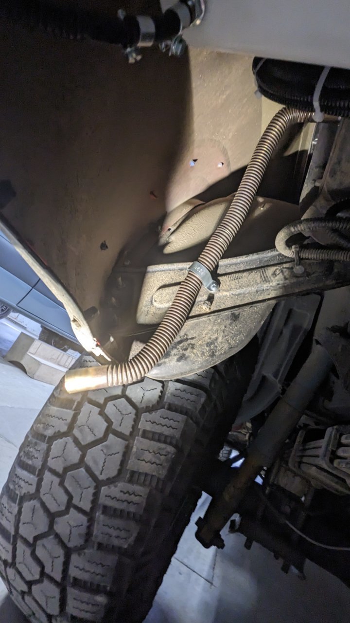

    I know a number of y'all have done the portable heaters, thought some of yall would find my permanent install interesting

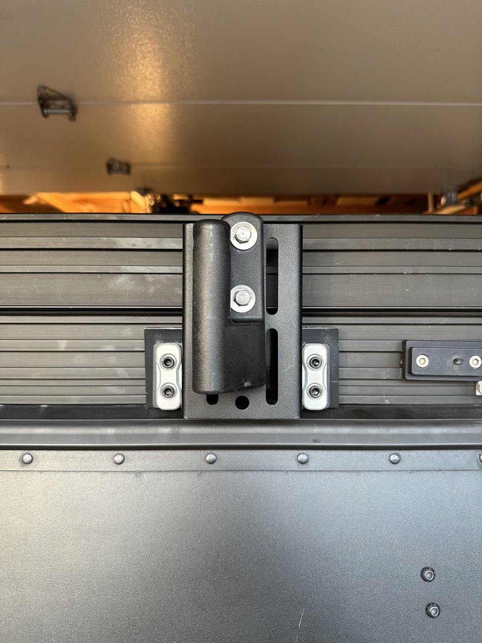

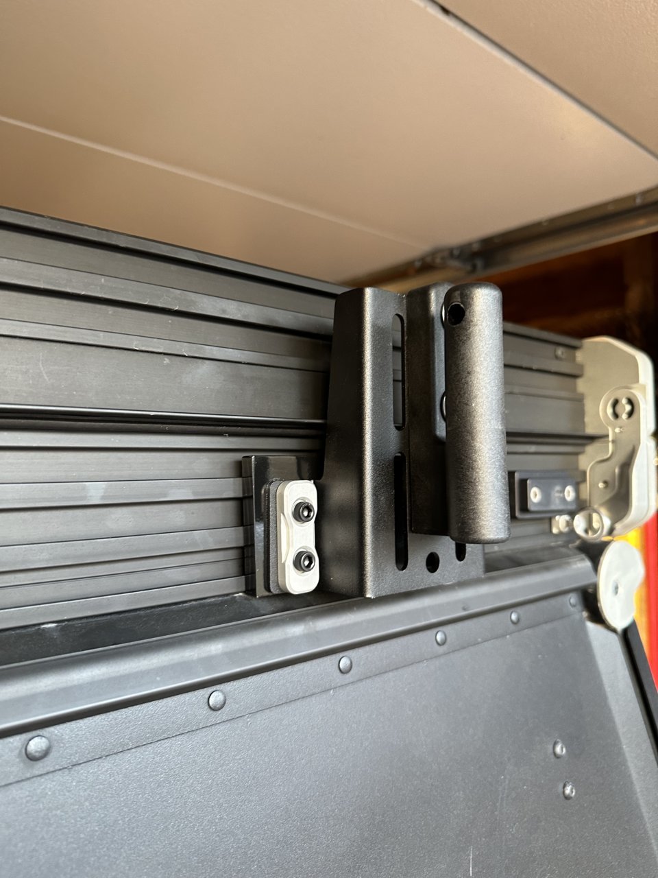

    #2320
    mattsolnitzky
    mattsolnitzky Well-Known Member
    Jan 29, 2021
    #354386
    133
    2021 TRD Sport
    Added a rear awning using both the GFC awning brackets and the Ironman4x4america quick release awning brackets. The GFC brackets don’t fit on the rear (despite what GFC told me) so I had to add a 3/8 spacer and get some longer bolts. The quick release brackets are nice since this is my daily driver and there is no reason to leave the awning on all the time. The quick release brackets are lockable too. Can also still easily access the tent latches and still use the fly rods.
