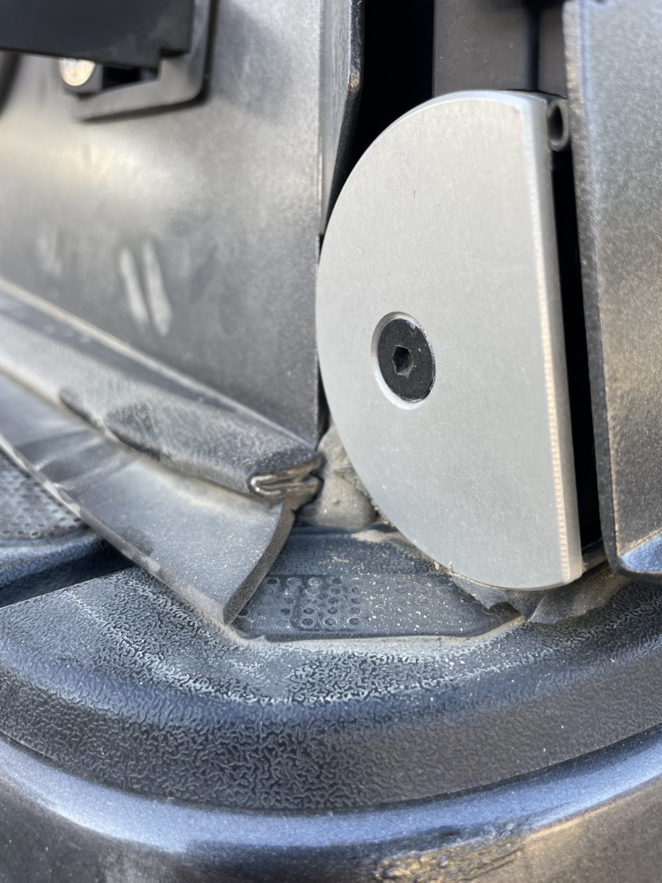

    Anyone have a solution to this big gap in the sealing below the rear latches on the V2? I get quite a bit of water in through these and it's annoying me

    Butyl tape or rtv?

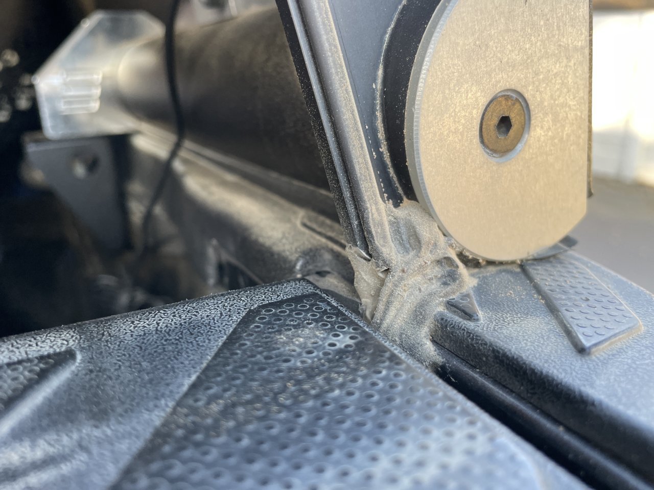

    I stuffed butyl tape in there, works pretty good.

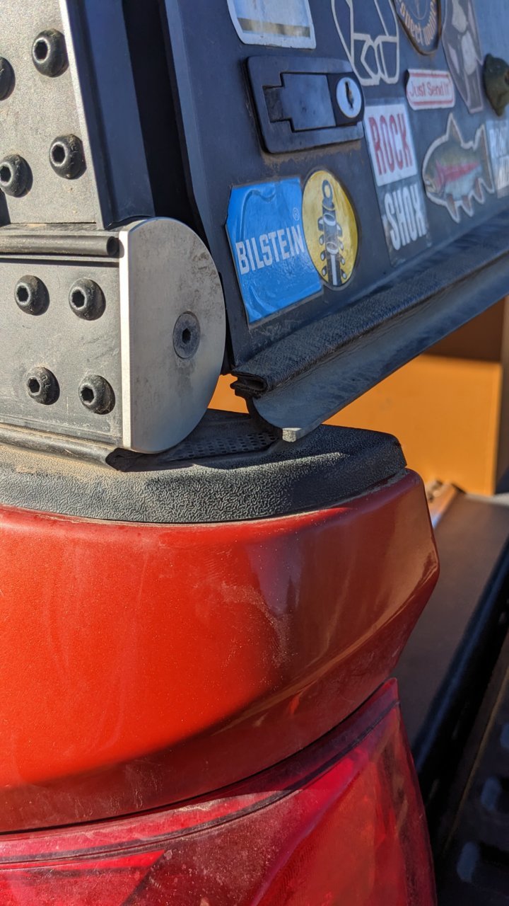

    I cut a cpl small pieces of P-strip tailgate seal, and stuck it on the backside of the rear hatch so that when I close it most of that gap is taken away.

    Any photos of these? I'm trying to figure out which surface I can stick something on that's not gonna fail in a month

    I've got over 2 years so far on butyl tape

    On which surface? The top of the bedside, the bottom lip of the rear door, something else?
    Another photo with the tailgate down to further elaborate
    smcd355[QUOTED] likes this.

    This is what I'm looking for, that butyl is so smushed it could be caulk. Hopefully this will solve my problem. I also think I need a "limit strap" bit of paracord on the hatch to stop water from running down it into the bed when open
