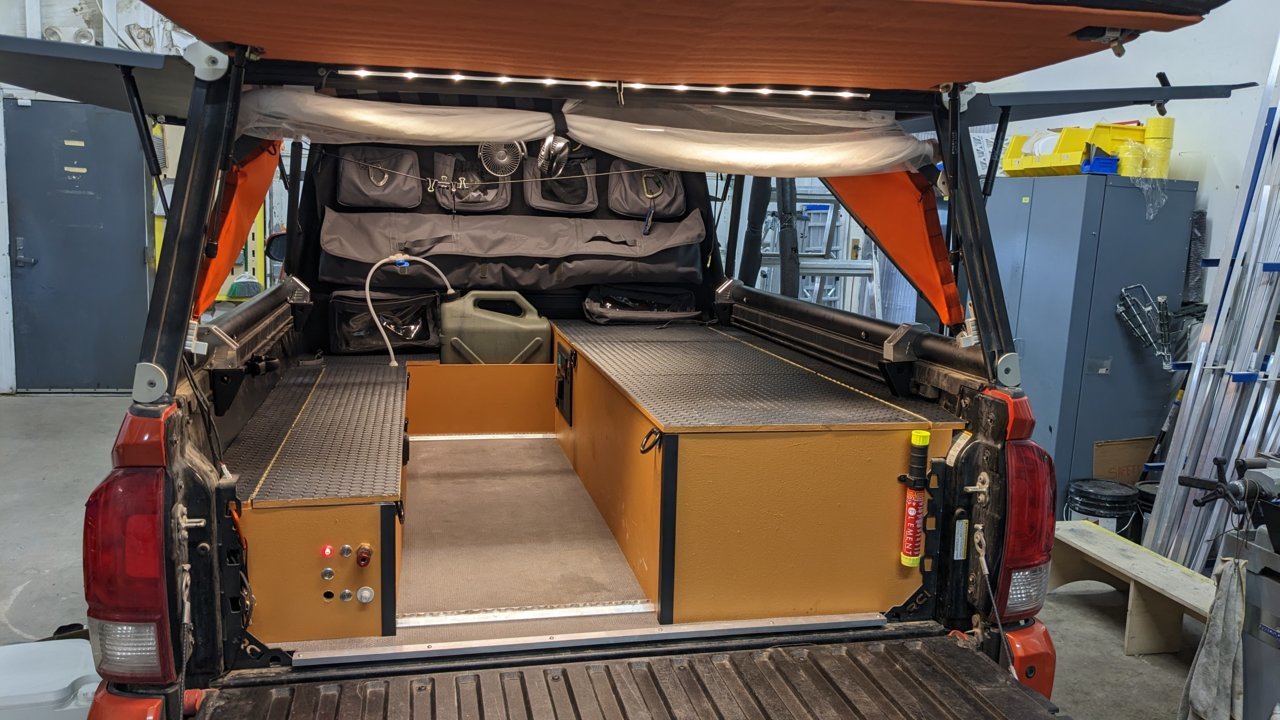

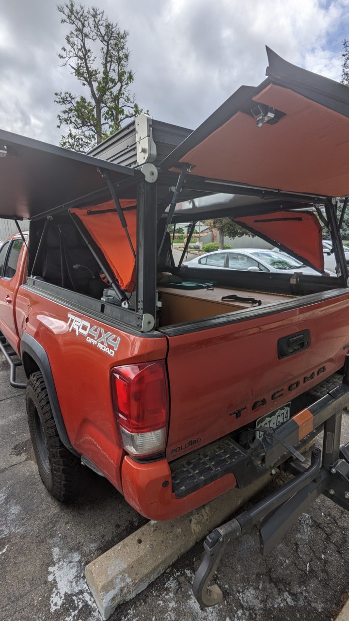

    Not quite finished with my build out but getting close enough I feel like posting pictures. Includes on board air, water pump, 230ah AGM with 200W solar up top, fans, heater, and 2000W inverter.
    Floor is 3/8 coated floor out of a sprinter van. Cabinets are 1/2" Baltic birch with an opaque deck stain and lonseal coindot on top. I used piano hinges and gas struts for the hatch doors, which was a mistake but you live and you learn. I made the bags on the side from a bike frame bag pattern with cordura. The bug netting is secured with magnets VHB'ed to the underside of the bed lip.

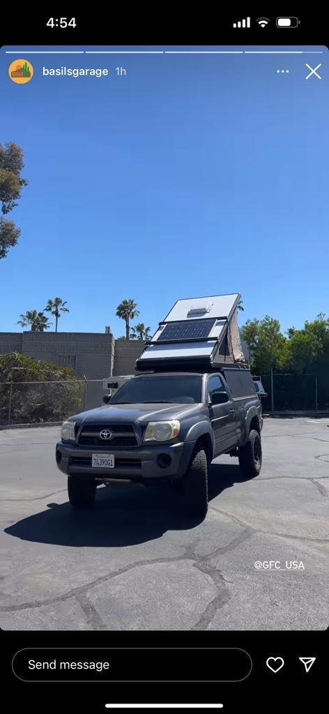

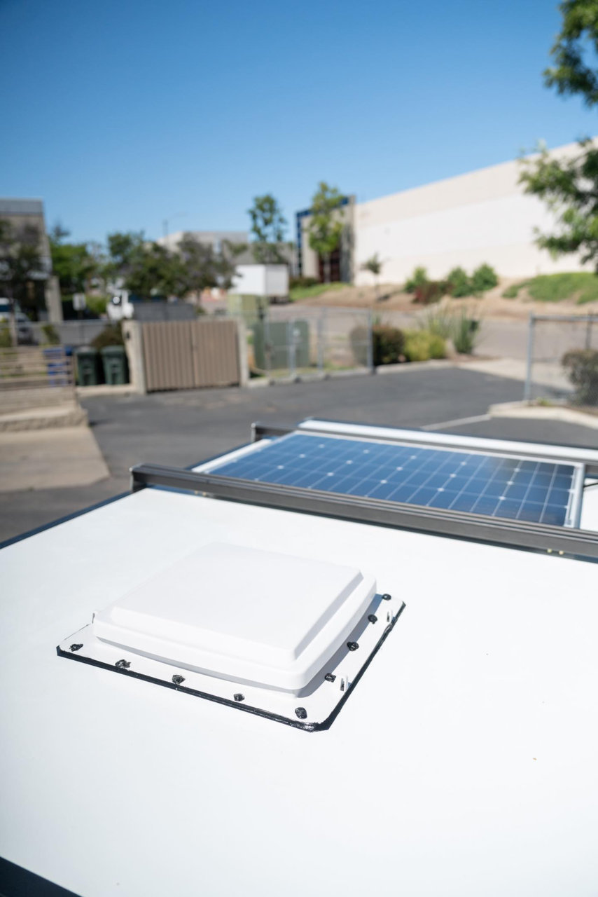

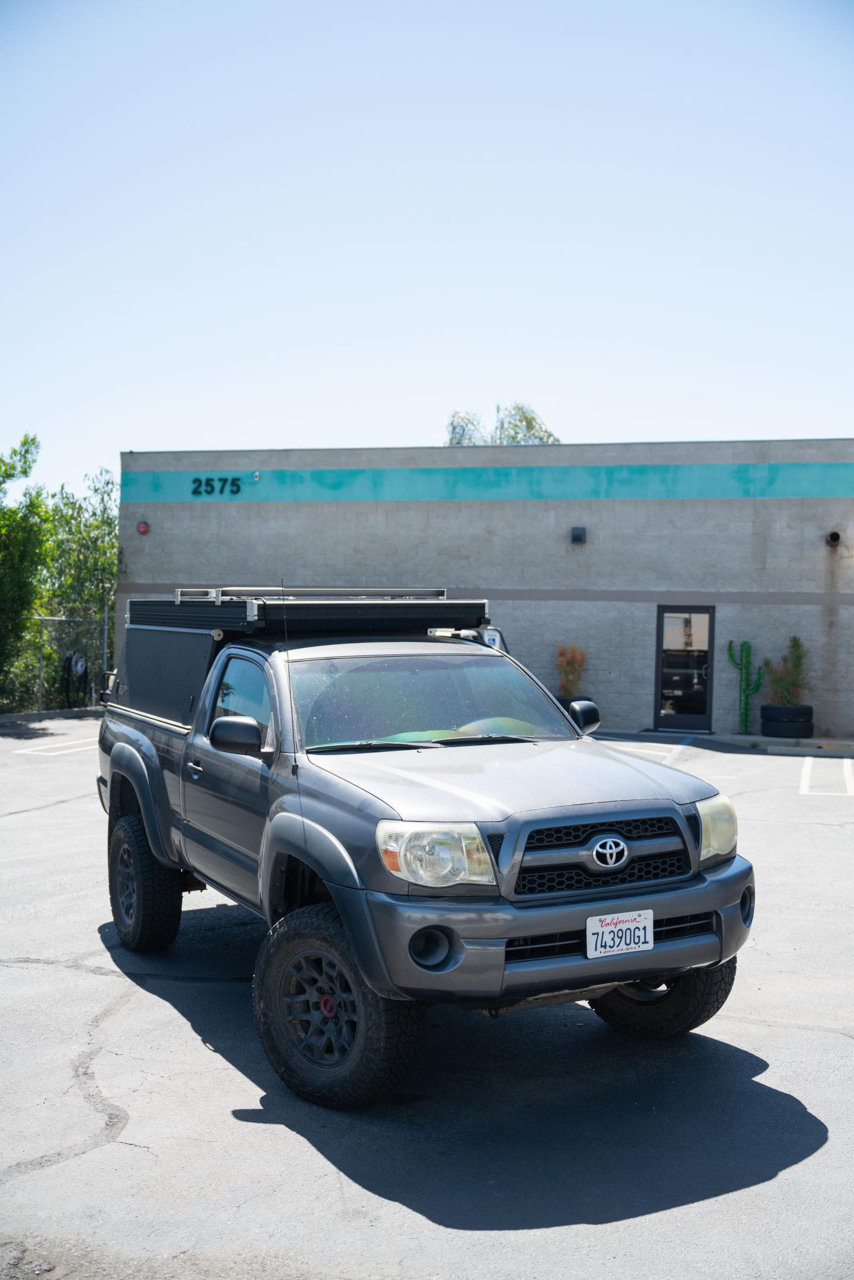

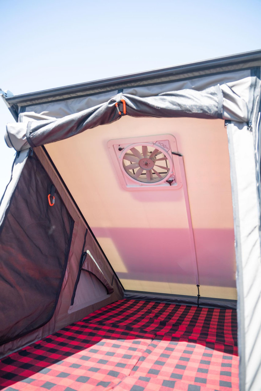

    Had basils garage install my solar and roof fan pretty pumped and stoked on how it turned out

    Looks good! What fan did you go with?

    Hells yeah! Big upgrade. Nice

    Looking good bro! Clean clean clean!

    thanks! Went with the maxxair

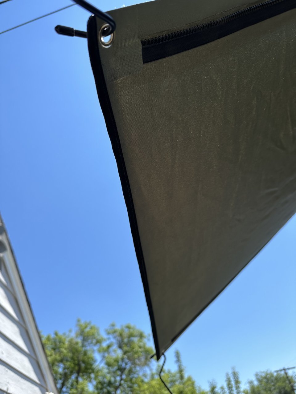

    Installed some 3/8 grommets today so I don't have to use tarp clips with the shittco awning

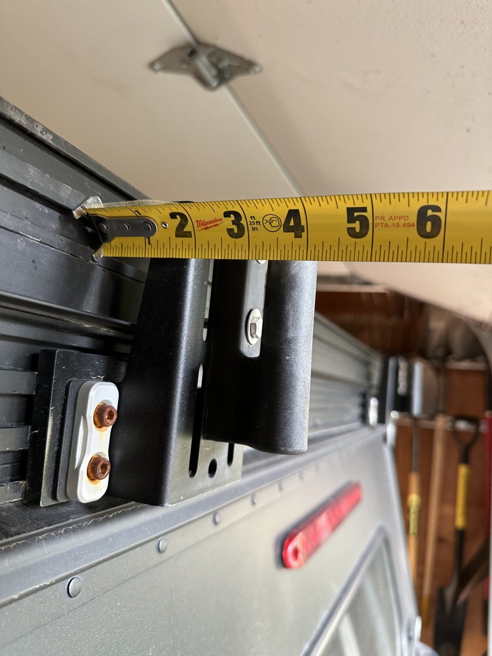

    Looks like it sticks out about 2"?
    I just bought the ironman quick release brackets for my OVS awning, was hoping I could source some shorter hardware and bolt it directly to the extrusion without using the GFC mounts and keep it as slim as possible but not sure if that'd work. GFC brackets will be the backup option if so.

    GFC brackets move it out about 2 inches. Mine have a spacer behind them to clear the lip on the back of the camper. If you mount them on the side you won’t need them so it would be slightly less.
