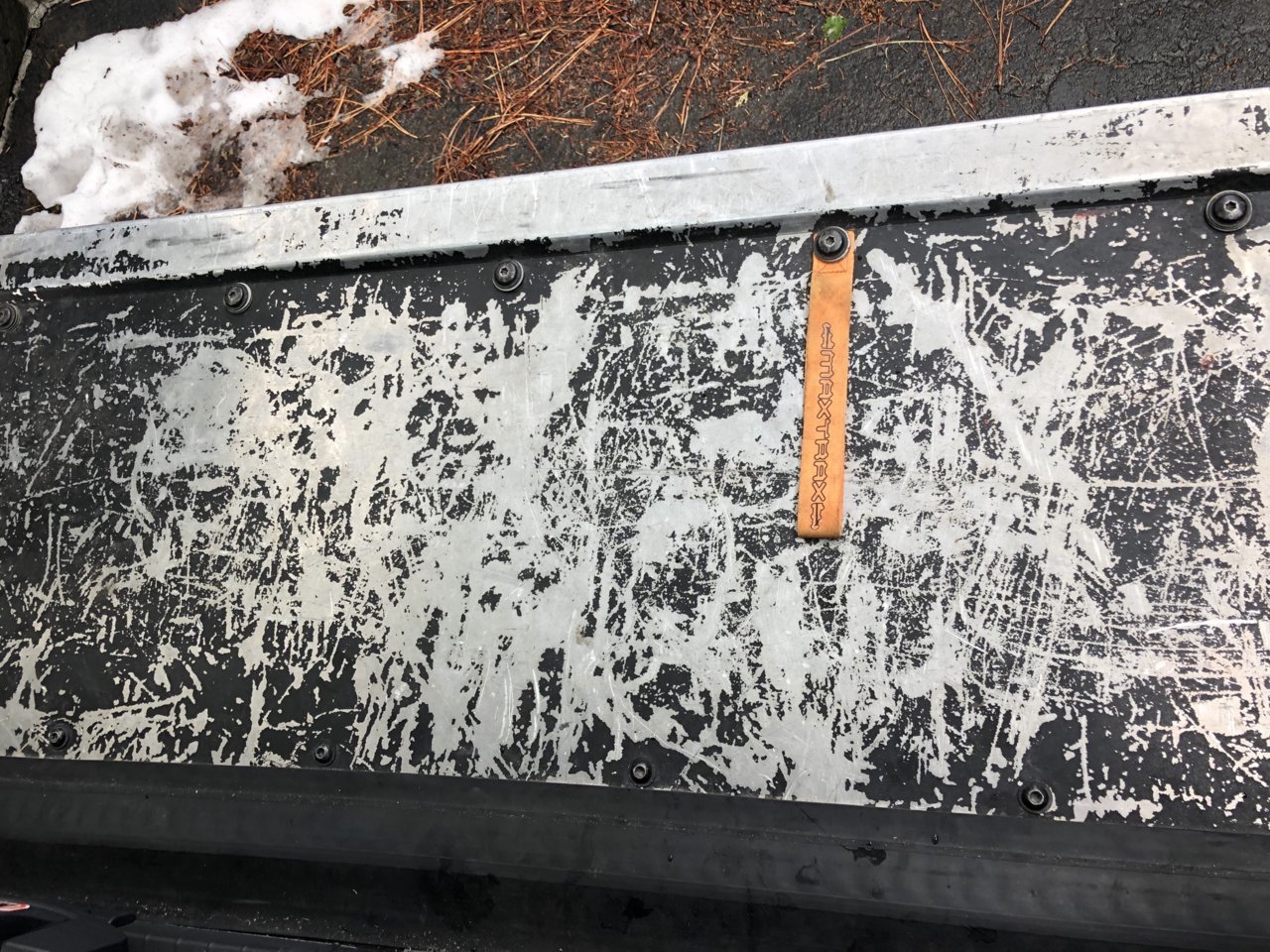

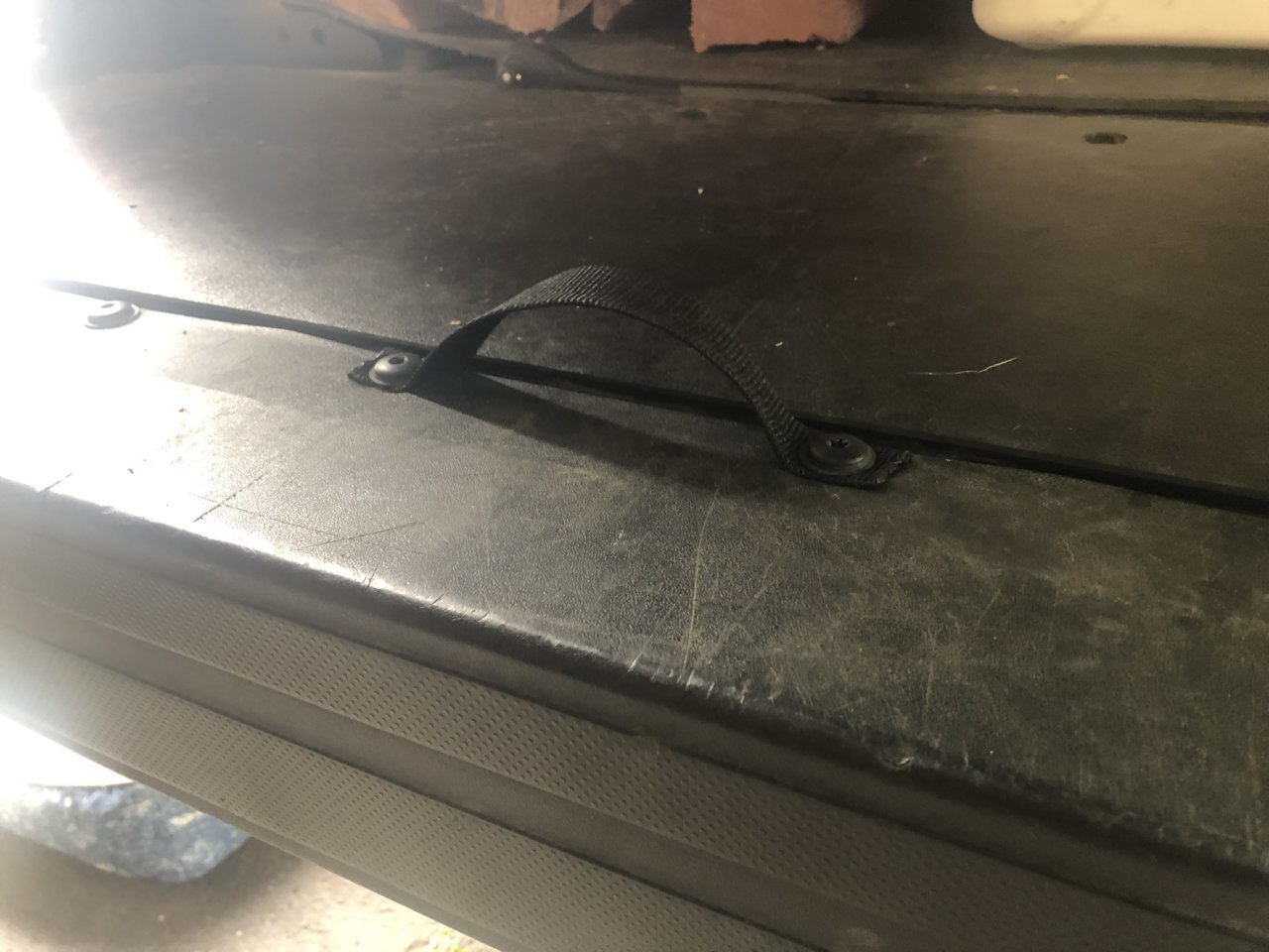

    ^^What he said. Most of us use a soft strap to avoid the inevitable tripping and falling and lack of butt seating space with a hard handle.
    I cut off the end of a maxtrax leash and just ran one of the stock screws through it. But any lashing strap will work.

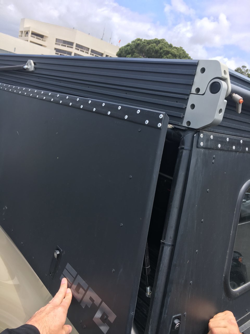

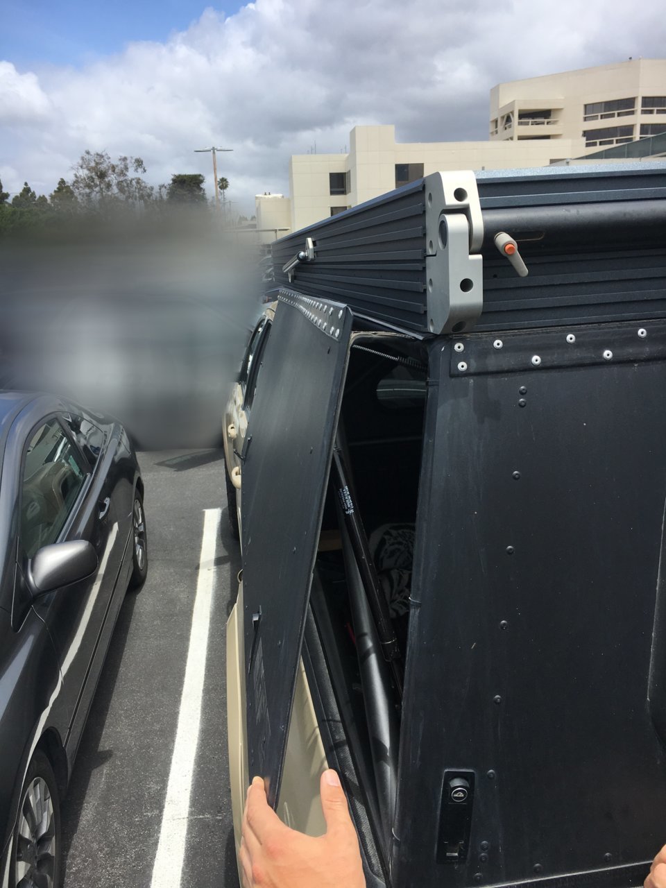

    ***CHECK YOUR HINGES OUT!***
    Opened my driver side door yesterday and heard a loud crack. The plastic "hinge" cracked nearly all the way from the front to the back. The strut in the back pushes against that upper back corner, so now the door does not latch closed at all.IMG_9842.jpg
    Ended up running a couple ratchet straps around the entire GFC to get home without the door open. Luckily wasn't while on a trip, but this is now the 3rd failure my GFC has had in the time I've had it since July.
    Anyone else seen this on their GFC?
    Anyone have a guess at what kind of plastic the hinge is made of?
    Maybe some kind of better material as a replacement?

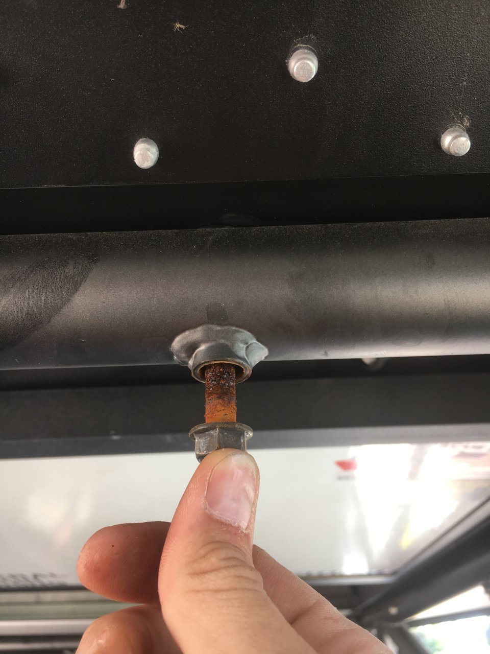

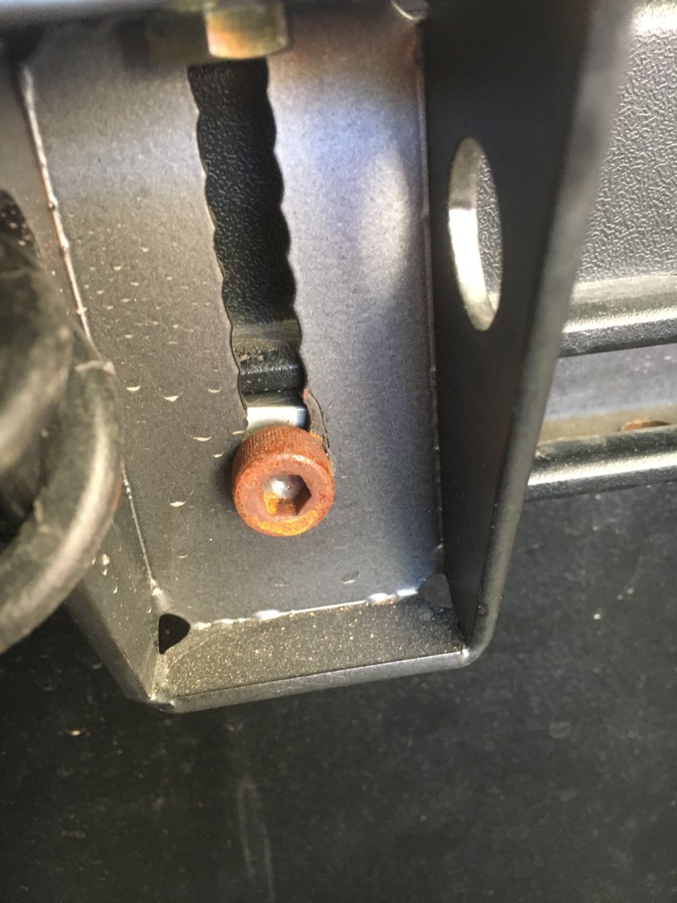

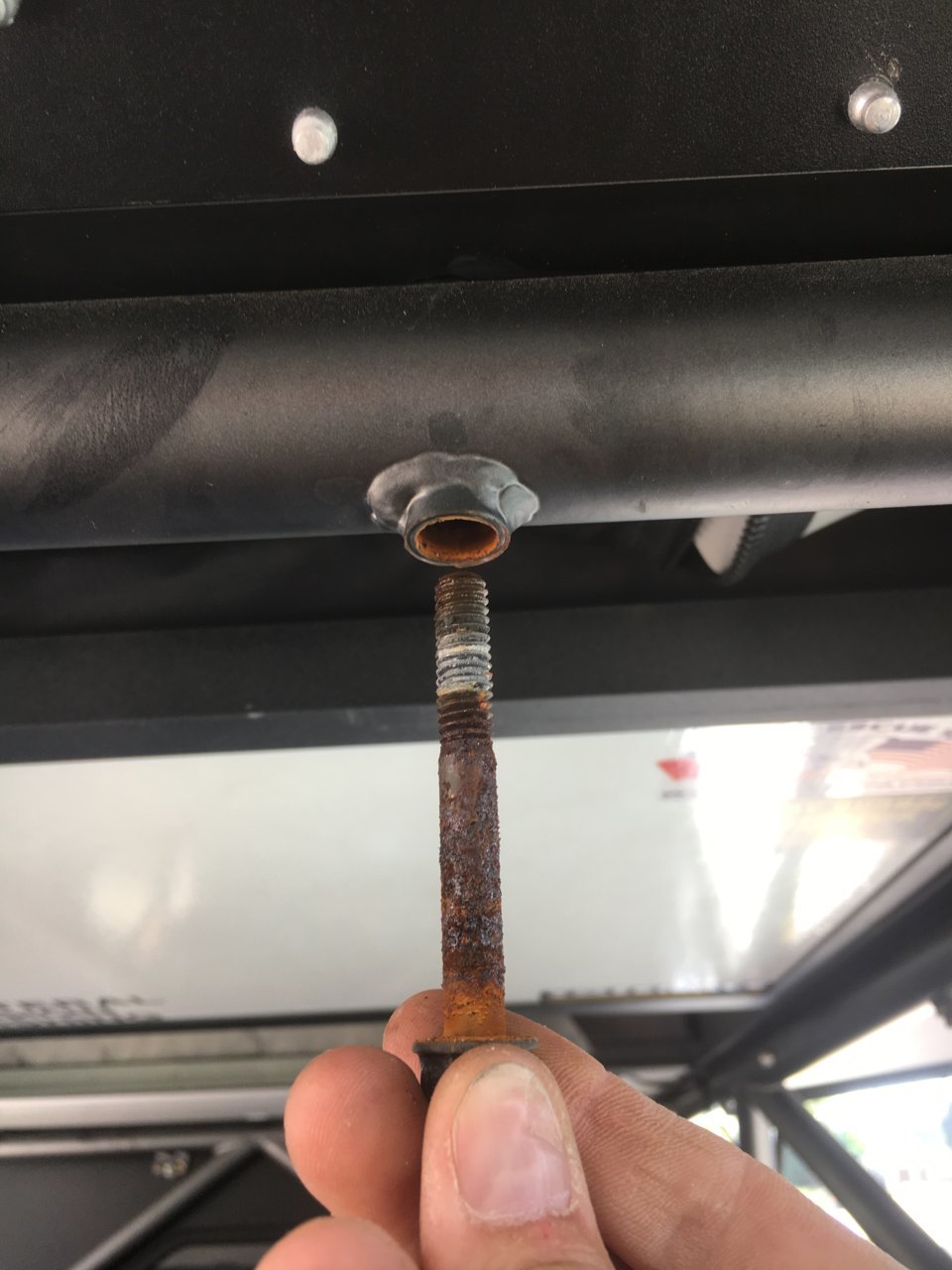

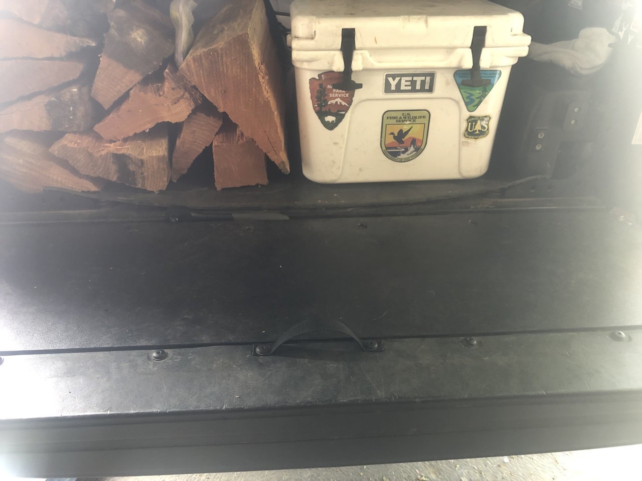

    Yes I have seen rust in mine as well, I put dry lube in but haven’t been able to clear out the rust completely.
    I also don’t have the grade 8 hardest like everyone else, and I have a lot of rust on every bolt I’ve pulled out.
    F6735818-5C0A-48C4-BCB6-F89322F43EBB.jpg 897BF911-9584-4E36-B30D-866C250FE7B4.jpg

    Are these bolts inside the frame of the camper?

    Yes, specifically the two holding the back of the tent down over the tailgate.
    All of my bolts that hold the GFC down to the bed track have rusted as well.
    I’m going to end up replacing all the bolts with ss or the grade 8 hardware, but I’m concerned about the rust inside the actual frame now

    Perhaps galvanized bolts would work. They wouldn't be Grade 8 but probably strong enough. Replace with galvanized, coat heavily with something better than WD40, like CorrosionX and call it good.
    Weathering Steel
    When galvanized bolts are used on weathering steel, the zinc will initially sacrifice itself until a protective layer of rust develops on the weathering steel. Once this rust layer develops, it forms an insulating layer that prevents further sacrificial action from the zinc. The zinc coating has to be thick enough to last until the rust layer forms, usually several years. Most hot-dip galvanized bolts have enough zinc coating to last until the protective rust layer develops on the weathering steel, with only a minimal loss in coating life.
