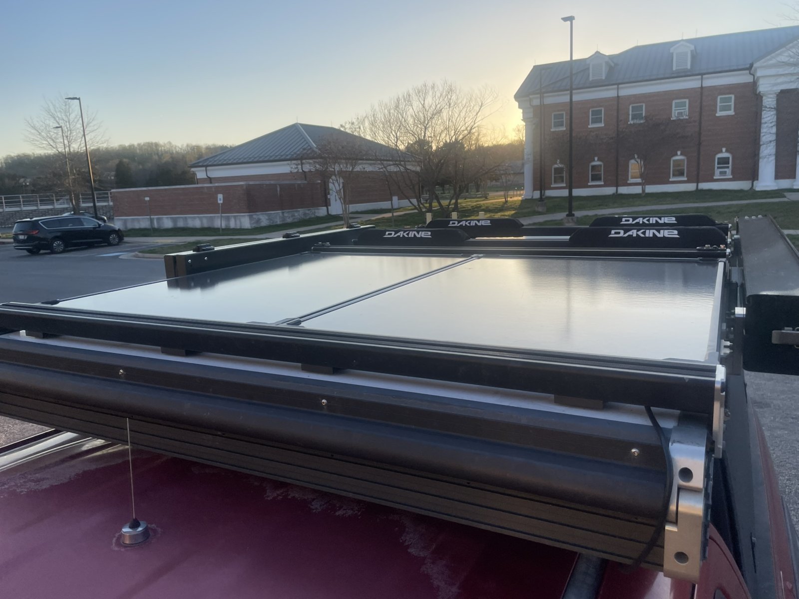

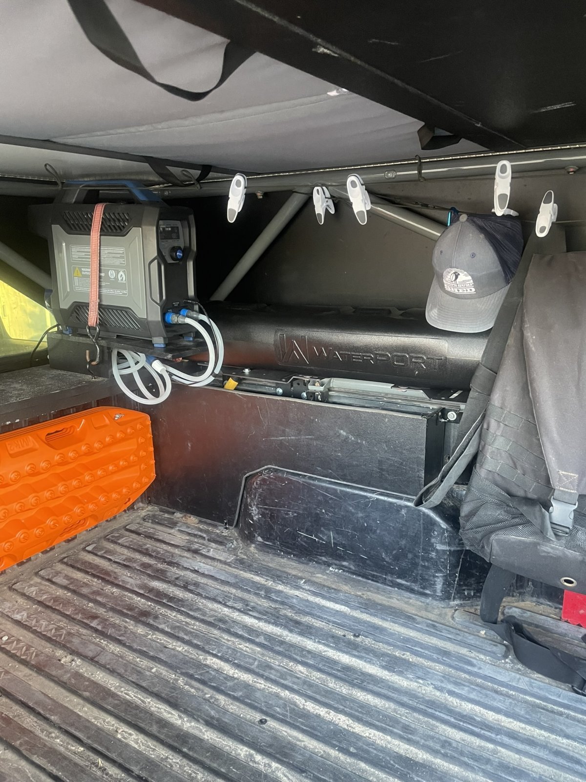

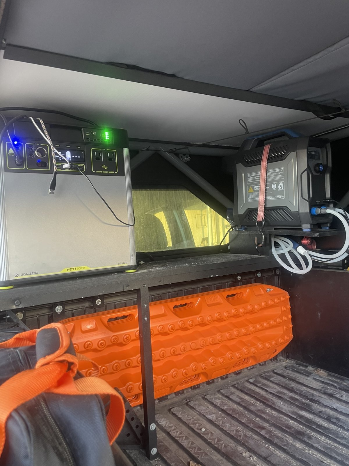

    Some stuff I've done with my V1 GFC, purchased back in 2018.

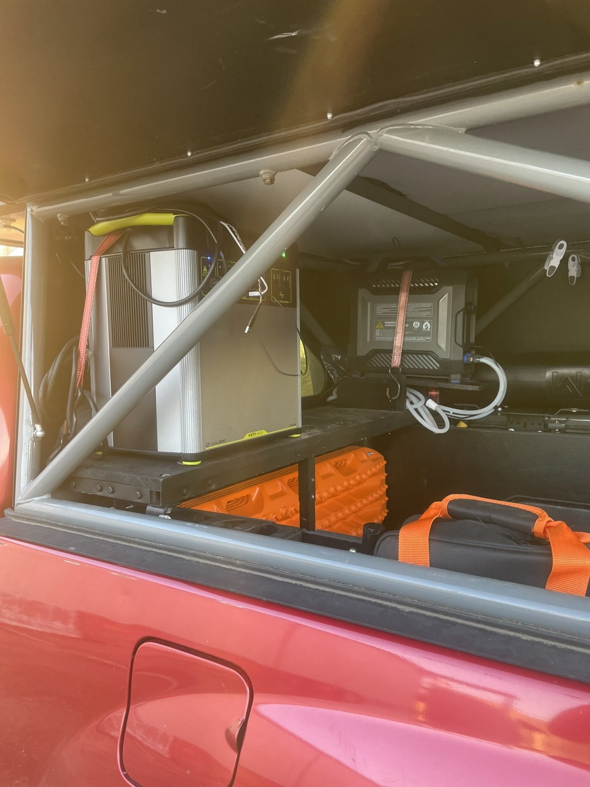

    Yeti Goal Zero for power, Kakadu for hot water. I keep the traction boards up against the wall there unless I think I'm likely to get stuck.
    Another angle.

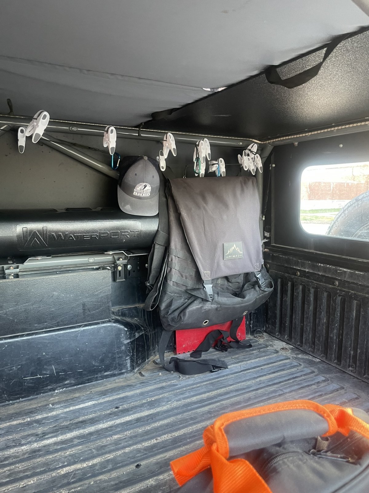

    Drying out the spare tire trash bag and ballcap on my clothes line. Works pretty well, especially with the hatch opened.

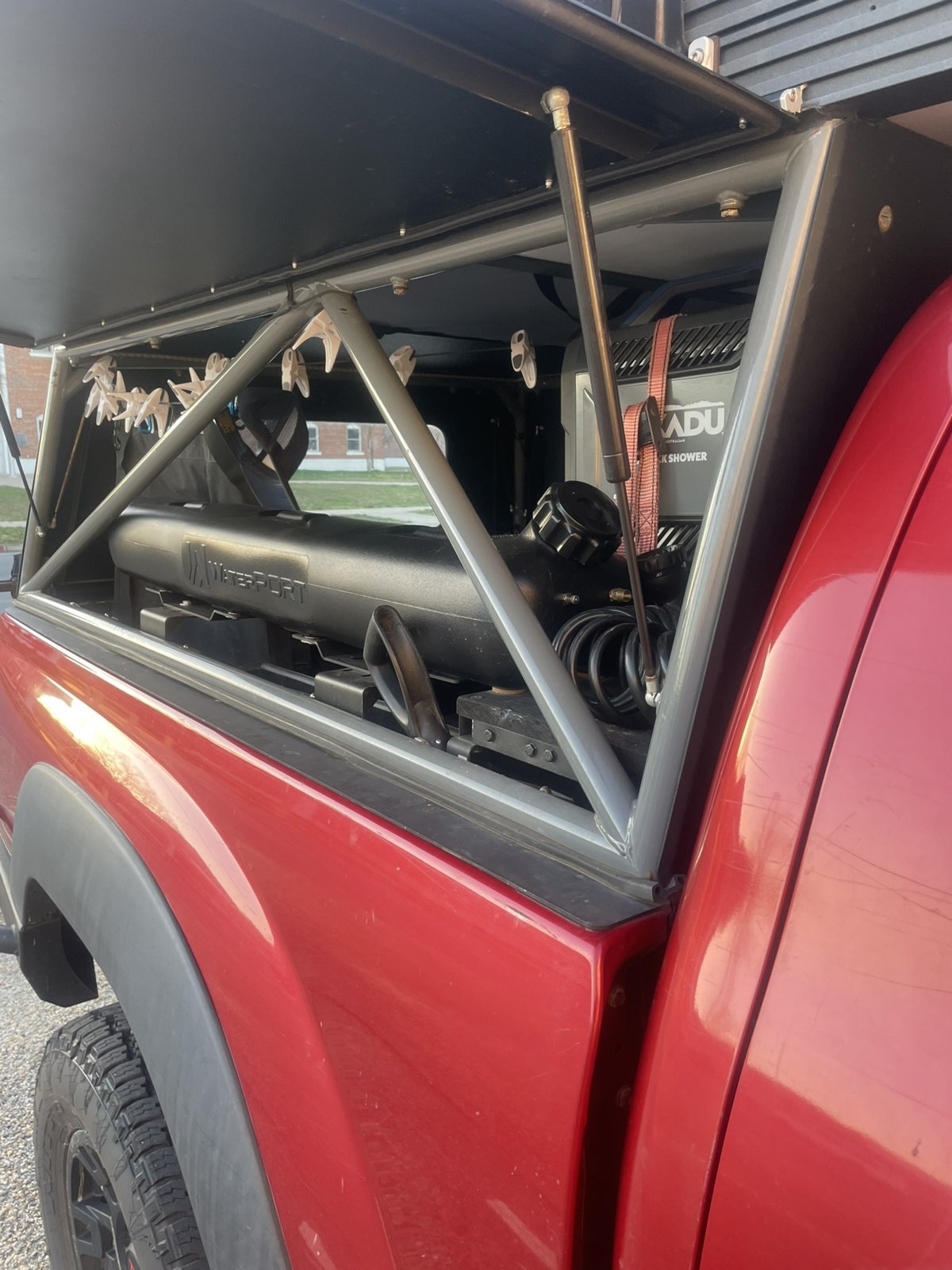

    This angle also shows the cubbies I built years ago to hold stuff in the unused space behind the wheel wells. These are made from ABS and work great. Waterport has been awesome for extended camping trips.

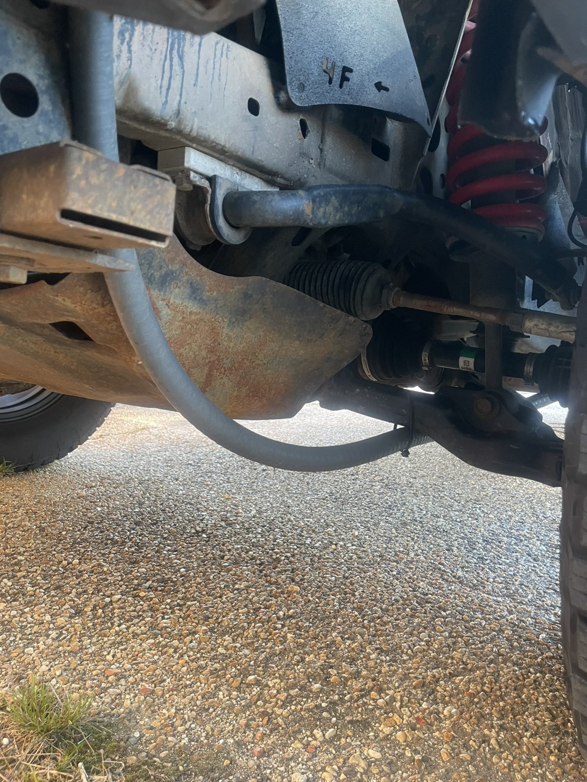

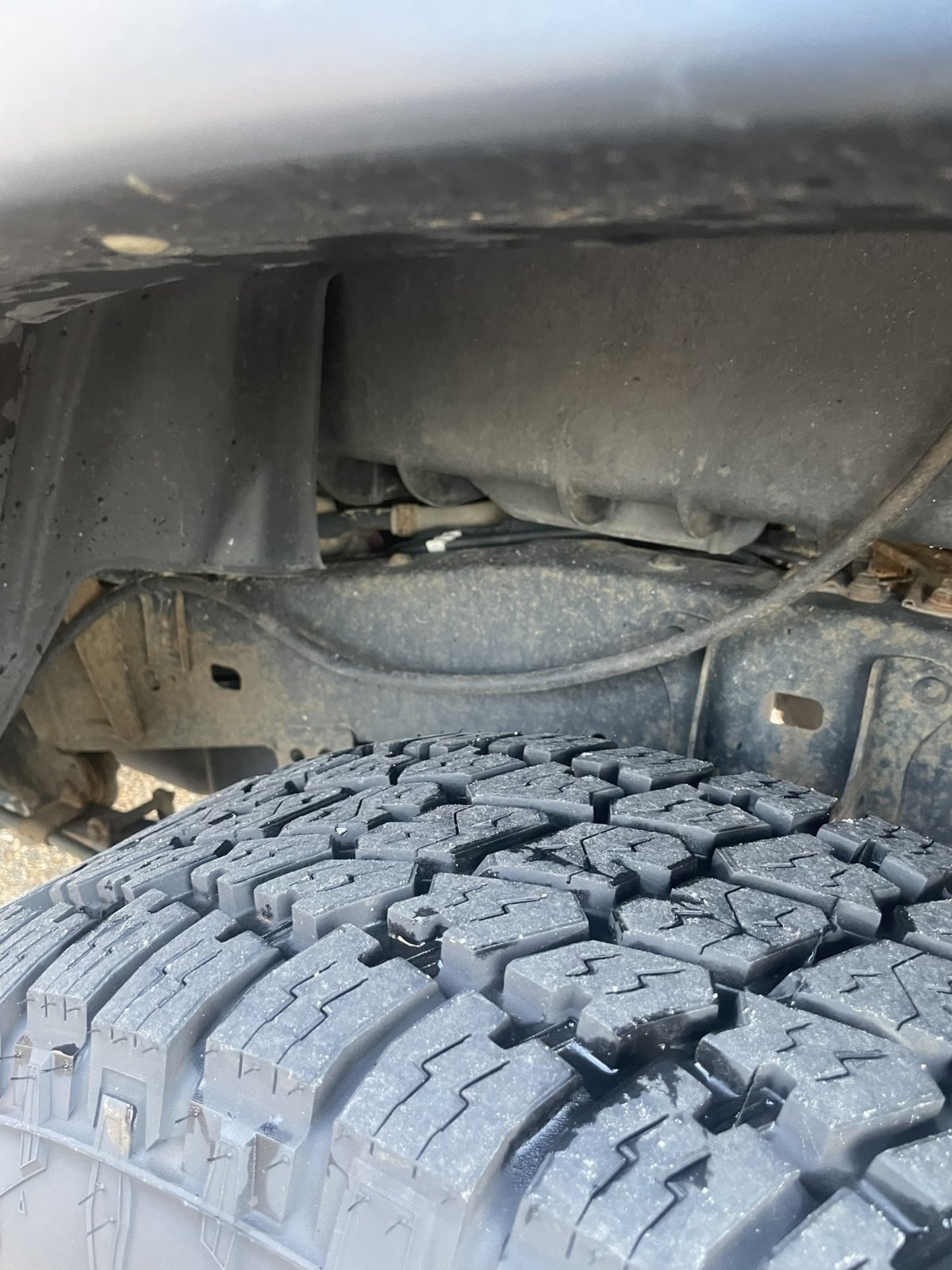

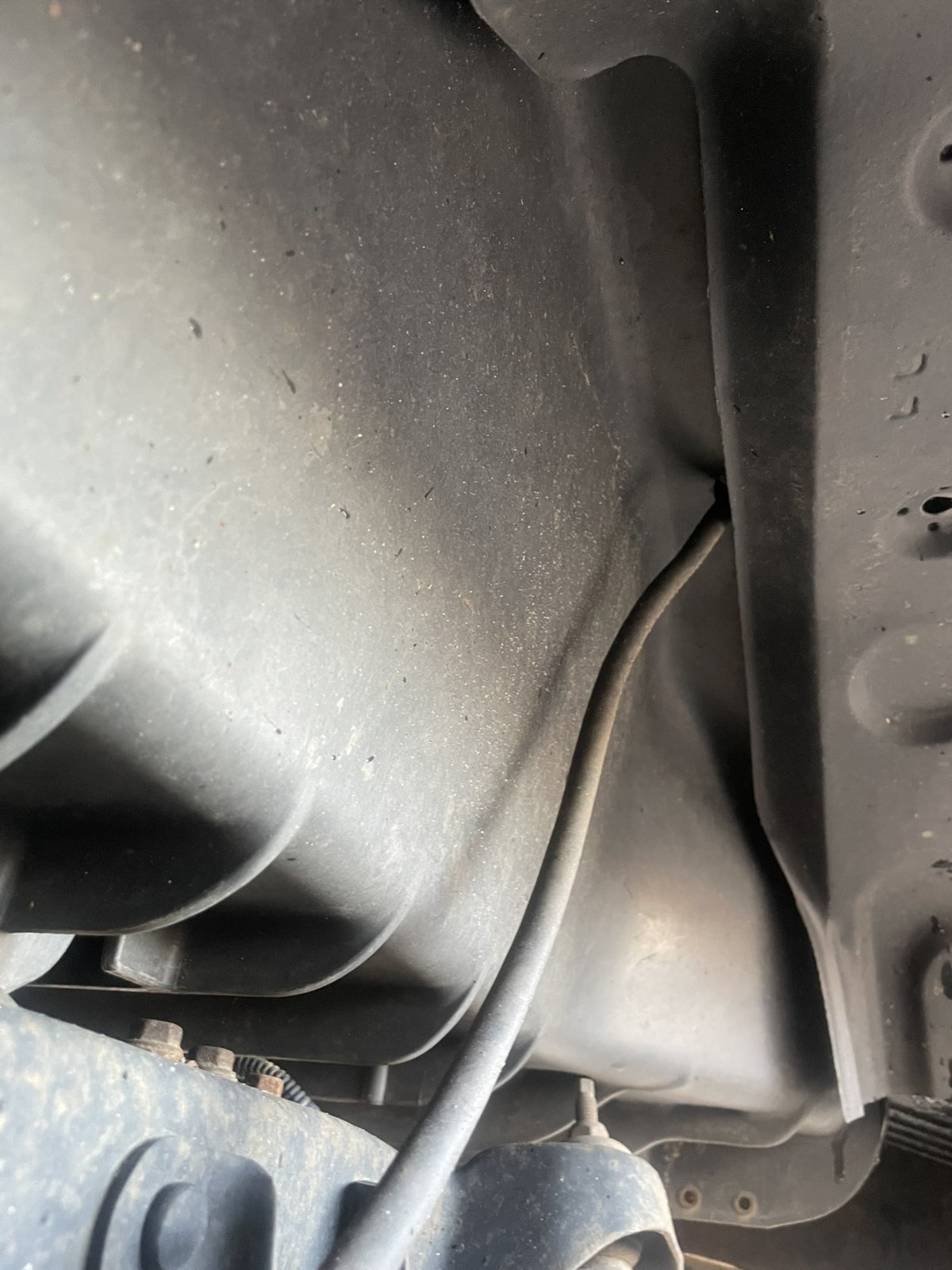

    The cable from truck battery to Goal Zero runs down through the wheel well and under the truck. Next few pics show how I route it to the engine bay. I'm not a fan of this route but it's worked for years and I've been too lazy to fix it since it's never caused an issue.
    Past the back tire.
    Under the lower control arm. This is the sketchy part.
    Here's where I drilled through the GFC to wire solar panels to the Goal Zero.
    Solar panels up top. Since installing them I haven't come close to draining the battery. I run a griddle and coffee maker every morning when camping and these keep it topped off.

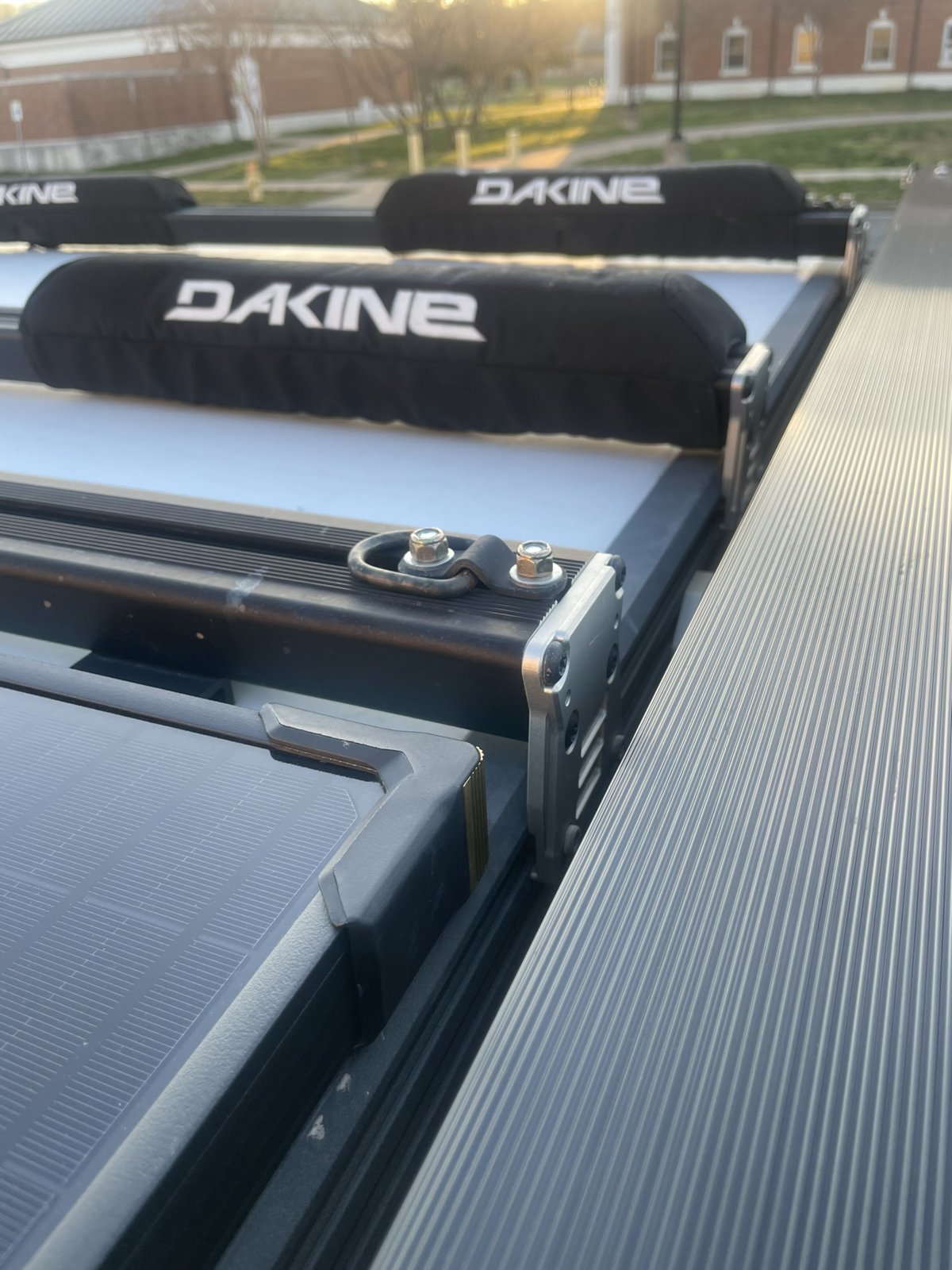

    Some handy eyelets I keep on the bars to make tying stuff down quick and painless.
    More shots of the waterport.
    All in all I'm happy with the GFC, although sometimes I think about the V2 since I like the frame much more. I had to do the hatch swap when the hinges broke like they did for many V1s.
    Anyone got thoughts on the way I run the Goal Zero cable to the engine bay? Haven't given it much thought in years.

    Keep it along/ontop inside of the frame. Then you can turn inside and come up along the firewall on front part of the cab and up by the brake booster, then over along the fender to the battery. One good stick or branch on the ground and that cable is getting ripped like that.

    Good idea. Yeah that's my worry, I don't know how I've gotten lucky thus far. Thanks!

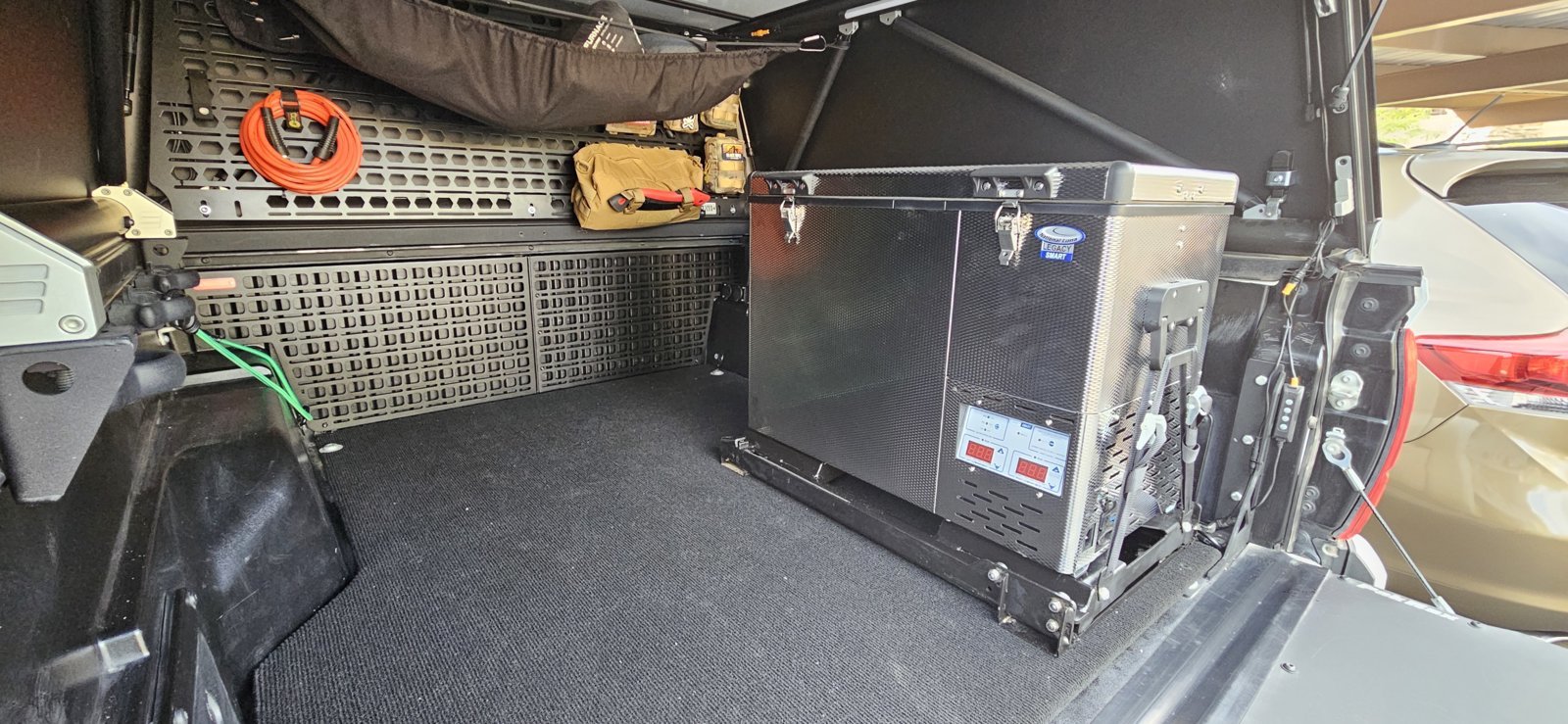

    Sweet setup! How are those boards mounted on that front wall of the truckbed? That looks like what I need to do w/ mine. Always in my way, and always moving them. :rofl:

    Thanks! The waterport is a lifesaver for surf trips, I hate walking around salty when I get out of the water.
    For the boards I bolted 2x flat iron bars with a few holes to the rail. The bars are bolted through to rail nuts at the top, and oriented up/down. Then I used bolts through some of the other holes in the bars, with the threaded rods of the bolts sticking out towards the back of the truck and locked into place with some nuts. Finally, I pushed the boards onto those bolts and locked them in with some wingnuts which you can barely see in the corners of some of the pics.
    It's a little confusing sounding as I write it, I can take some pics if that didn't make sense

    Basically how i have mine. On top of the sliders. Zip tied to another factory harness thats also along that route.

    Right on thanks!

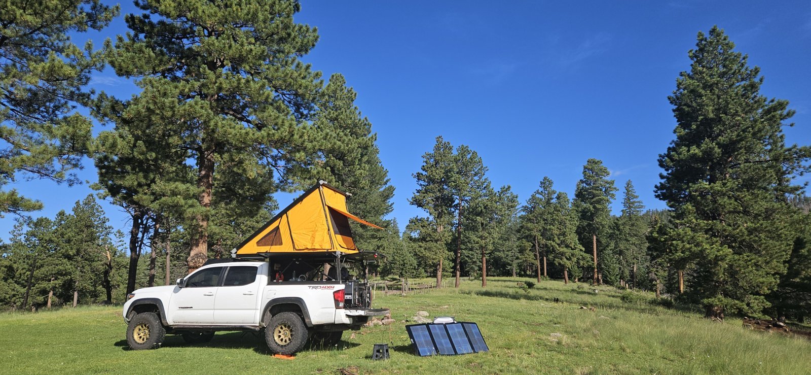

    Tested the solar out finally. So far been happy with the ecoflow delta 2 more than enough to maintain my minimal power needs of fridge and lights. DC charging even at 100w easily covers long weekends. The solar just backup for extended trips or extended stationary time20240803_075916.jpg
