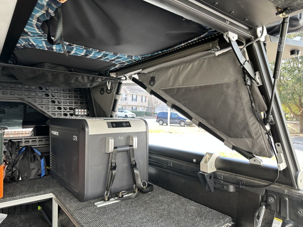

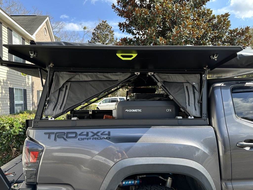

    That’s a CFX3 35L in the bed , but also running a CFX3 55L in the cab.

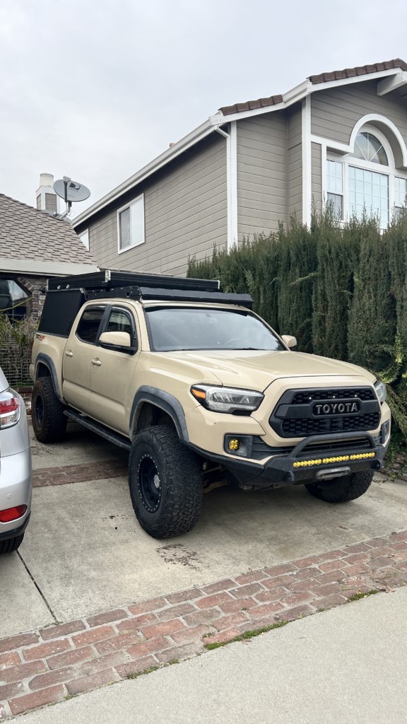

    Mocking my roof rack back up after install and wondering if this is enough clearance. Not sure how much the bed actually flexes but I don’t do any hardcore wheeling.
    Another thought I had was to just notch out the area that would come into contact with the GFC.

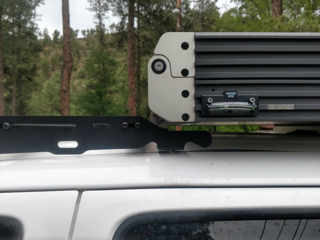

    You'd be surprised at how much flex there is even on street driving. I learned this by mounting my rain guards 1 t slot too low looked like I had plenty of room but still rubbed my sherpa animas on the street. Based on your sketch You're gonna want to extend that red line down more

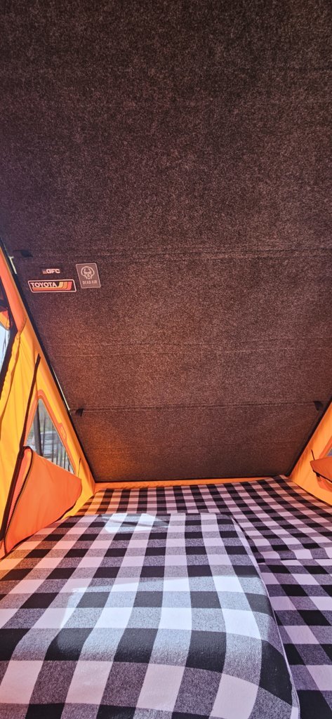

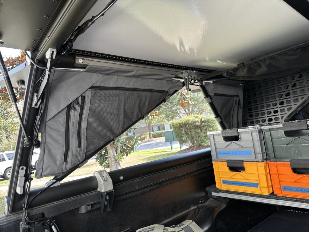

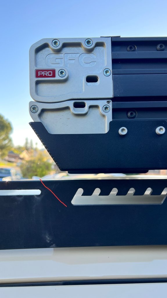

    Wow surprised the bed flexes that much even with street driving. This is the amount of clearance with the Martin roof rack which is why I figured trimming up to the red line would suffice.

    Remove some material, test, remove more as [if] needed...

    What's the benefits of a headliner?

    I'm not sure what the marketing is but I would imagine one it blocks the sunlight from coming through in the mornings and as well as helping against the condensation that can settle up there through the night. Also looks a little "homier".

    Condensation reduction is the biggest benefit as the slick material used on the ceiling panel would gather condensation and it would slide down to the low point in the frame getting people/bedding wet
    The other benefit is reduced light coming in through the white roof panel.

    That’s fine if you don’t go fast

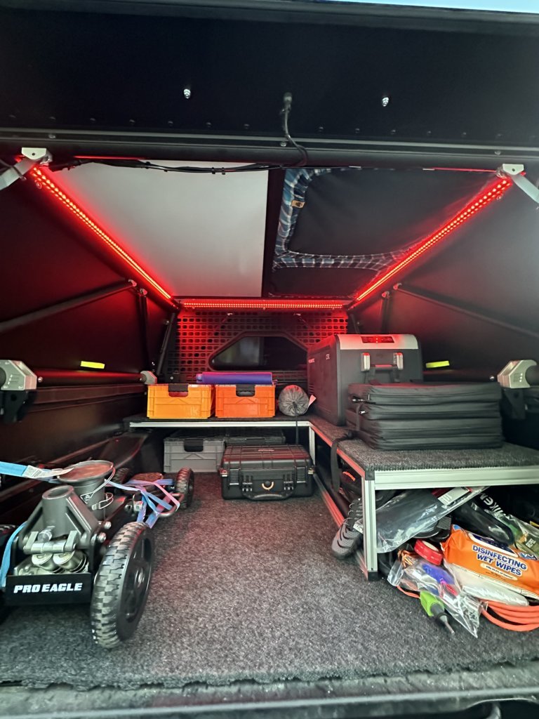

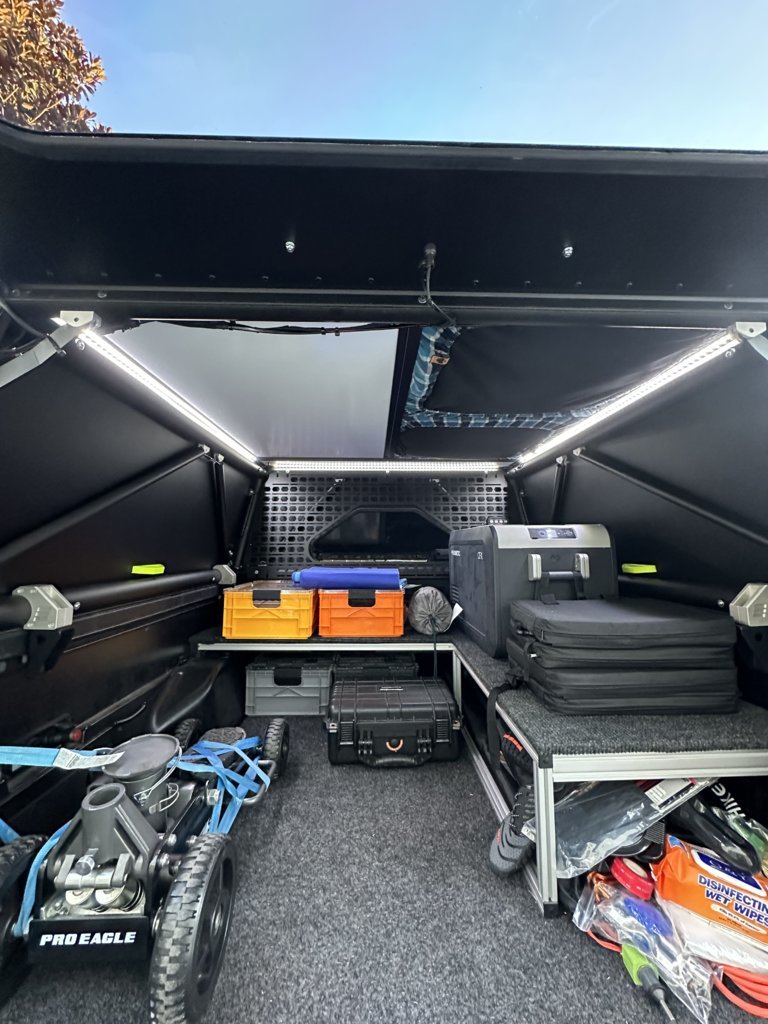

    TBH I’m not really sure if I’m going to install them , I got tired of waiting after I ordered them and ended up getting a set of @mattgecko lights.
    For that install I ended up running them on the channel in the sleeping area. Like shown in one of his install videos. So the headliner won’t be in contact with them.
    I’ve been real happy with his lights.
    Here is a pic of the lower section. I don’t have a pic of the uppers at the moment sorry.

    I love the idea of the pro eagle/badlands jacks but theyre just so big and heavy. 5 foot bed already small enough :(

    Yeah it’s definitely big and heavy. I have a SB , and it pretty much lives where you see it in the pic. It has never gotten in the way when we are camping.
    Fortunately the truck isn’t a daily driver , and if I ever need to haul larger items I just use my work van lol

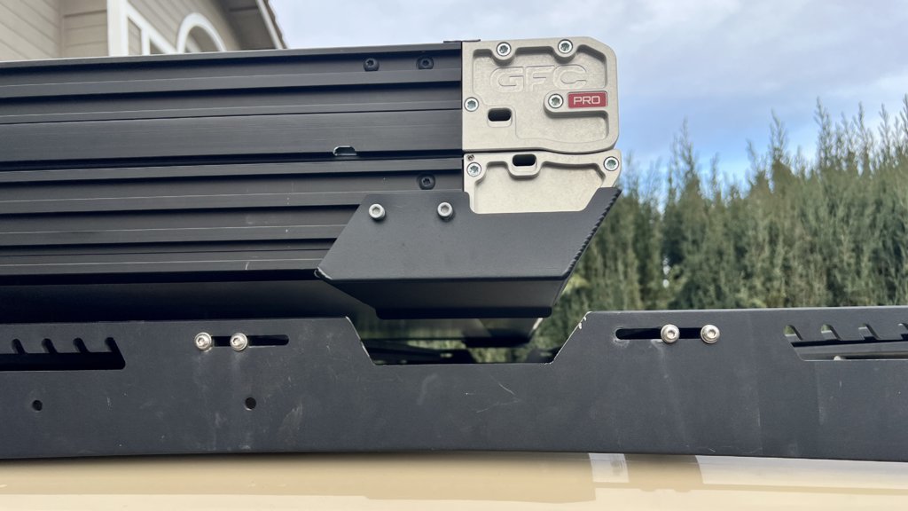

    Here’s what I ended up cutting out. Will test this out for now but so far so good after hitting some speed bumps at a decent speed.

    I would recommend the half rack over the full length roof rack. But if you’re going to keep the full rack, chop everything at the lowest point straight back. There is a risk of the rear part of your cut still making contact with the bottom panel of the tent and punching a hole into it. Plus half of your rack is now useless due to the front of the camper.
