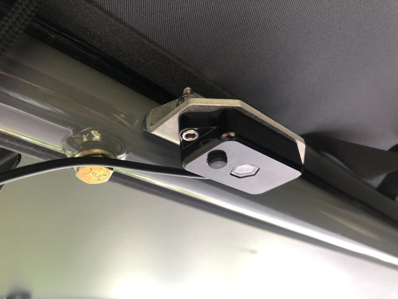

    SensorPush, it stores a lot of data and will have multiple uses after giving me data without/with vents on the GFC!

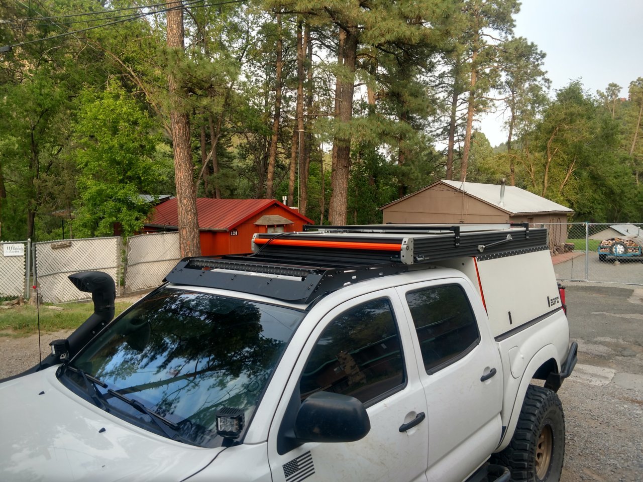

    Got my new rack from @gmartin284. It lines up perfect with the camper.

    Damn that looks good, how much did it run?

    I can't remember the exact amount. This is the second set of side pieces he has made. The first set fit but weren't perfect so I sent him some measurements and pictures and this is the end result.

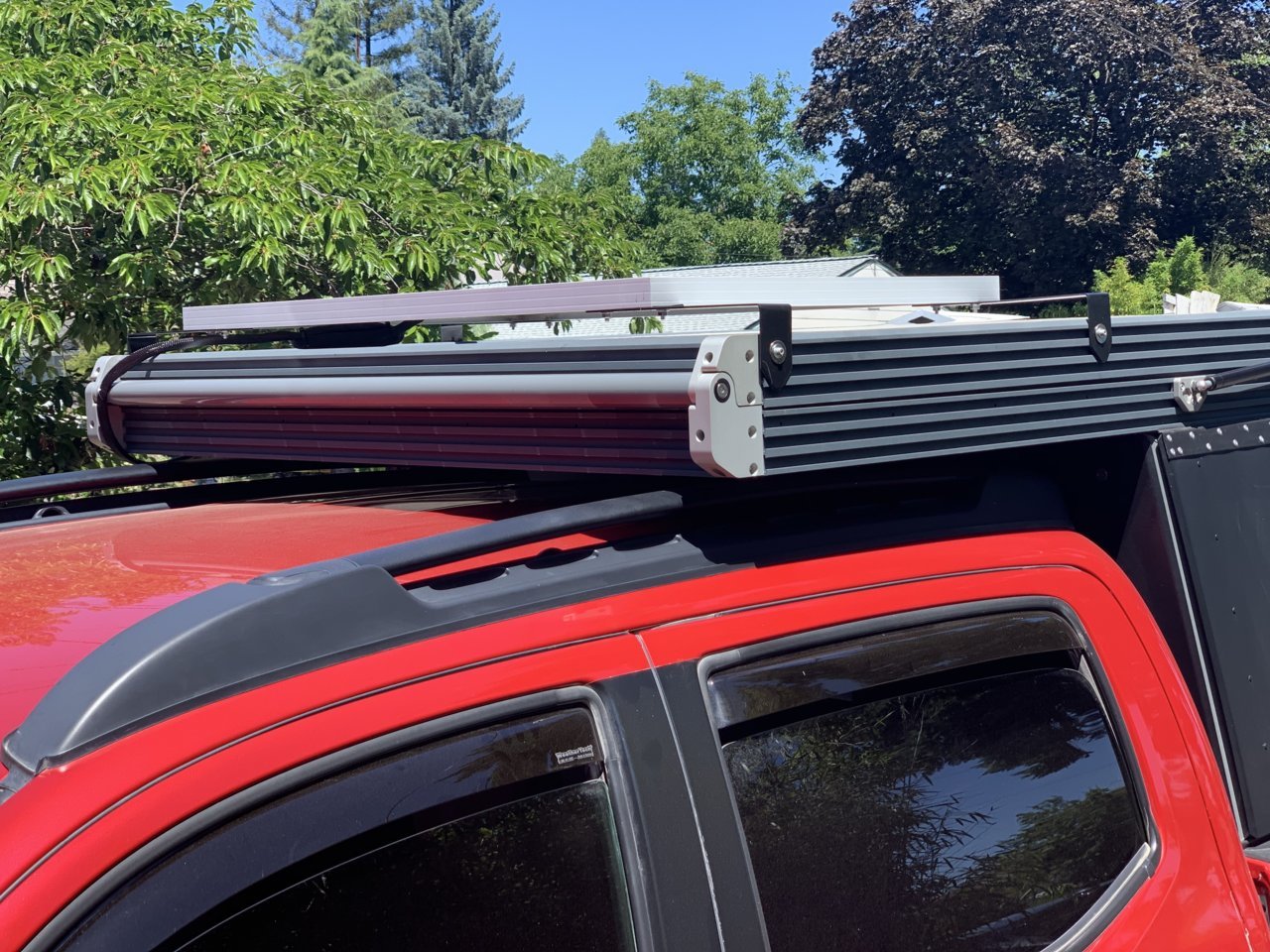

    I installed my solar panel this weekend!

    I was wondering about that also. They feel pretty sturdy. They are 12ga steel. I’m no engineer, so if any of you think that’s not enough, please let me know!

    I share the concern about how strong the attachment is. Especially since wind will be underneath it. For heat and panel performance it is better to have the panel with air under it. At highway speed air under it worries me.

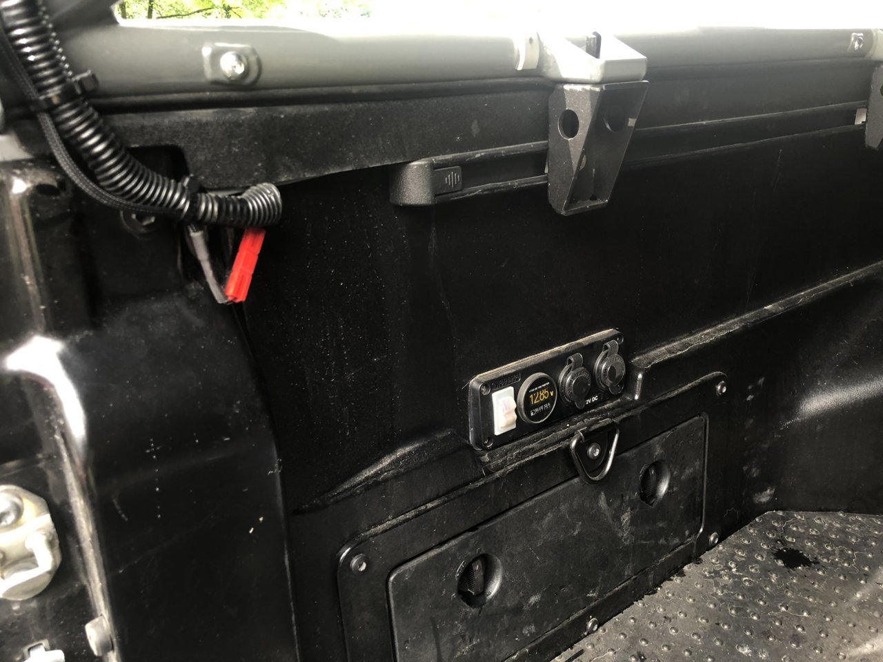

    Finally got it home to do a few little mods that I pre-planned.
    Ran wiring down the drivers side of the truck underneath.
    Installed a blue sea panel with on/off switch, volt meter and two 12v outlets to run my Dometic CFX28 fridge and to plug a small fan in, in the tent for those warmer nights.
    Purchased a Rago Fab Rock Light Mount and installed a Baja Designs Dome Light w/switch on the drivers side. Not sure it will stay there but it gives off enough light for cooking.

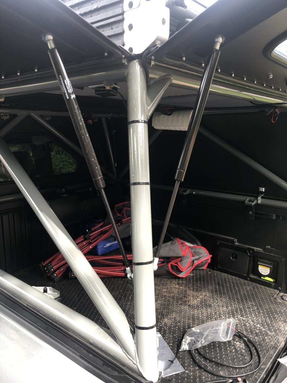

    Last but not least I installed a Baja Designs rear/dust light to the lower rear extrusion. You can see in the photos how I ran my wiring. This light is ran off a switch pro switch in the cab.
    The 12v outlets/Baja light do not connect to the switch pro but rather a blue sea fuse block under the hood so I can turn them on/off anytime if the truck is not running.
    I’m not too concerned about keeping my bed 100% water tight so i added zipties around the frame to hold the wiring in place like the older GFC models.
    They install some crappy sticky wire holds on the new models now to make sure the rear door gasket has a clean seal to the frame for all of you allergic to water.
    Also added a few other things stolen from the threads like, cargo net, levels and a bungee strap for a paper towel holder.
    I’m having the rear window tinted later on this week. Also have a couple backseat organizer seat back panel things I ordered on Amazon coming. I’m going to try to mount those on the cab side on either side of the window to help store basic camping gear and bug spray, haha.

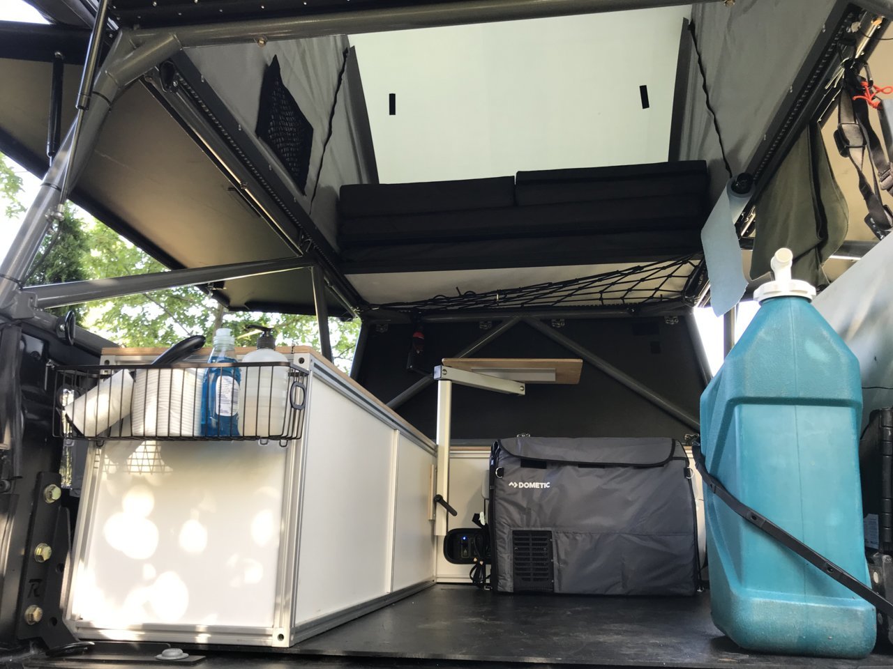

    Side note; I got my camper back. I won’t be able to tell if my issues were fixed until we get some good rain.
    I got a full HD ome lift done at Wanderlust Overland in Oregon city, Oregon today.
    The ride is nice and it brought my back end back up.
    Installed all my storage, solar, and fridge as well.
    I use a Thule storage box during snowboard season and on longer trips. I decided to mount the solar all the way near the tailgate so that it will not be covered when the Thule is on.
    Going to go see if I can’t find some summer steelhead or chinook up in the Olympic peninsula and will be excited to put the new suspension and living quarters to the test.
