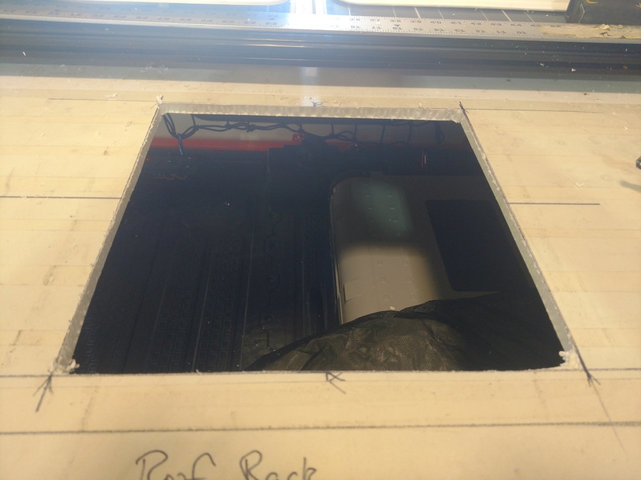

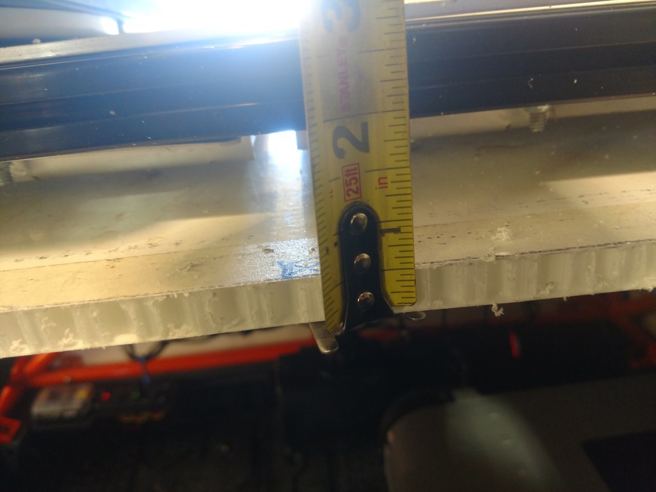

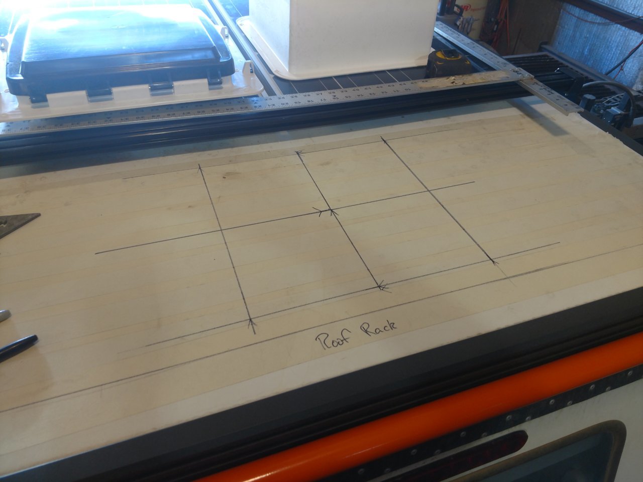

    Well I got the hole cut. I figured the roof would be 1" this, but it's only 1/2".
    IMG_20190708_103816408.jpg IMG_20190708_110342162.jpg IMG_20190708_111222495.jpg

    #165609
    821
    Zayne
    Ohio
    2017 Cement TRD Pro
    Oh fuck. That’s new. Now what?
    You’re for sure going to need a half inch thick picture framed shaped bracket to go on the inside and through bolts.
    This changes a lot....

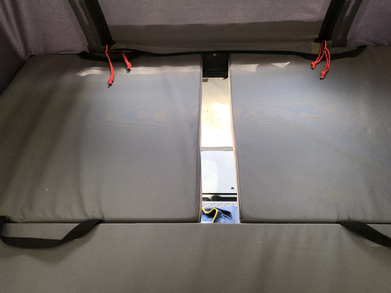

    I think I can still get away with going directly to the roof and not needing a spacer. It will just stick inside a 1/2". I run my rear cushions upside down so it gains me a little room.
