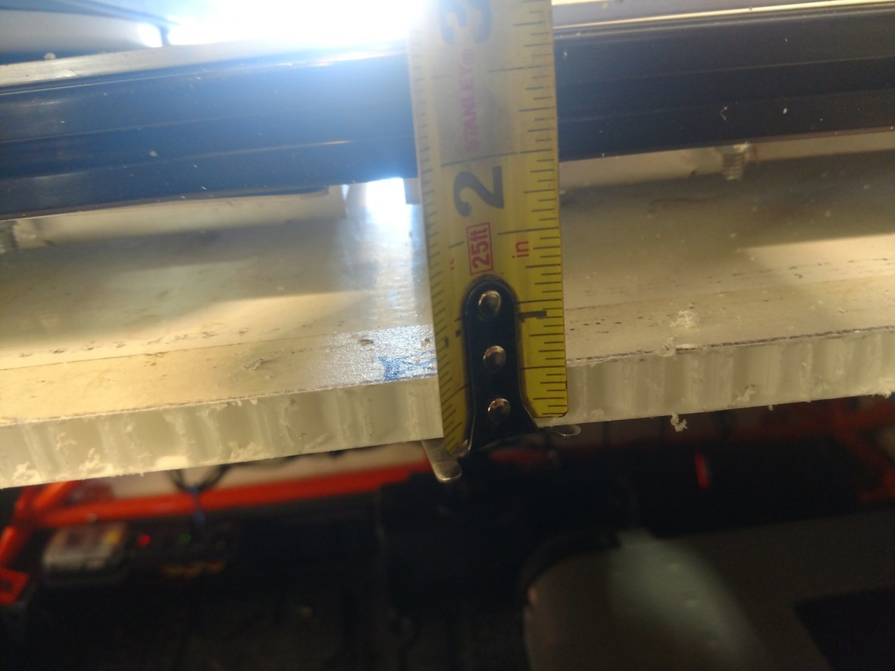

    This is what I’ve been planning all along.
    Only I’m not going to put the plate on the outside only the inside.
    I don’t want to have to seal the extra plate and have more leak potential than what is necessary. However this might need to be done with the 3” bedding and old tent material to help with clearance.
    I’m going to nyloc the bolts on the inside. Plate on the inside will be 1/2” thick to make up for our loss on the what we thought was a 1” roof.
    As far as poking the bed cover, I think the shroud will cover the nuts on the inside.
    I’m just not a crazy about the idea of running a screw into that thin of material on the top and bottom because in the center it doesn’t have anything to grab ahold of.
    Side note: I’m stoked on how much headway we’re making here on this project. Before we know it we’ll all have nice vent fans.

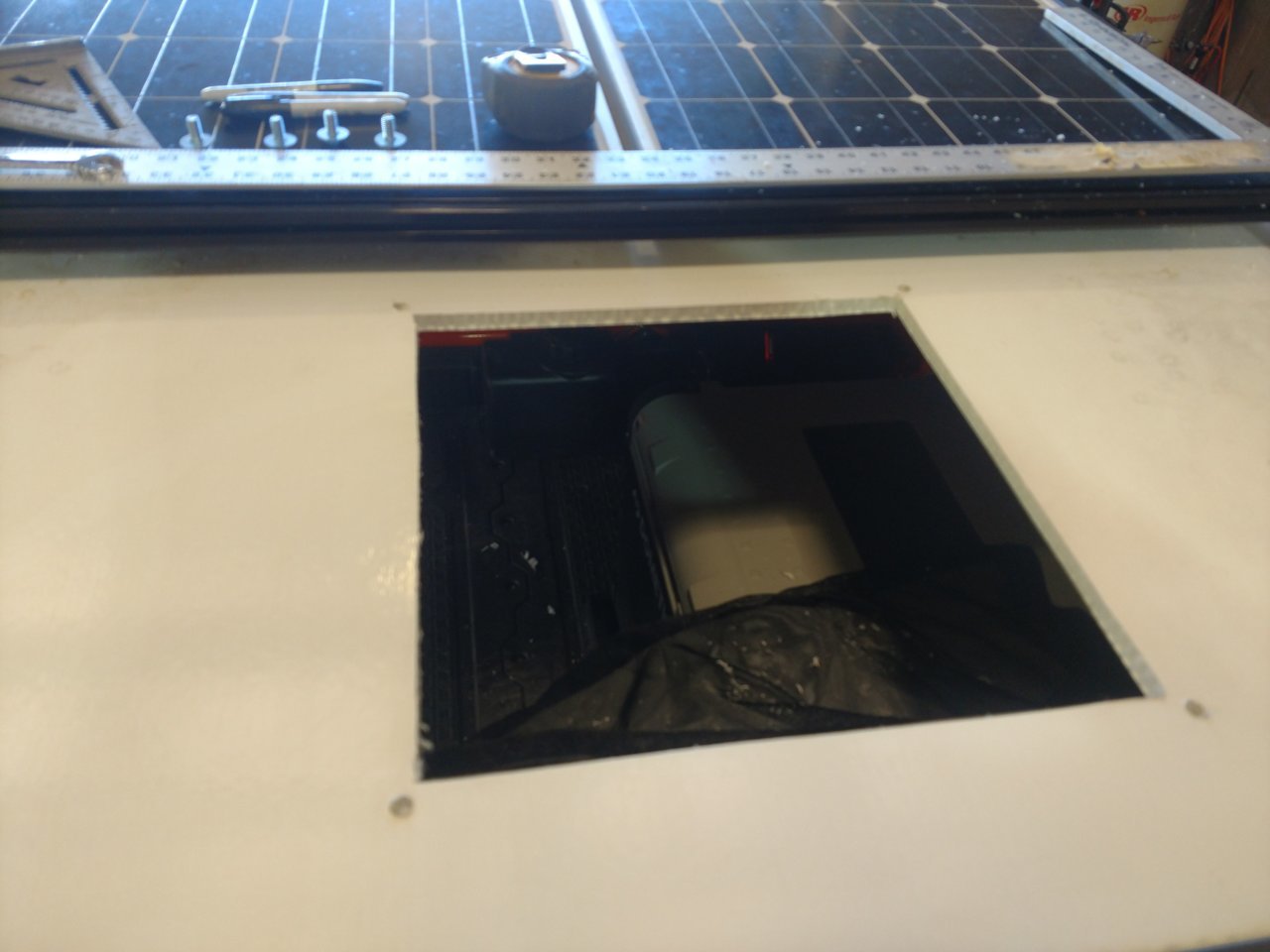

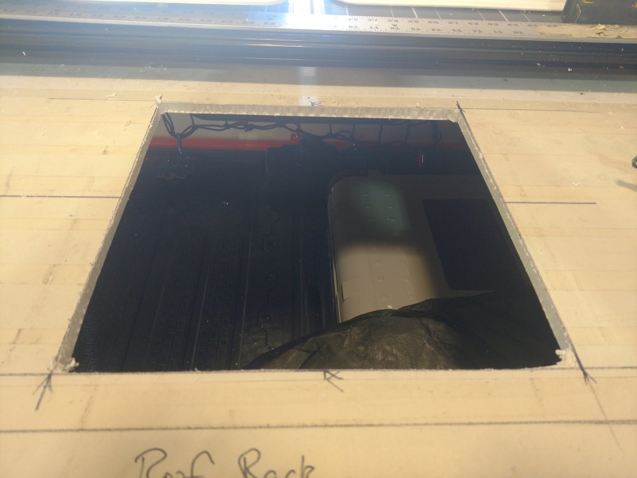

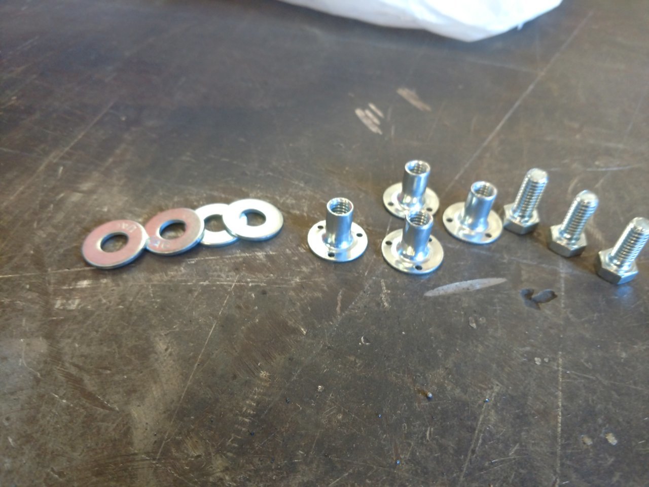

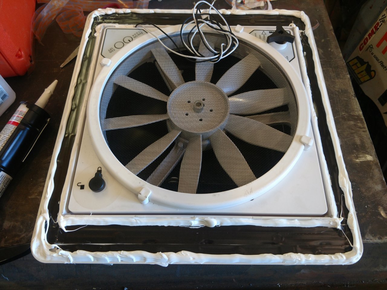

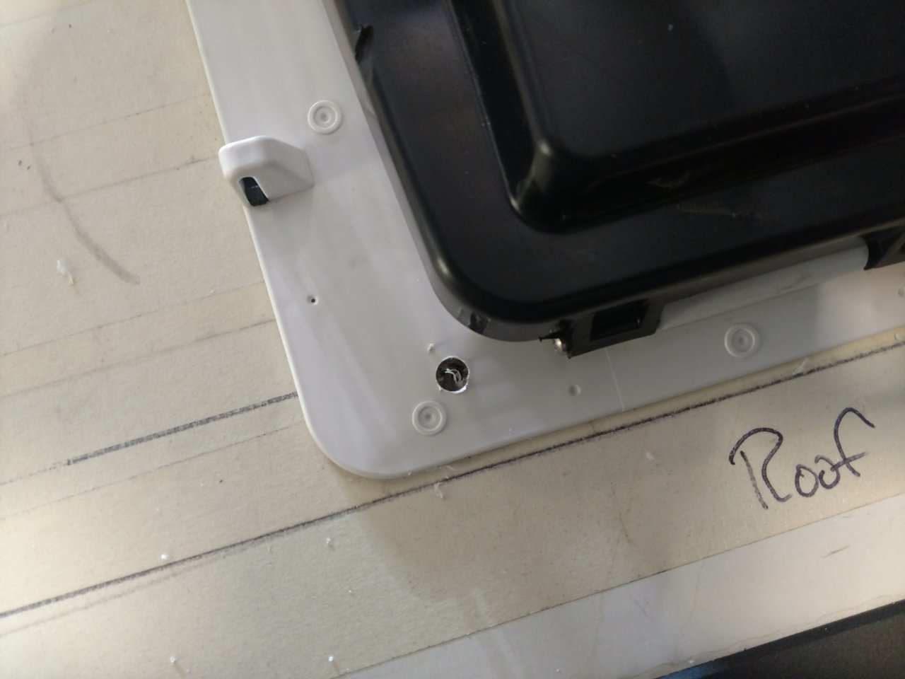

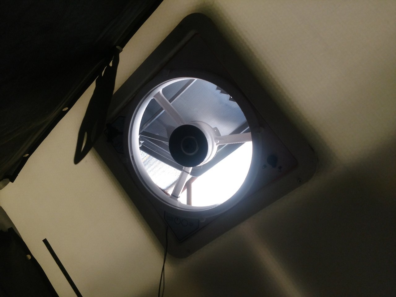

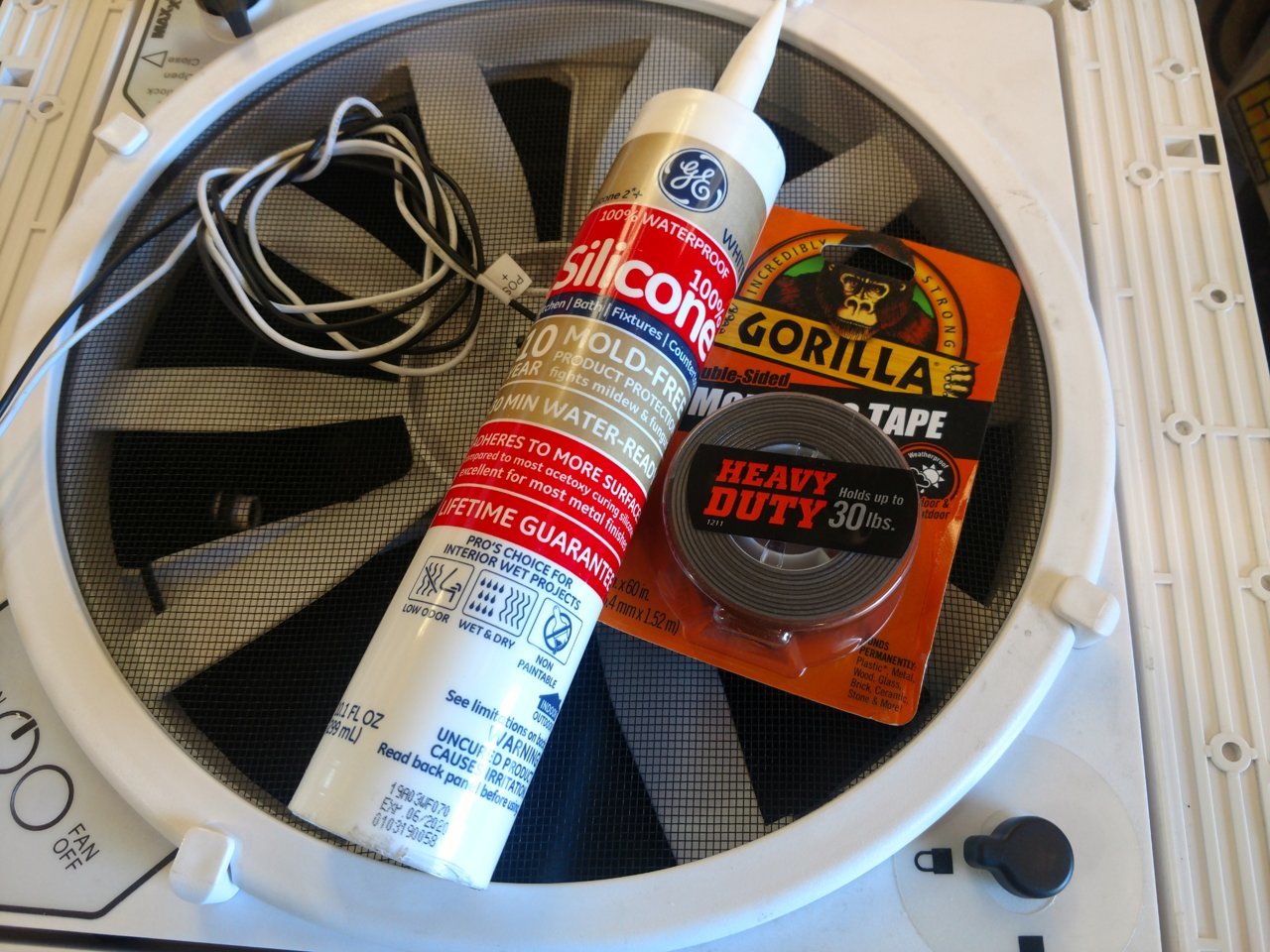

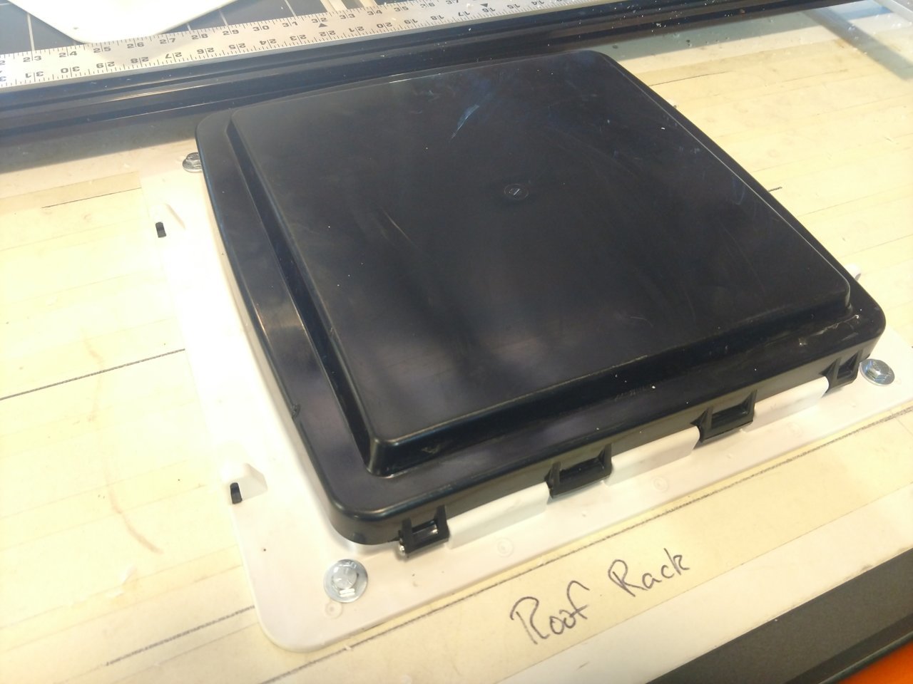

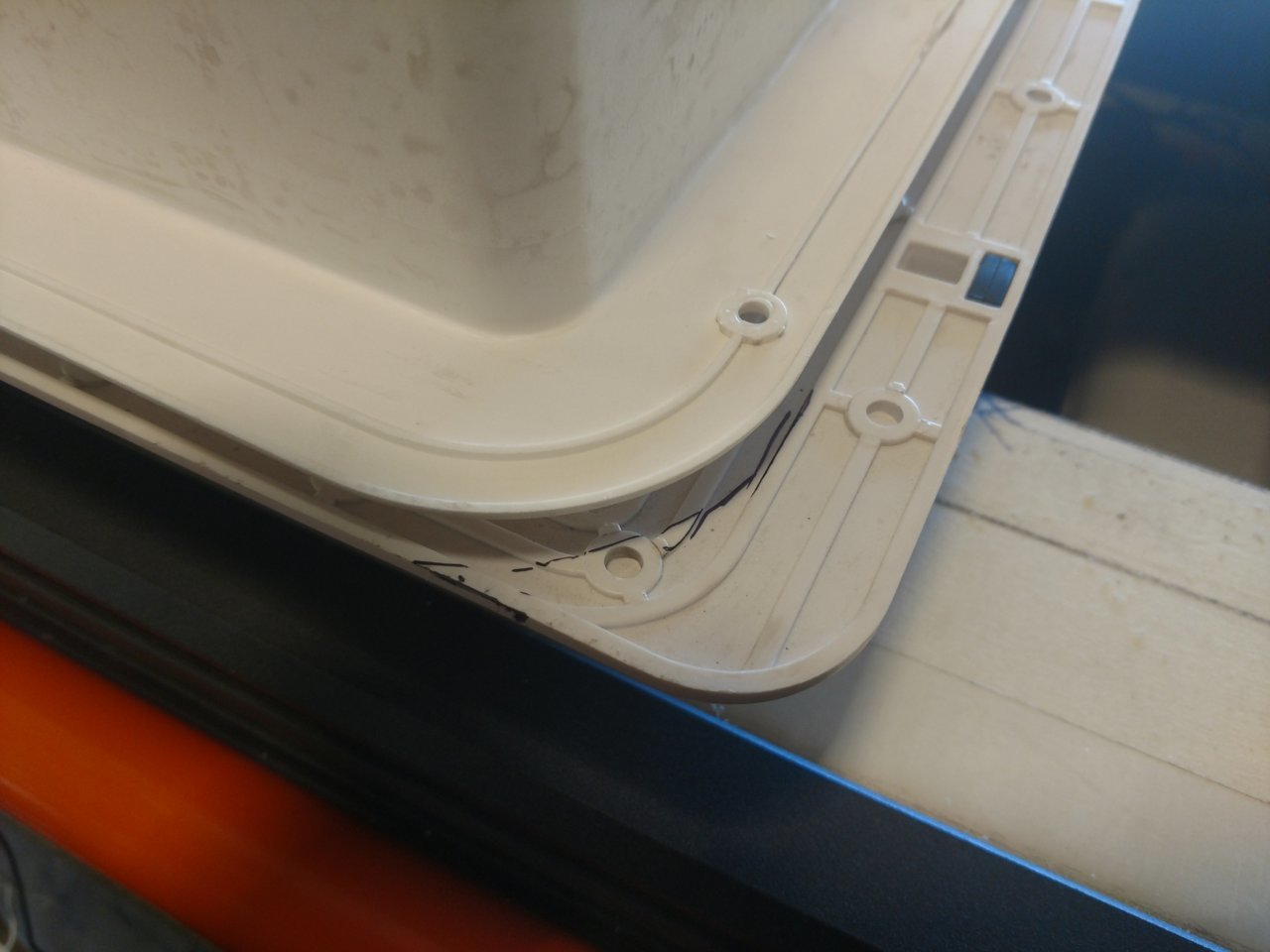

    Here is how I installed the fan today.
    1. Mark the hole.
    2. Cut hole.
    3. Be surprised because you expected 1" thick, not 1/2" thick.
    4. Test fit.
    5. Mark holes for bolts (I marked the fan so the tee nuts would be covered up on the inside by the trim peice).
    6. Drill holes in fan and roof.
    7. Test fit fan and tee nuts.
    8. Remove everything and clean the surface for install.
    9. Install sticky stuff. I used double sided tape and silicone.
    10. Place fan in the hole, put tee nuts in through the bottom of the holes, and then install the bolts through the top of the fan and tighten. (no pics of this, had my hands full)
    11. Clean up silicone mess.
    12. Install trim following the directions that come with the fan.
    13. Wire the fan however you want.
    14. Enjoy fan.
    I also made a wind deflector that I'll install and post pictures of tomorrow.

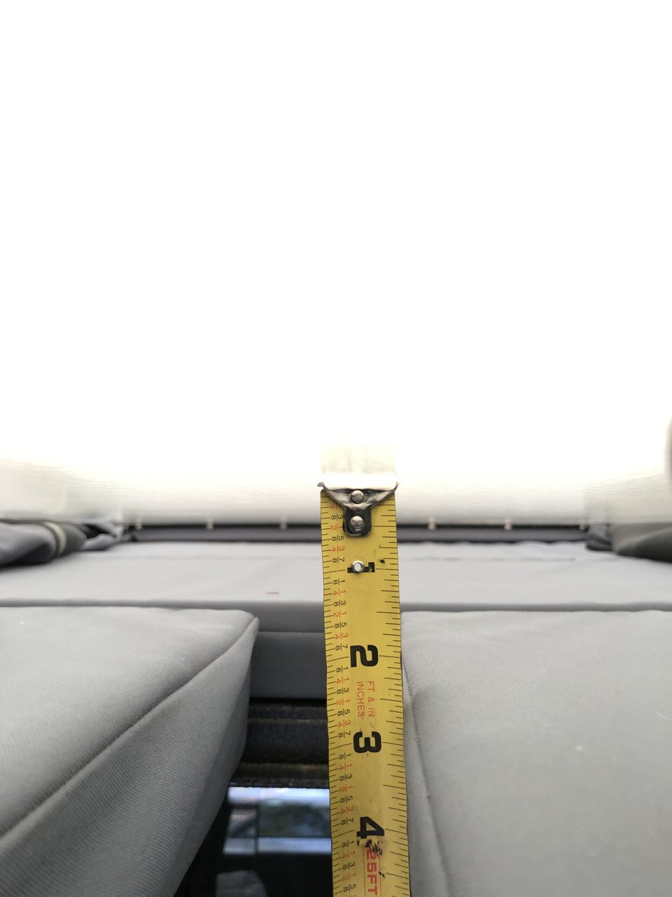

    Holy shite - is that how little material there is with the tent closed? The new tent material must be 1/3 of the rubberized stuff on my '1st gen'. Wow - that really is a game changer. I have to really pay attention to what I'm doing to make sure I can get mine shut. No way there's a spare inch inside there (3" cushions).

    Pretty much. Except for in the rear. I reached into the slot I cut in the two smaller panels and just pulled it back towards the rear a bit.

    Seems like with the new fabric/panels you can just stack the rear panels to the middle and move the middle mattress to the front of cab area so you can leave the entire fan area open for ventilation while closed.

    The smaller panels are actually around 3” thick I believe. 2” of foam and 1” of honeycombed plastic.
    If you think about it most of the fabric actually stacks towards the rear since that’s where the highest peak is and most material.
    There is only about 2” in the middle section between mattress and panel. Smashing it down another inch with fabric would be too hard. I will be able to run it closed if I ever need to since I cut 2” of each smaller panel.

    Maybe you misunderstood. Take the 2" mattress on the middle panel and should be ~4 or so inches of room and place the squares on top of the black rectangle panel. Then put the rectangle mattress on the cab over portion. Pretty sure that works if that measuring tape is right?

    It might fit but then you’d have nothing to keep the tent fabric from dangling down in the bed.
