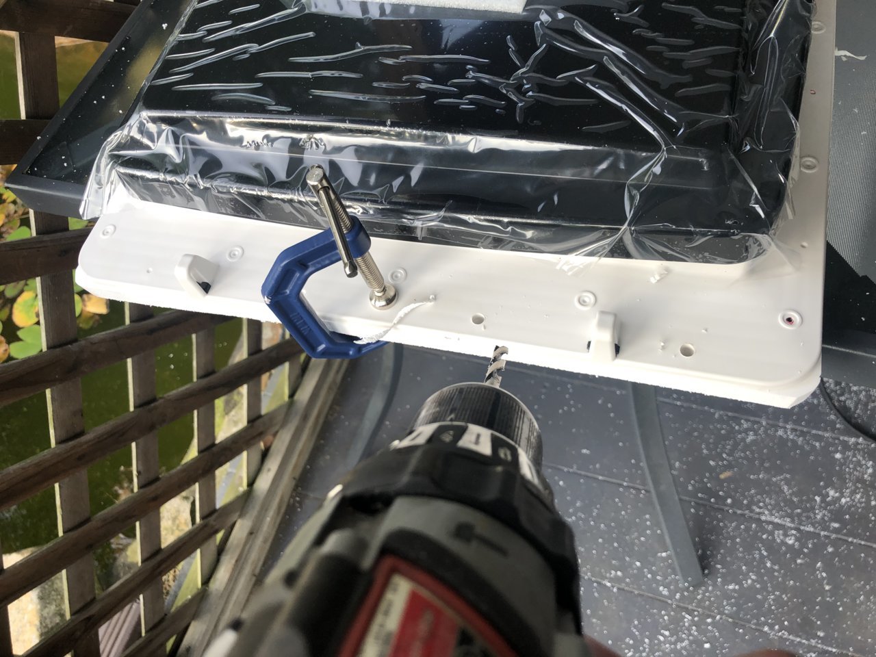

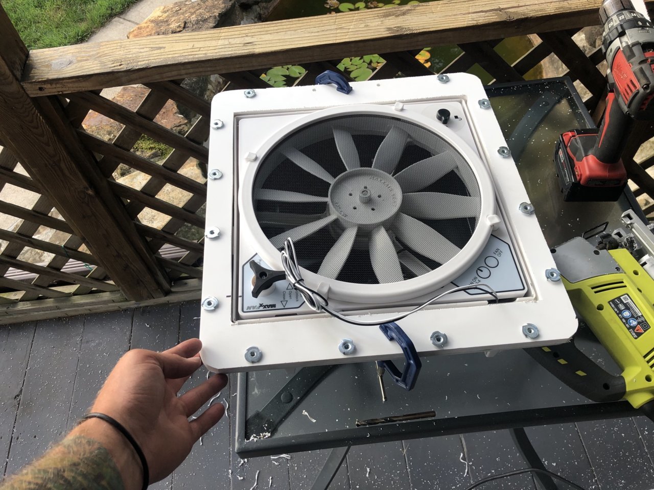

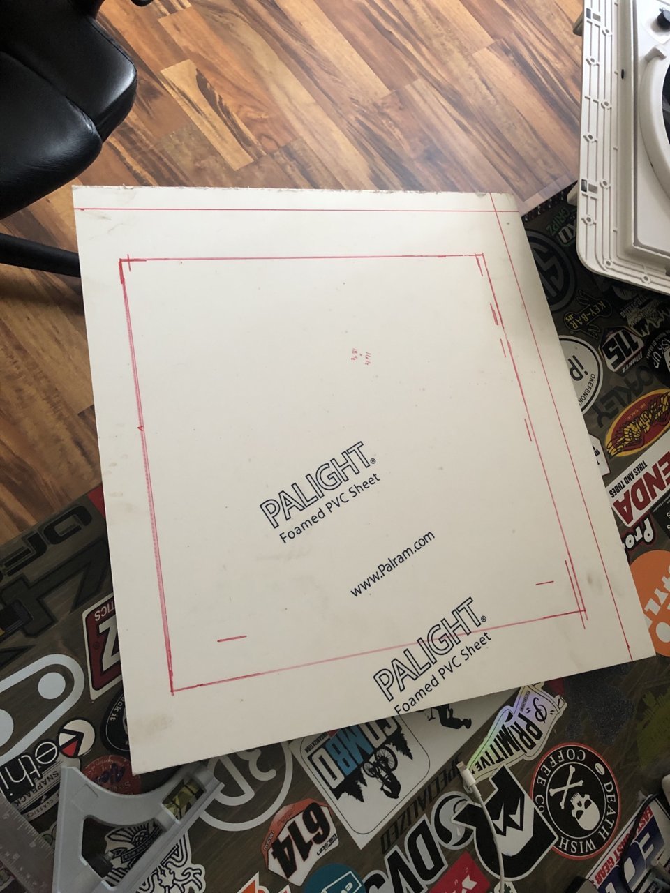

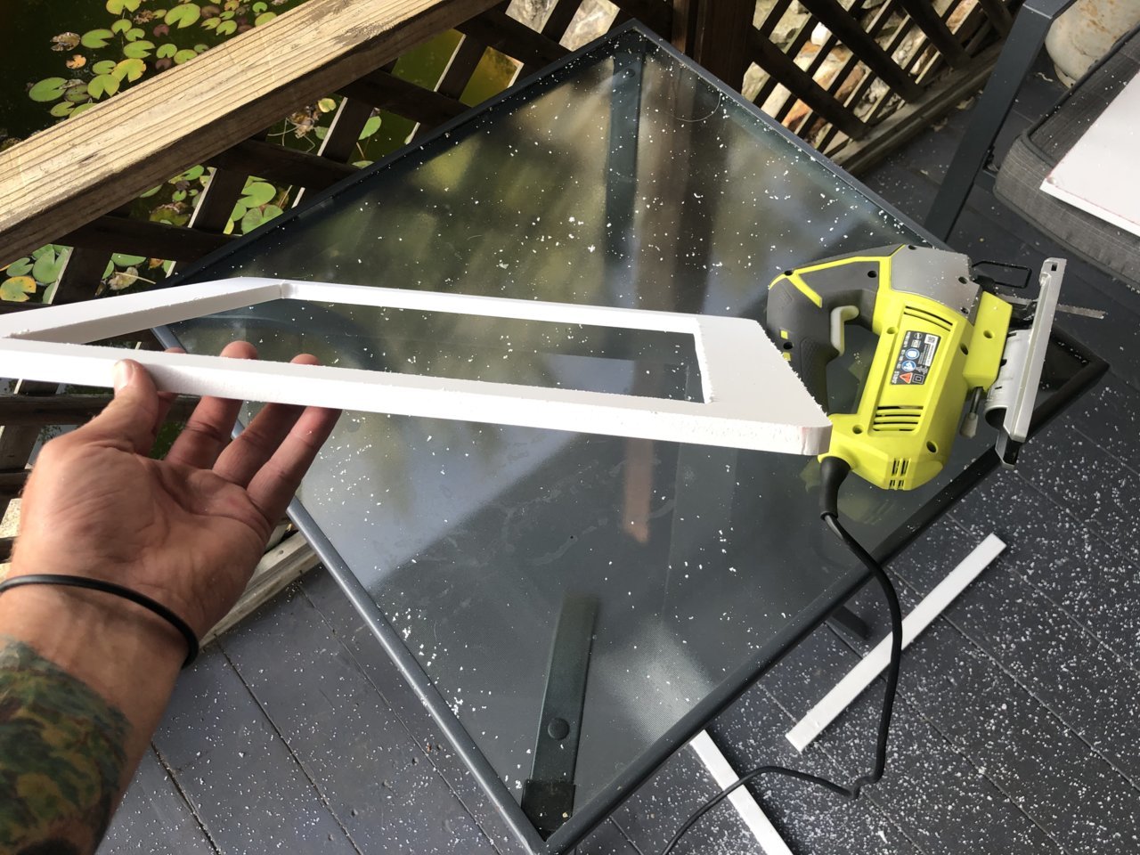

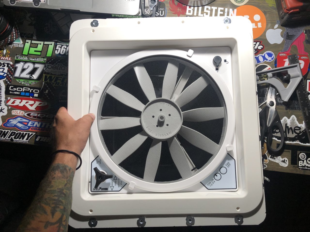

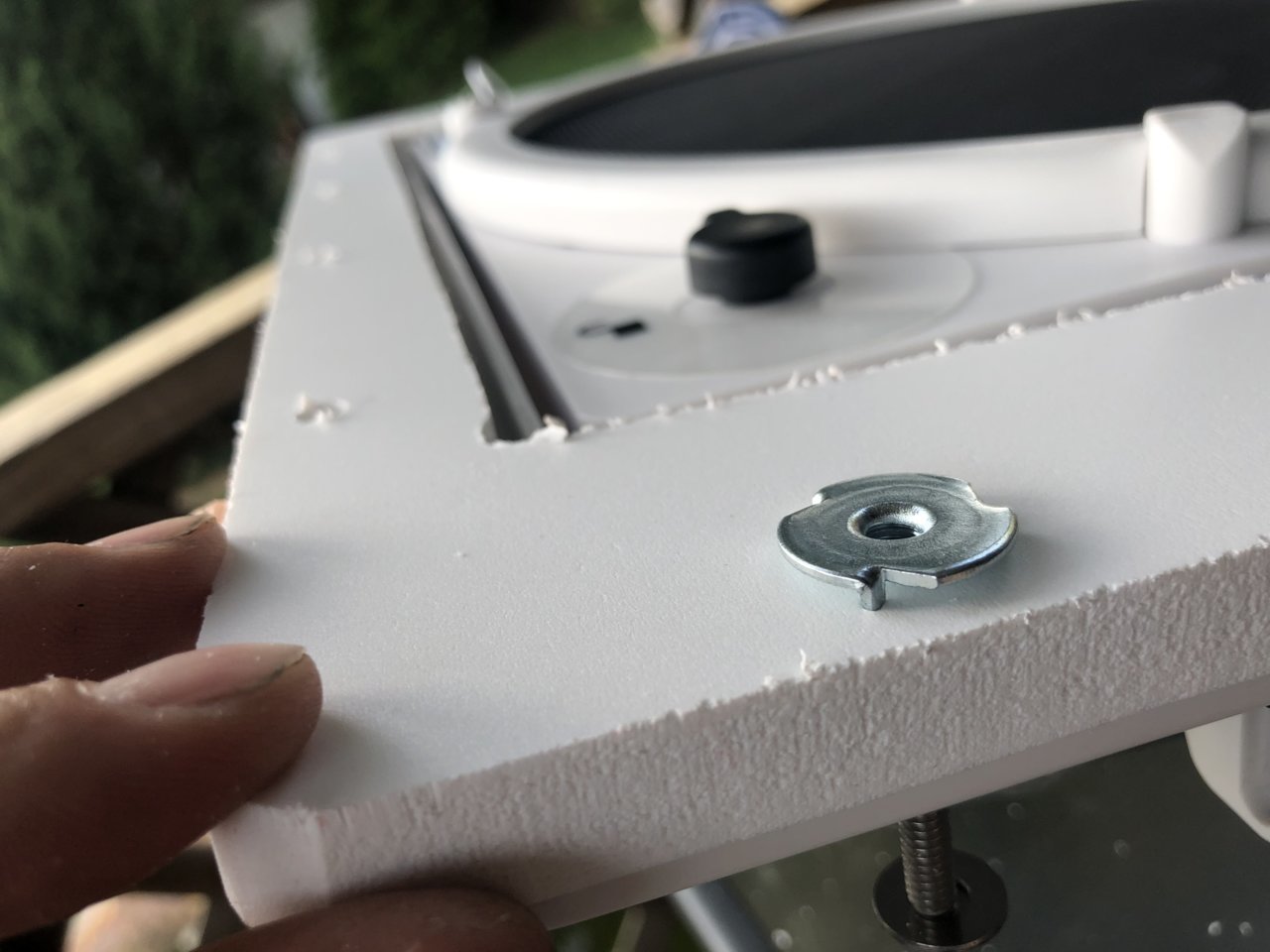

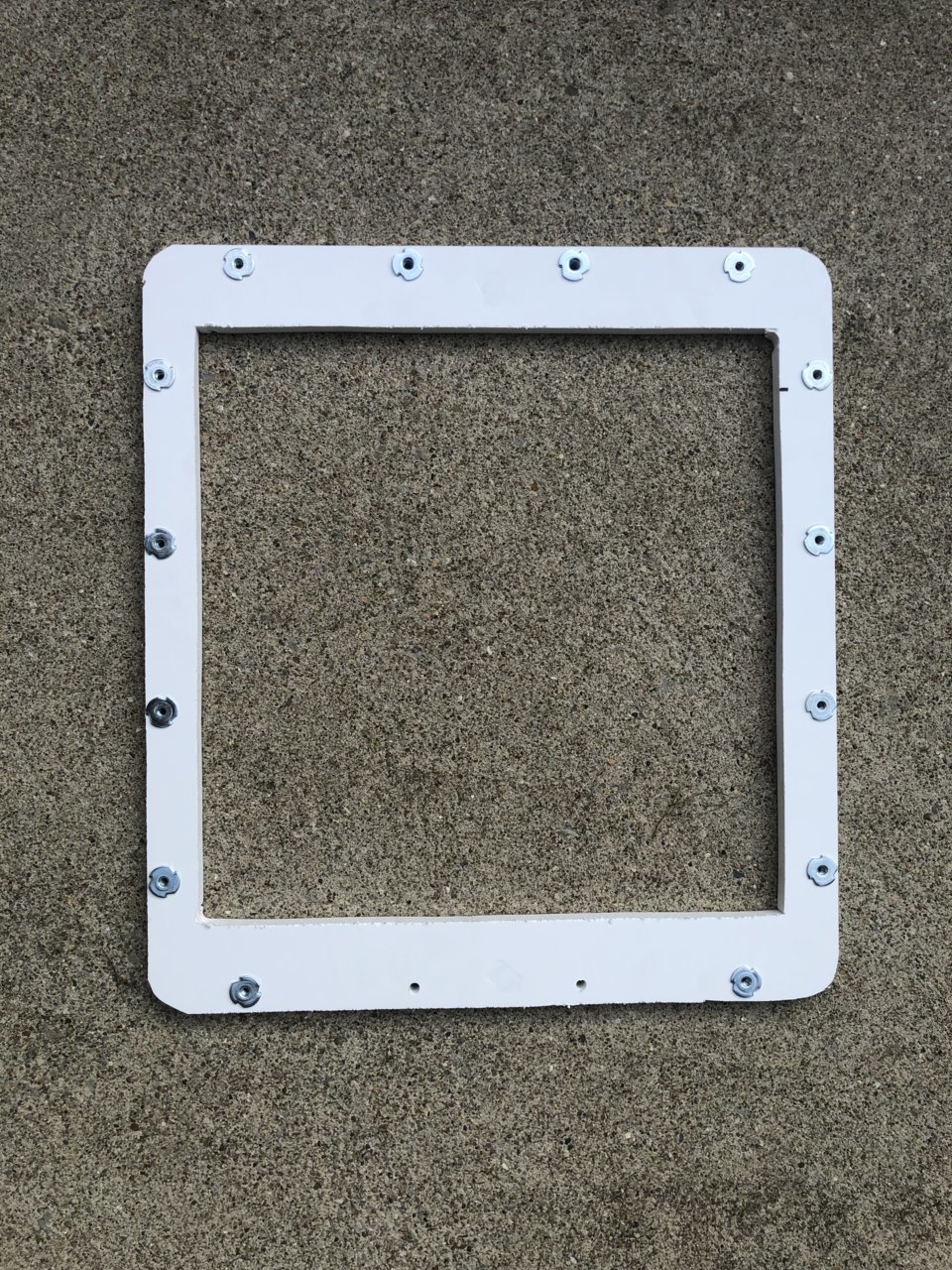

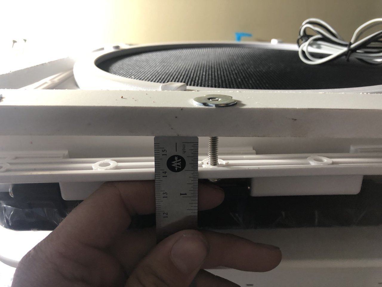

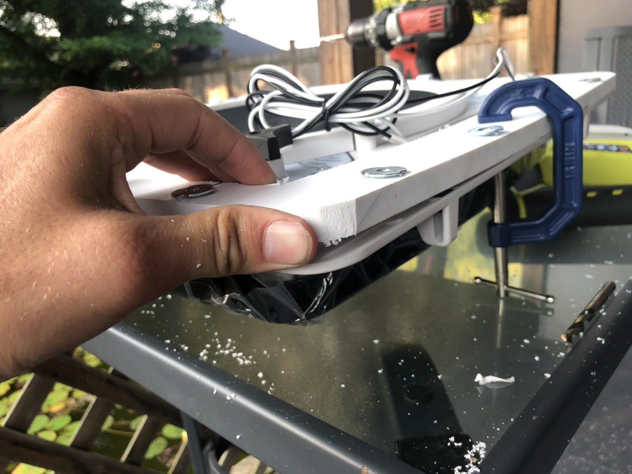

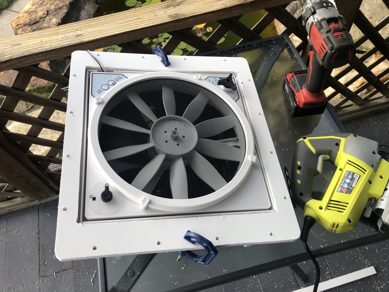

    Are you guys sick of fans today?
    I made a little progress on mine.
    The 1/2” thick Foamed PVC is going to be my spacer for the inside and support to through bolt.
    I stole your T-nut idea @STravis. Seems a hell of a lot better than nuts and washer on the inside. Plus they drove into that PVC real nice!
    I’m planning on using 10-24 x 1 1/2” bolts but I’ll see if that’s enough once I get the Butyl Seal Tape on and squished and in the roof. :sawzall:

    It will cover nuts on two sides but it won’t on the other two.
    The shroud is a perfect square and the fan isn’t. It’s like 2” wide on one side and 1 1/2” or so on the other.
    The shroud will be flush with the bracket and be 1/2” off the inside roof. I’ll just have to live with the nuts showing.
    You could put the bolts closer to the center if you wanted then it would cover them. But I just went with the already marked holes in the fan for a wider footprint.
    @STravis moved his towards the center.
    ace7196[QUOTED] likes this.
  15. Jul 9, 2019 at 7:23 PM
    #575
    STravis
    STravis Well-Known Member
    Feb 2, 2010
    #30597
    1,642
    Travis
    Ruidoso, New Mexico
    2012 TRD Offroad
    That looks awesome :thumbsup: you shouldn't have any issues.

    I guess if I used these the shroud will cover all the nuts and I could cut down the bracket some.
    I might do that. Even though I already drilled out the outside holes. Nothing some sealant can’t fix. Haha.

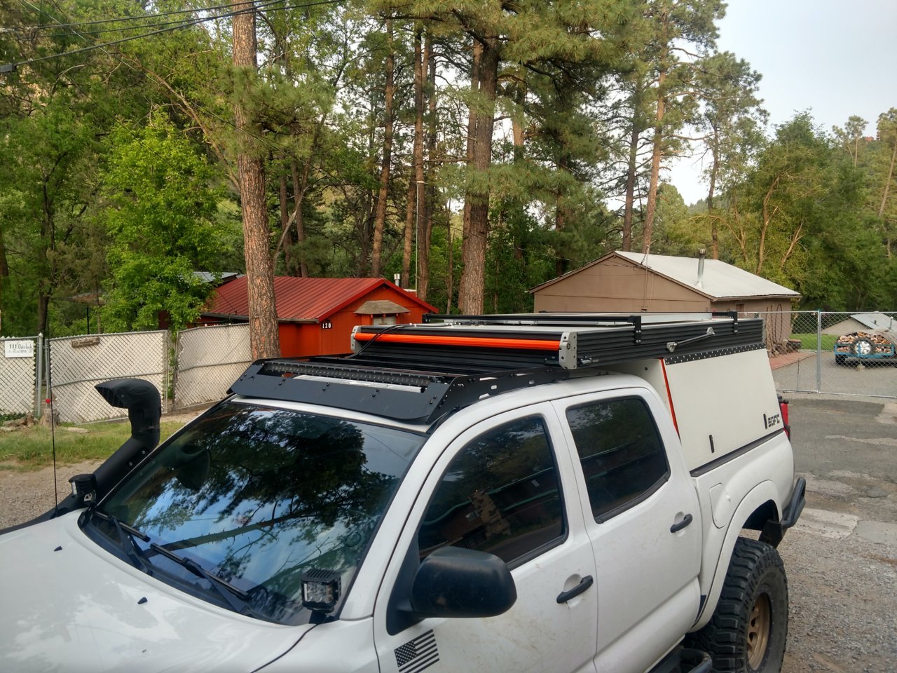

    I'll get a picture of how much of it sticks down below either tonight or tomorrow night. It's not terrible. The shroud was a little tricky because it bells out towards the end and didn't fit perfectly. I'll order another shroud and do a little better job but as it is now it looks fine. But as far as mounting the fan directly to the 1/2" roof, there is no problem with doing so.

    @ace7196 im just making the bracket for more support I guess.
    I might even ditch it and just do what @STravis did. Not sure yet.
    But I know what you mean by the shroud belling out at the end once you trim it all the way down.
    I think I’m going to cut the part that fits into the fan vertically so it splits to give it more play.
    ace7196 likes this.
