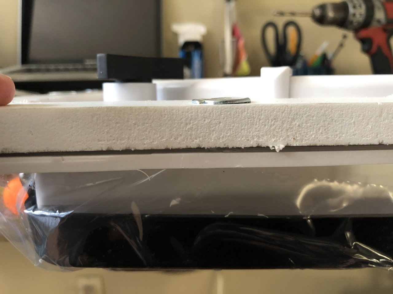

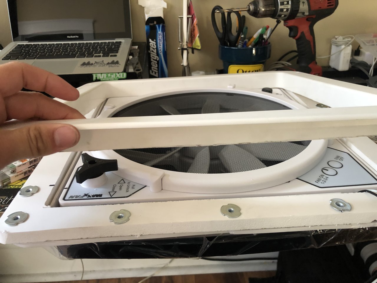

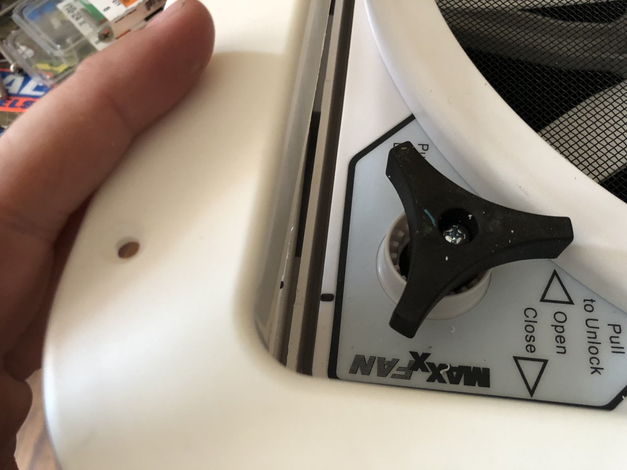

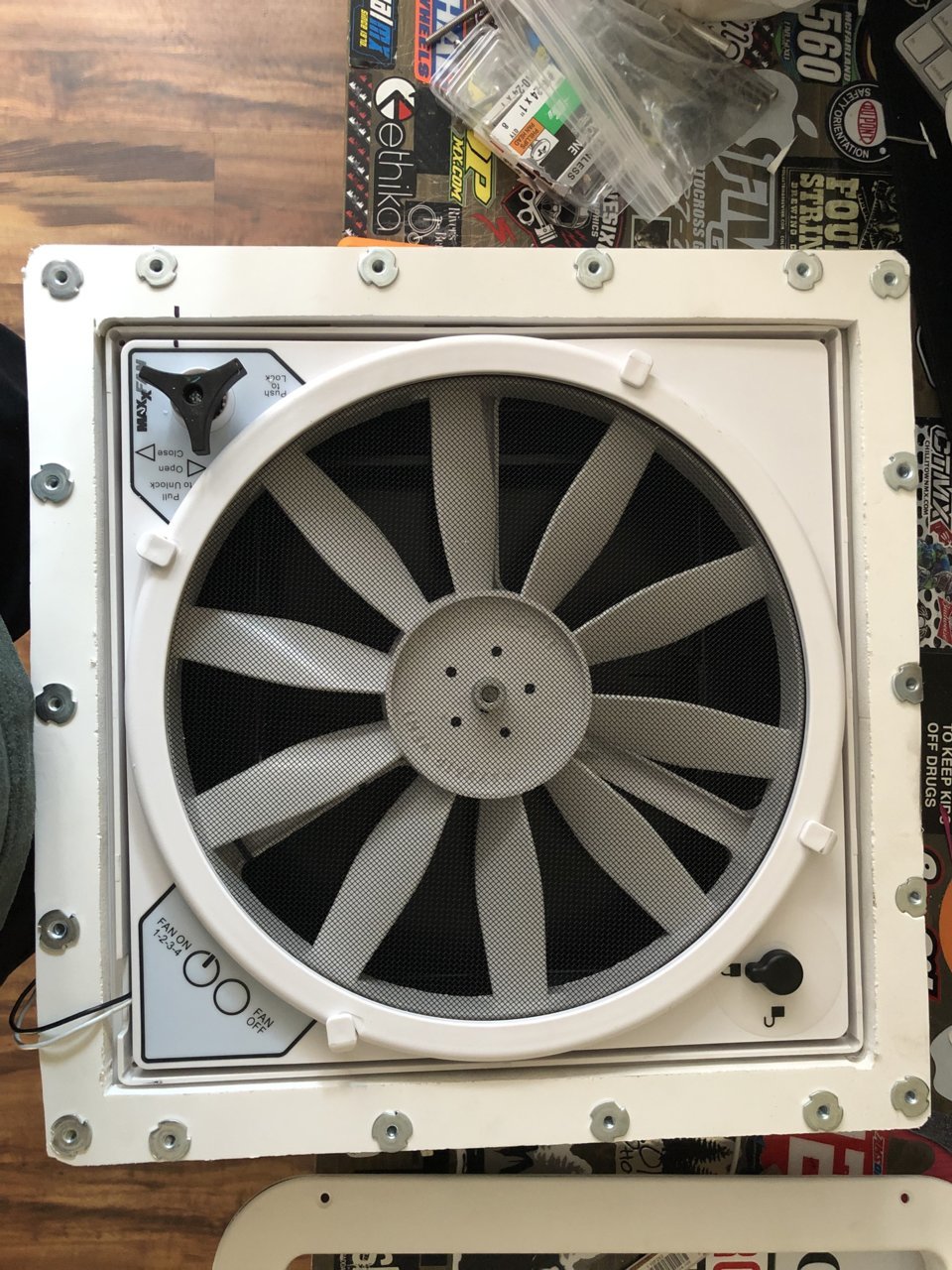

    I’m starting to think @STravis has a better idea. The bracket probably won’t really be needed.
    I drove a T Nut into the extra piece of honeycomb I have that I cut off my bed panels and it holds really well in there.
    The hard part is now the shroud.
    I’d probably recommend the Tnuts with spikes though just to help aid them from spinning. They drive in rather easy.

    That’s basically how much will stick out on the inside after you go through the roof.
    My bracket is 1/2”. Him thinking about ditching it now. It’s one less thing to worry about.
    The shroud is the hardest part because of the way it bells when it’s cut that short.
    (Trying to provide as my pics as I can. Sorry if it gets annoying see the same things over again. I apologize.)

    I agree with needing the tee nuts with spikes. I had to grab somebody to hold the bottom to keep them from spinning when I installed mine.

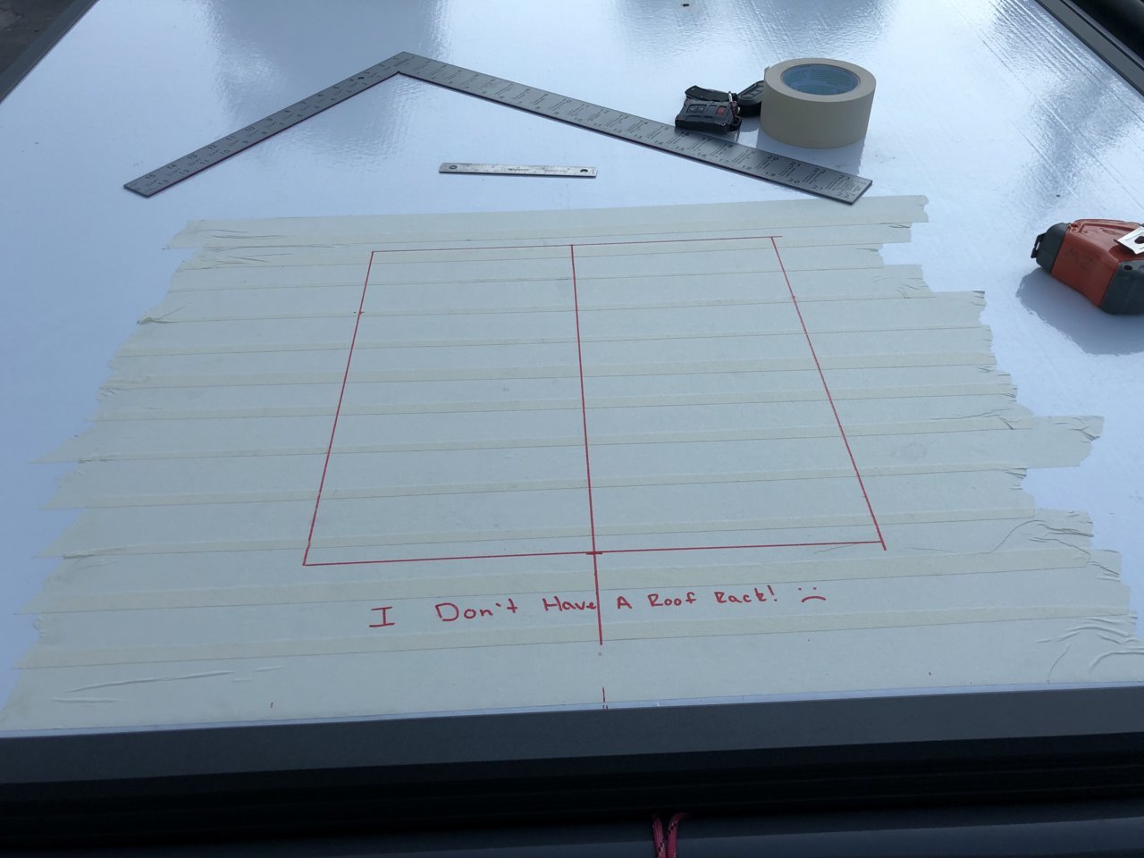

    Tape is on the roof and marked out. I ran out daylight tonight. Maybe it will be in tomorrow.
