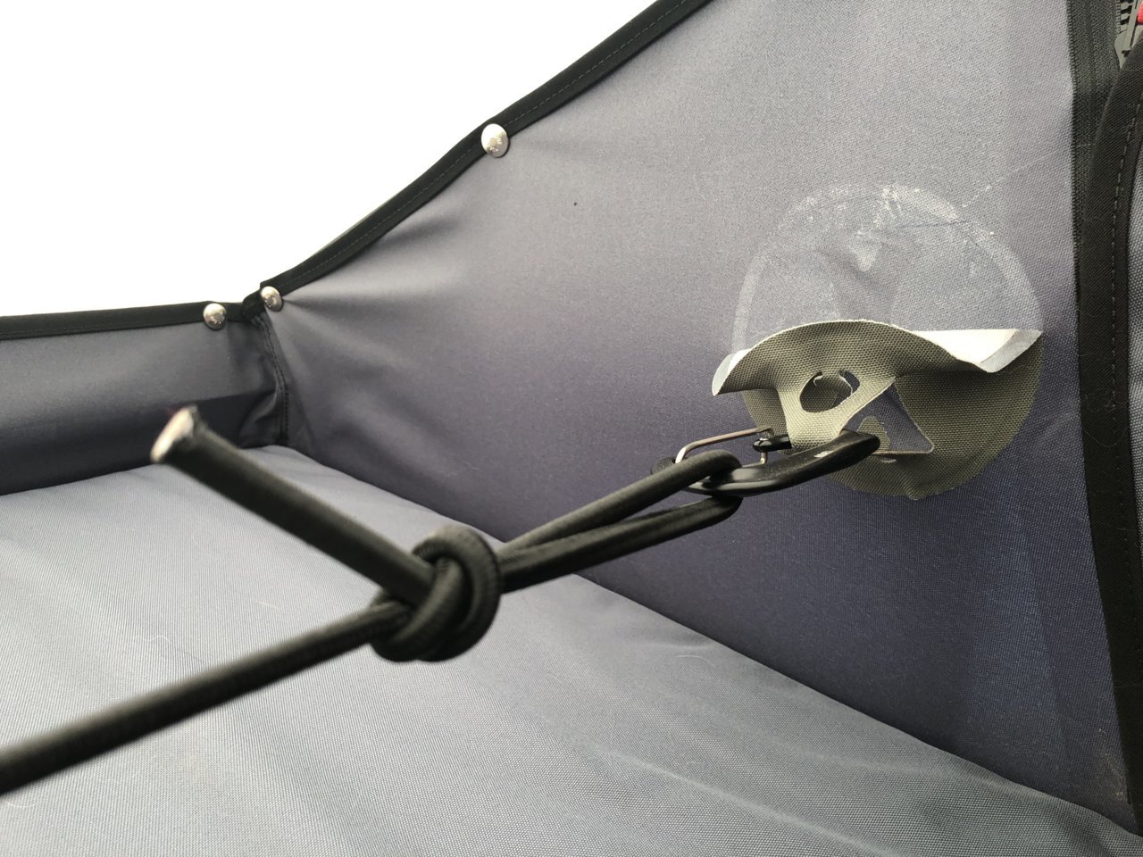

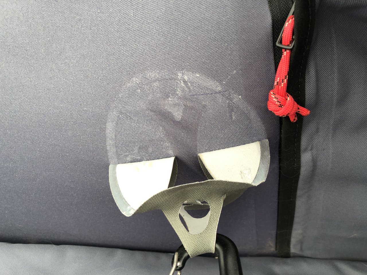

    I also have the pinholes and more. These small holes, over time, will result in the fabric failing in this area. I think that the zippers should have a double layer of cloth backing because they're a stress point. There should also be stitching and they need to find a better glue. I mention the glue because the fabric disks that support the forward bungee are coming loose to the degree that I don't use the bungee anymore. There needs to be more layers of cloth backing the disks because it's a another stress point.

    New material? If so they stopped putting the disks that pull the tent material in so I’m told. They didn’t do many and the glue didn’t hold on the new material as well as the OG tent material. Mine come unglued within a few weeks.
    I tore them off. Those bungees aren’t needed with that material and 2” mattress anyways.
    It’s pretty ugly now but fuck it guess.

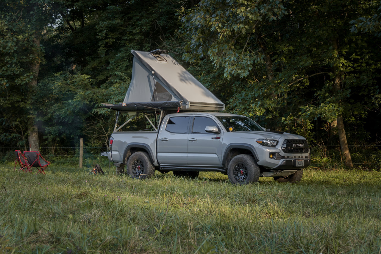

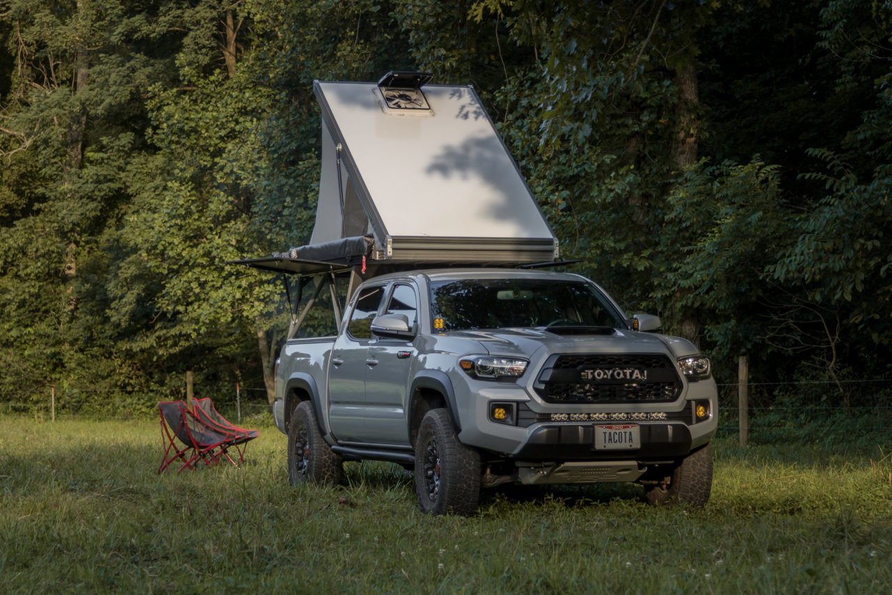

    Finally had time away from work and a night that wasn’t hell hot to get out and test the MaxxFan Mini for the first time.
    Though I still haven’t added any batteries to my setup other than my X2 Power Group 31m 100AH start battery I thought I would give it a try anyways. (Took a jump pack just Incase)
    I unplugged the Dometic CFX28 for the night and ran the fan on speed #2 which seemed most comfortable.
    It’s amazing! The noise is very much tolerable and the amount of comfort it give us vs. not having it was simply amazing.
    We slept with both side windows open, the rear window was half way up. We closed all the side panels and rear doors except we latched the rear of the two side panels while open so it left a crack. (Like Graeme shows in the video about ventilation for a dog.)
    The air moving through the 4” gap I chopped in the smaller two mattress panels gave us exactly the right amount of air flow we were hoping for up top.
    Everything outside was soaked with dew this morning. (Around 63°F I believe)
    Tent was 100% dry inside. No more rain coming from the inside of the roof like we had experienced before.
    On another note:
    Sioux-Boy didn’t sleep in the bed like we had hoped. He was far too precious last night not to bring up top and snuggle. I buckled under those puppy dog eyes and brought him back on the top bunk. :)
    We camped on a friends very large cow farm in the pasture in rural southern, Ohio. Had s’mores and vodka/lemonade.
    EDIT: Didn’t wake up with a dead battery. Still had 12.4v.
