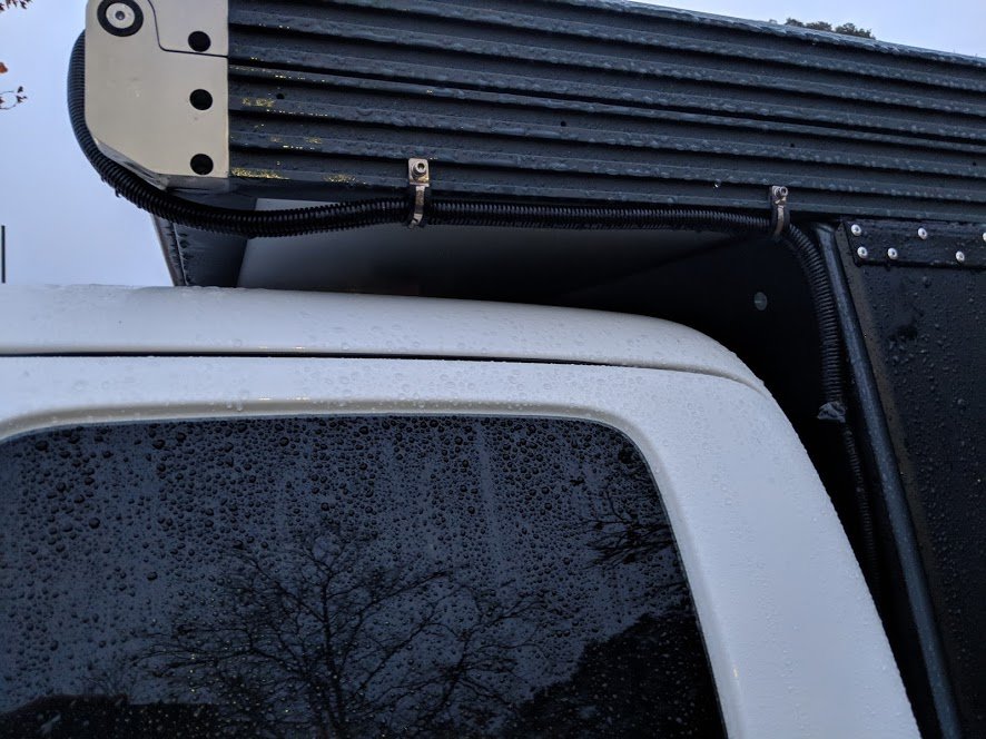

    Mine looks nearly identical (sans the wire loom). My house battery is in the bed, so I drilled a hole in the bed next to the drain hole and routed my cables up through there. I then used a couple large rubber washers, one in the bed, one under the bed, with some good exterior tape to keep the elements out.

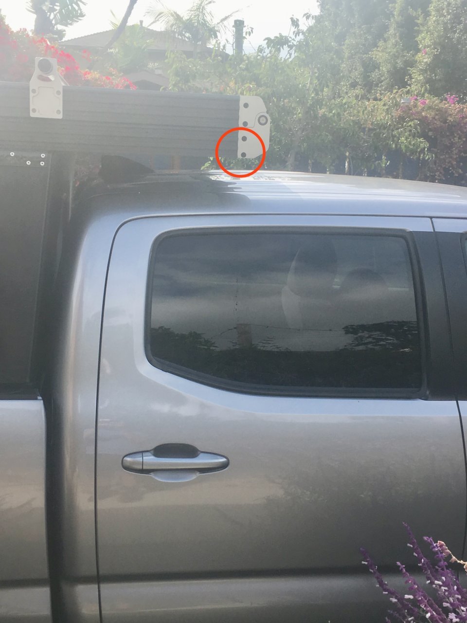

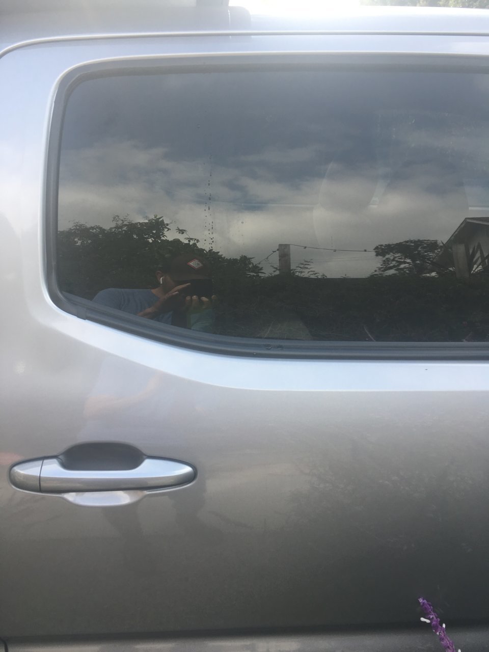

    yep, even worse is when you open one of the rear doors and it all spills out onto your seats!

    I had this problem as I was living out of my gfc this summer. I ended up putting a bead of silicon caulking on my cab to direct water away from the door. Once I returned to building life it comes off very easily.

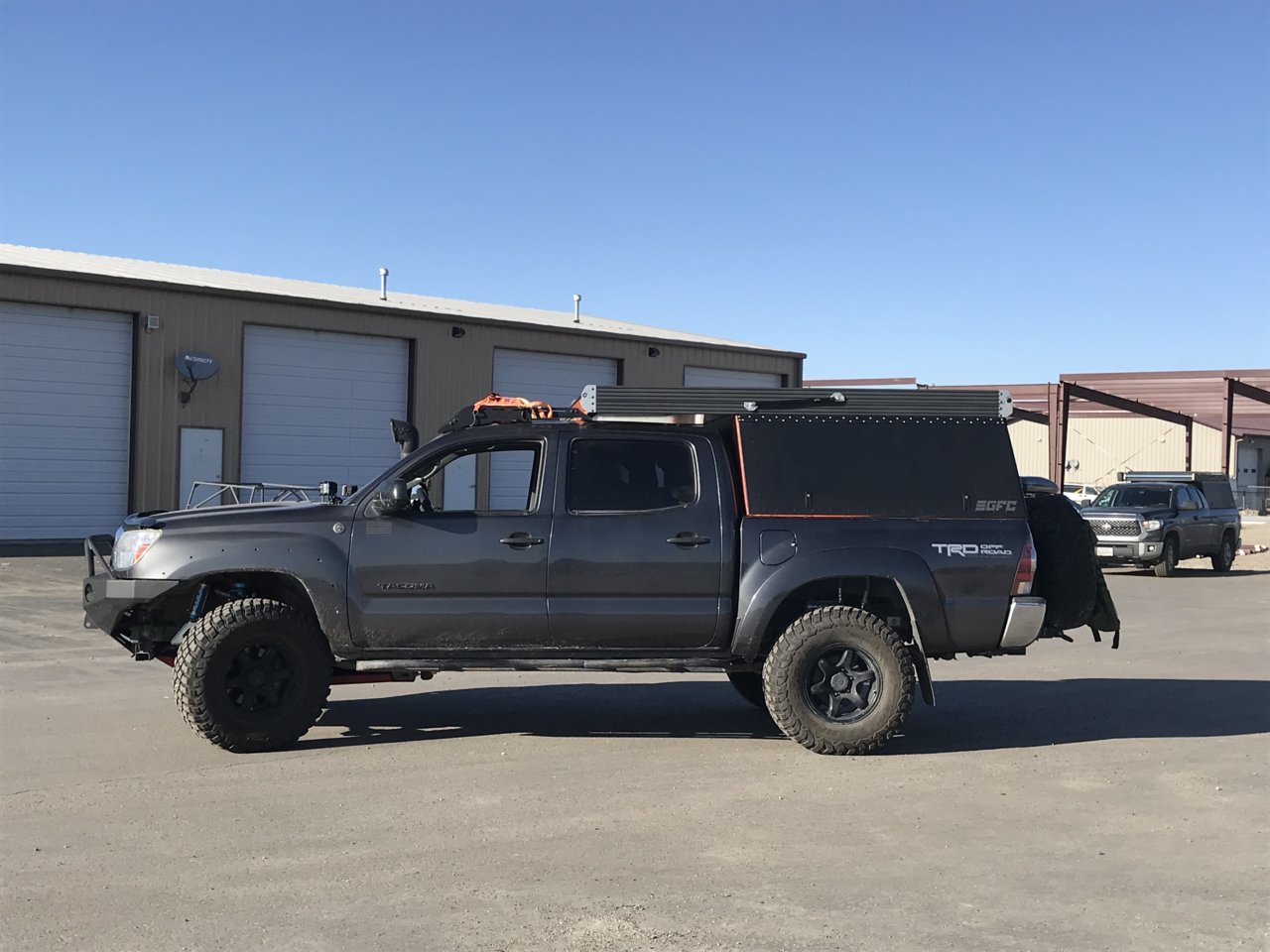

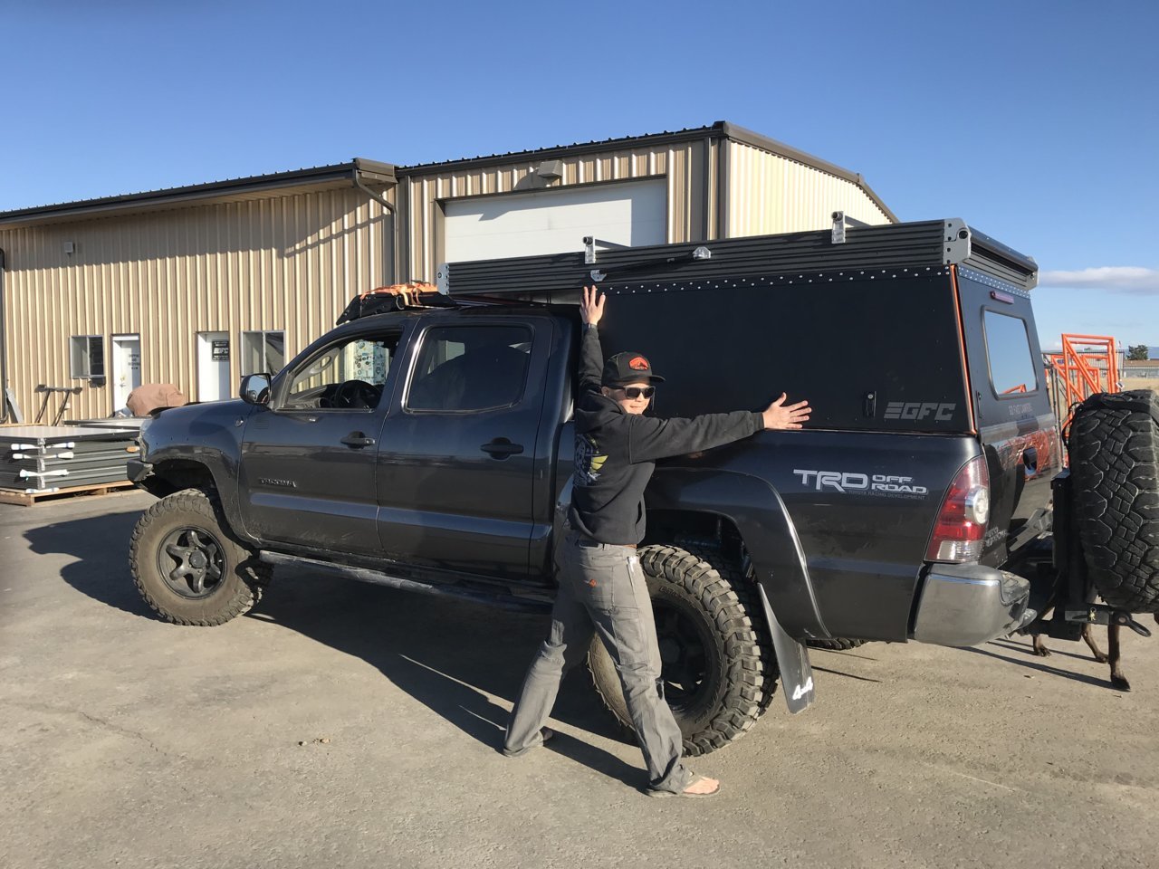

    Got mine installed today (#399) by Mattias and John. Drove 19 hours straight from Santa Barbara, CA to Belgrade, MT with stops only to pee and get gas. What a drive! Loved the shop. Super cool place, lots of rad people working on these campers in a beautiful place. And the shop dogs are awesome too!.

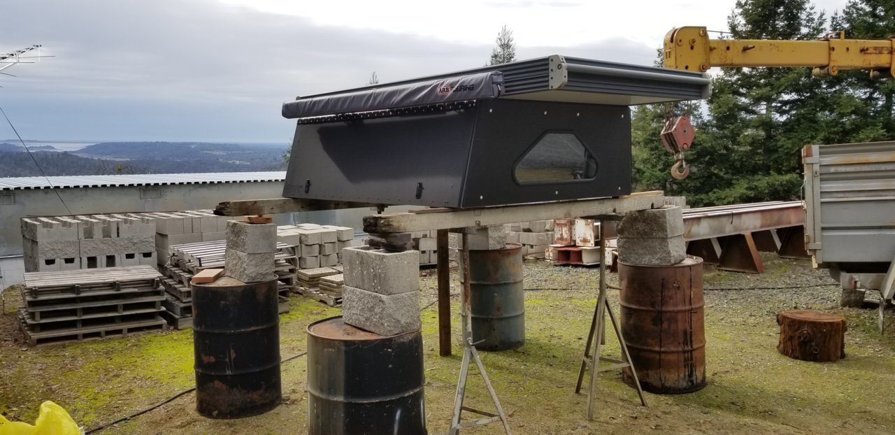

    I don't take it off regularly but I did take it off by myself one time. Kinda bubba but it worked, basically a bottle jack in the bed and some wood scraps. Get it up high enough to get some 4 bys under and extended out the sides. Rig up something to support the 4 bys and drive away. I then got some stands under there to support the weight and strapped all together. Did survive a 50 mph wind and rain storm and does help to have a second person to guide you back in for reinstall.

    I love it, but have to ask- would the crane thing in the background not be easier?

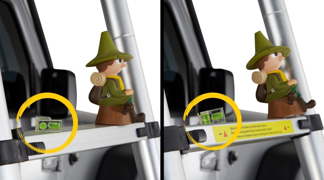

    So iKamper makes the Skycamp 2.0 which has ladders with steps that are level
    anyone have or know a ladder similar to this?
