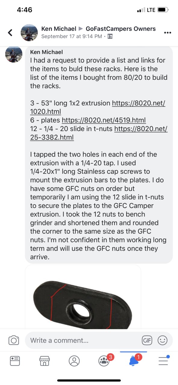

    Apparently, I can’t search... does anyone have the link to the diy 8020 beef rack handy? I can’t remember the part number for the side plates.

    You probably need a plate like this but would need to verify what series extrusion the GFC side matches. https://8020.net/4518-black.html

    Found this screenshot I took a while back. It was on the GFC Facebook Group page that you created. Haha.
    I tagged you in the post.

    Thank you 2ayne! Too many places to look! I’m glad you remembered!

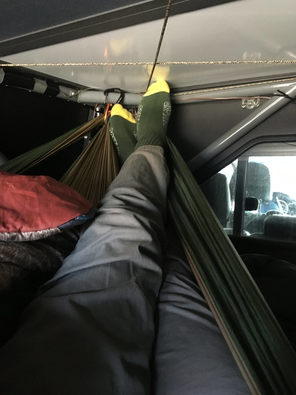

    Monday lunch break snooze in the work parking lot. Didn’t feel the need to pop the top. Yes a hammock fits, but barely

    I have considered this but haven't tried yet! Nice!
