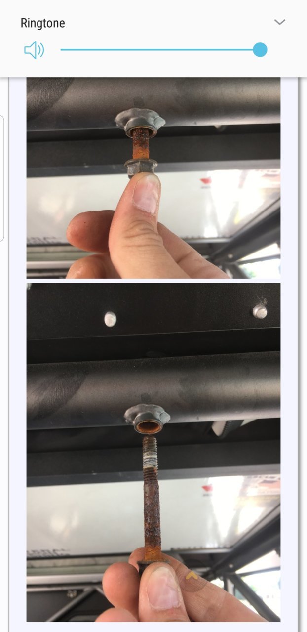

    How yours been holding up if I may ask mines in power coating and I'm kinda curious on how the newer campers doing I asked about the rust in the fram they kinda answered but more or less told me it was a one off incident how your been with all the being issue resovled

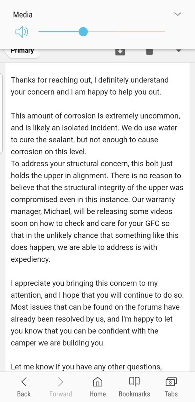

    How did spraying all the holes for corrosion work out I wondering if I should do the same this is what gfc told me but I'm still thinking it's from condensation building up in hallow tubes

    Why would condensation build up in the tubes? Condensation occurs in the tent because a human is breathing out moist air that then contacts the cold fabric and condenses.
    The moisture in the tube is from water wicking up the bolts or entering other pathways into the tube. The problem is once it's there it has no easy way back out and will stay there. It's not an uncommon problem but definitely should have been anticipated and steps should have been in place to prevent it.

    Idk man I thought that shits from moisture in the air I just assumed hollow cold pipes in a really humid place caused it like have a buddy heater inside warming up the topper but being by a lake in the winter like in Minnesota. I haven't even seen this thing in real life so I dont know how its intact and put together I look up mods in anticipation since it's almost complete next thing I know I'm in a rabbit hole about issue idk existed a month ago I been read n guessing nonstop so I guess on this issue to cold air wet air get trapped in the the tude then warms up inside n releases the moisture

    The hollow pipes are welded together and capped off. There shouldn't be any air exchange from outside to inside.

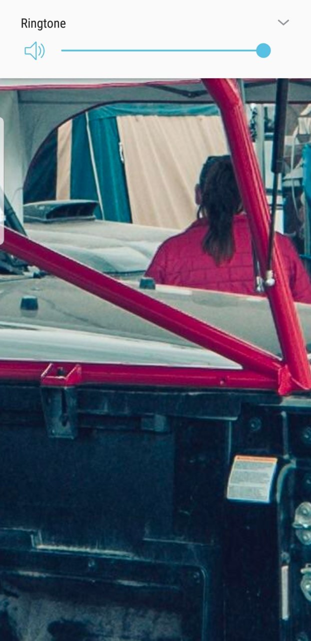

    Ok cool thank you I was just guessing on stuff I was thinking humid air could pass thew since they have pre drilled holes since hot air rises you know travel up the tudes were its cut n the hollow pieces are connected kinda hard to judge sealing off just pictures cold air in warms up releases water on top of frame were bolts are u see were I went down the rabbit hole on this one
