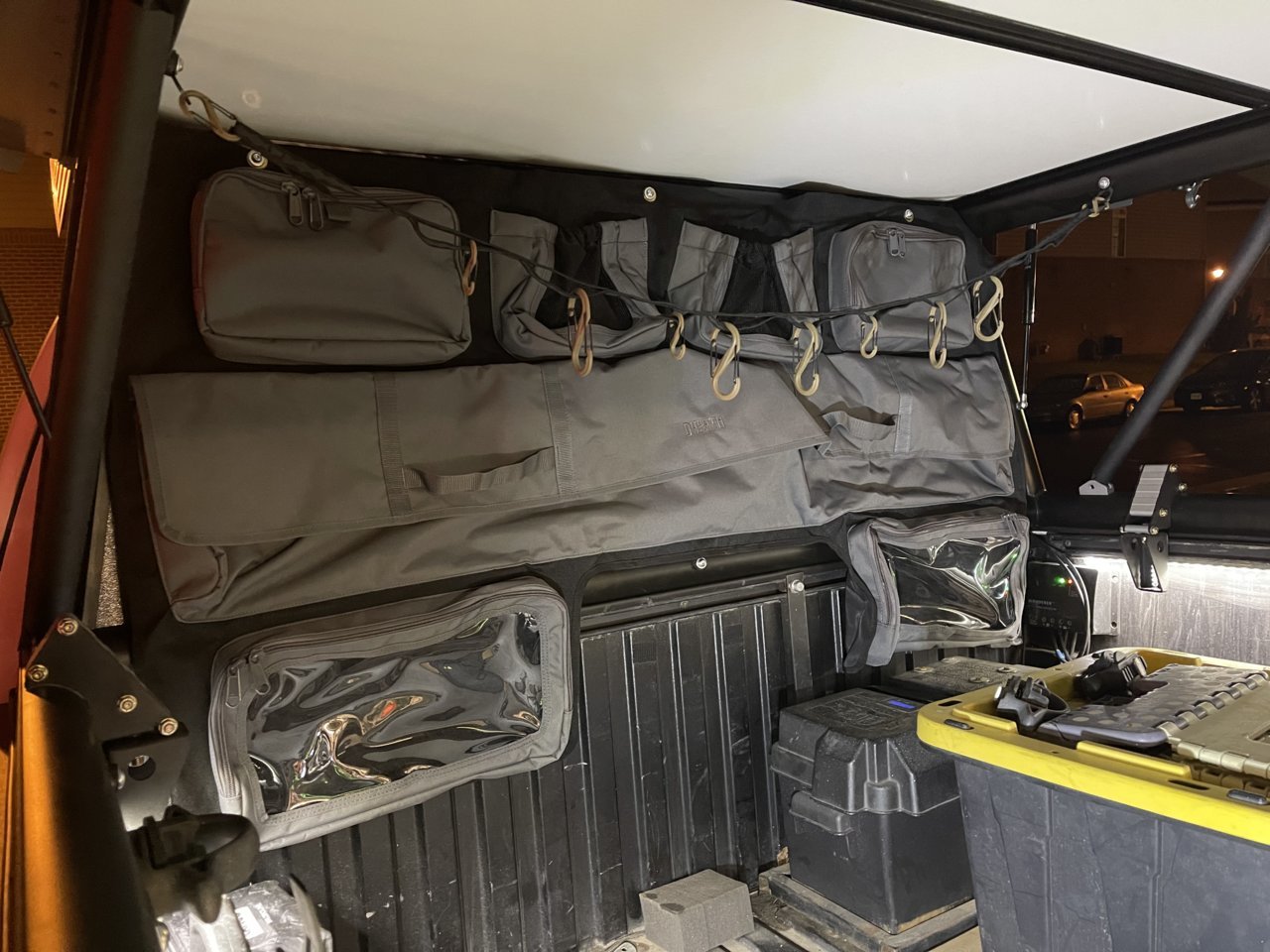

    Wow, easiest mod I've done in my life!

    Looks excellent! I bought a second one for my tundra.

    that looks great, hope I can make mine look as good.

    I used 3/8" grommets. Did not use the bar.

    I used both the bar and the grommets.... the bar after cutting it down slightly fits int the curve of the upper side bars and that'll help carry a bit more weight as I have it crammed full of stuff

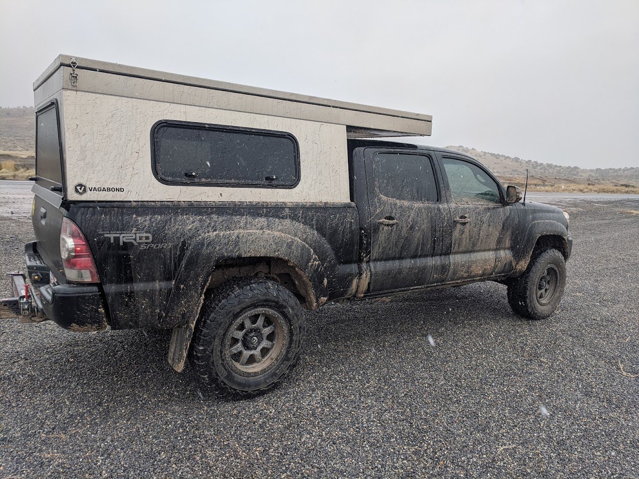

    I run the RXT on my truck with a Vagabond Drifter with a 270 awning and full bed build-out. I don't have any bumpers or other exterior mods in the back. The truck probably 600-700lbs in the rear on a daily basis and another couple hundred for a camping trip (including a full bike rack). I'm super happy with it after about two years; it's a perfect balance for me of handling daily weight without getting too overloaded when I'm packed to the gills.

    So you have it set at option 3 then it sounds like?

    Yep, sorry, meant to include that bit!
    Edit: Sits at about 2 inches of lift with camper and build out. I'd say it drops about an inch fully loaded. For reference, the front is lifted about 2.5 inches and I'm running 285/70r17 KO2s. So it's pretty level unloaded and a slight rear sag fully loaded.
