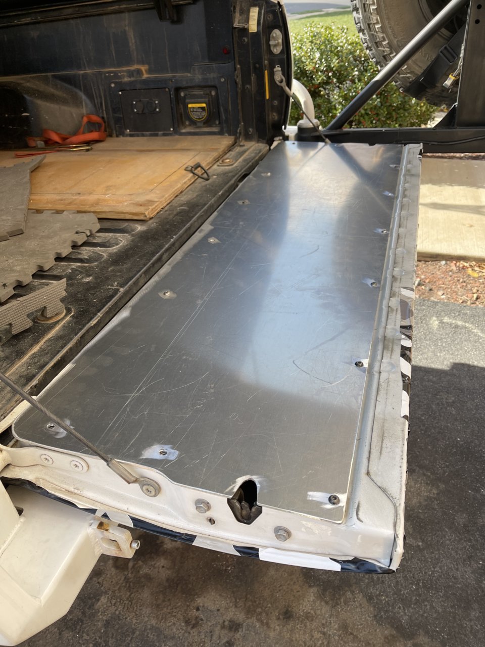

    I had a previous Mobtown tailgate cap. But both dont work together.
    The bed side caps/GFC mounting is not changed, or so little that it doesnt affect how the GFC is mounted.
    The GFC is "designed" for the factory bed side caps, so they claim that anything aftermarket should be removed before install. The 2nd gen factory caps are tall (taller than 3rd gens) and not suited for weight placed on them. Ive had a bed rack/RTT for a few years and I had some deformity. But GFC does work with you (in my case, I brought them a case of beer, and they installed my GFC with no issues and no clearance issues). In the case of the tailgate cap, they removed it there, but gave it back to me to figure out at home.
    I havent messed with it yet. My plans are to wallow out some holes and remove the 2 star bolts on the top side of the tailgate, so I can make it sit more flush. As of right now, I dont have anything protecting the top side. I also didnt mess with it because I was making a tailgate reinforcement/flat plate because I didnt want to spend $200+ on a trailgate or Mountain Hatch (I think I spent $80 shipped and some time trimming the aluminum. I used 1/8" 6061).
    I guess the only issue is that there is contact on both sides here. I used a file to grind it down a little. Its not going to rust, since its aluminum. Just doesnt look that great when you are 6 inches from it. Farther away, cant even see that anything was done.

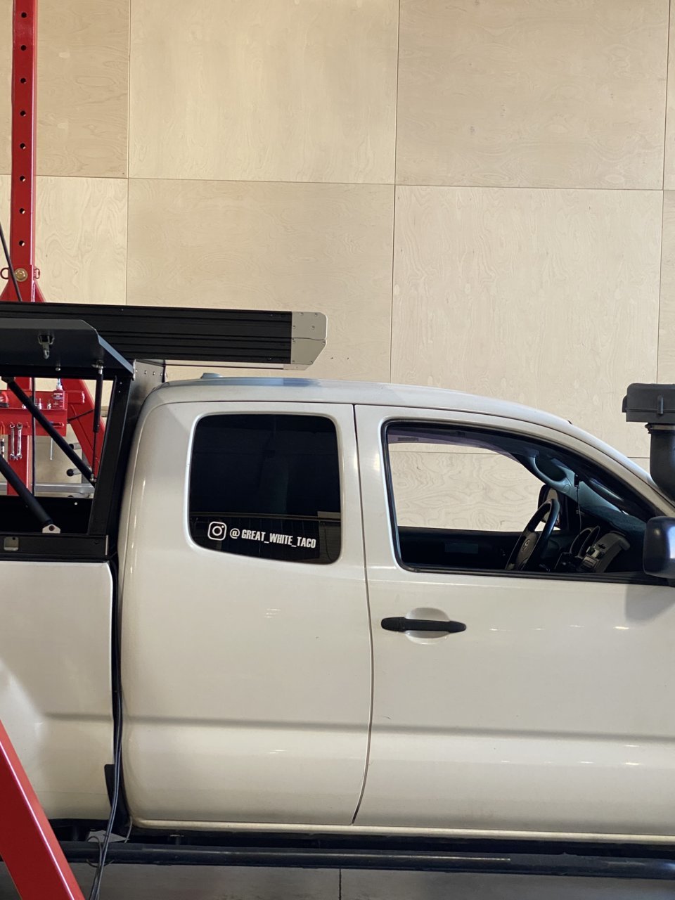

    Ah, looks like there might be a height issue, however, if you have a Martin Offroad Camper rack? My bedrail / tailgate caps look really good despite having all of that previous weight on it, so I may just wait so I don't have to make any mods.

    I sold my Prinsu. Not sure about others. But i was having a hard time with clearance. What kind of antenna do you have also? Shark fin wont work. You either need a delete kit or the little OEM one. Being a 2011, you might already be good.
    The factory bed rails are probably deformed. And most likely going to let dirt in (if you care about that).

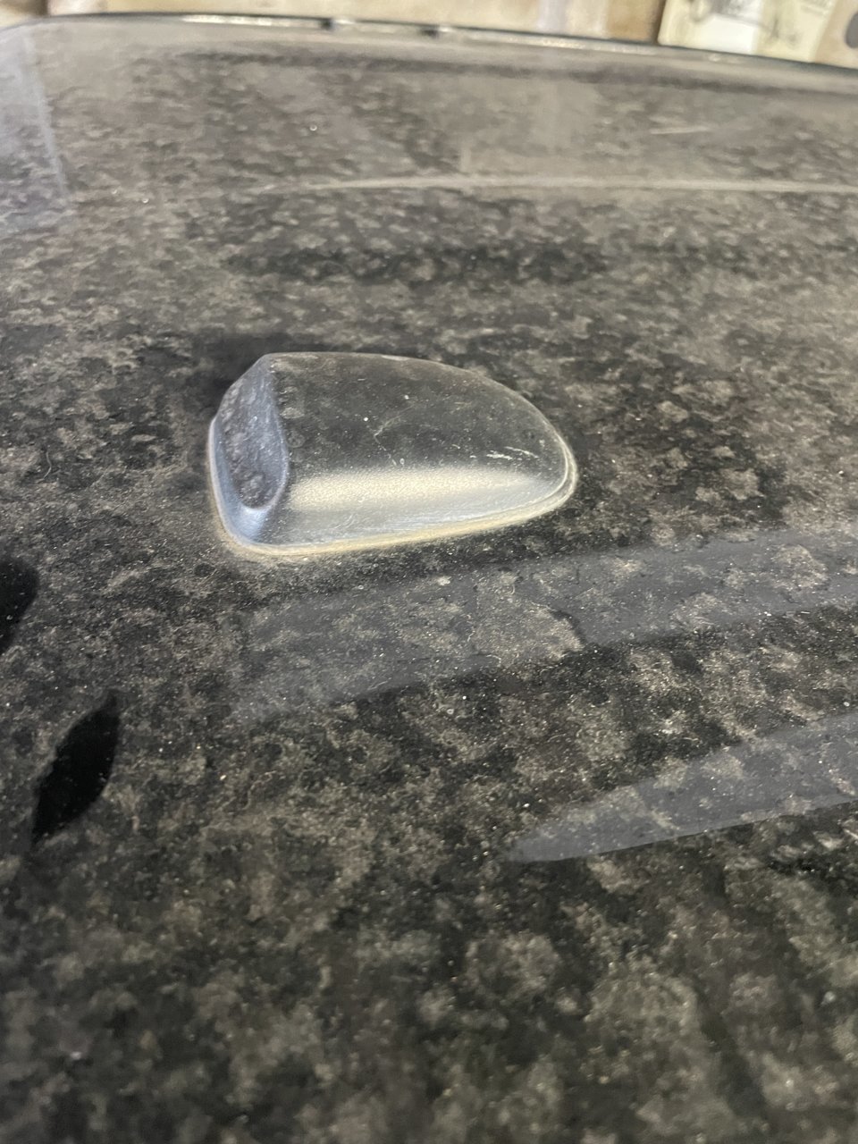

    Yeah, I was going to at the very least tape up the rails and silicone holes like you suggested earlier ... but don't want to have any clearance issues as I want to keep this rack. This is the antennae on my (dirty) roof; looks like the OEM.

    where do i get one of these and how does it even get installed lol...
    i have the factory sharkfin on my 2014.

    When I had my 2nd gen (2009), that was the factory roof antenna.

    Let me try to find the part number. Best bet will be ebay and it probably wont paint match. You will need to pull the 3rd brake light and/or drop the back part of the headliner
    TacoTyusday[QUOTED] likes this.
  17. Jan 19, 2022 at 3:12 PM
    #1877
    fatfurious2
    Jun 28, 2014
    #132884
    49,845
    David
    Ashburn, VA
    2010 TRD OR Access Cab
    This thread has some part numbers with paint codes.
    https://www.tacomaworld.com/threads/any-ideas-for-removing-xm-radio-antenna.201483/#post-9944681
    Heres a black one on ebay.
    https://www.ebay.com/itm/264905243396?fits=Year:2009|Model:Tacoma|Make:Toyota
    Id also try searching for XM antenna for 09-11. Pre 09 didnt have anything on the roof, and I believe 12+ has the sharkfin

    Tempted to just chop off the top since it seems the top half is basically just empty plastic...not sure how i'd seal it though. was hoping i wouldn't have to pull the headliner but seems that's the only way to get to it really.
