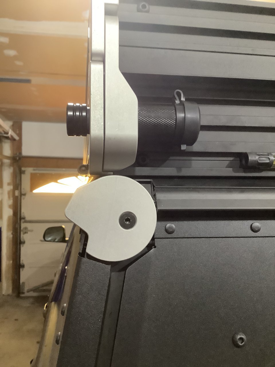

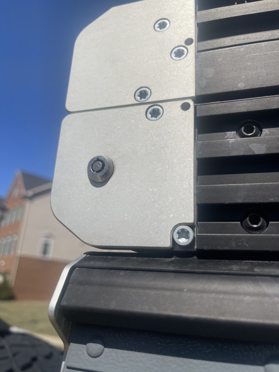

    I still need to order a bunch of things for when I redo my dual battery setup. But putting these pull knobs on was first and easy

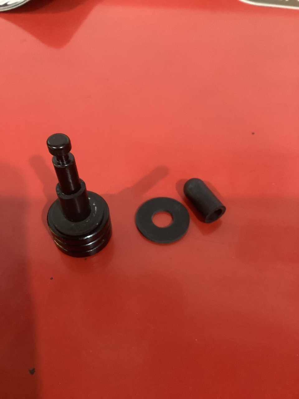

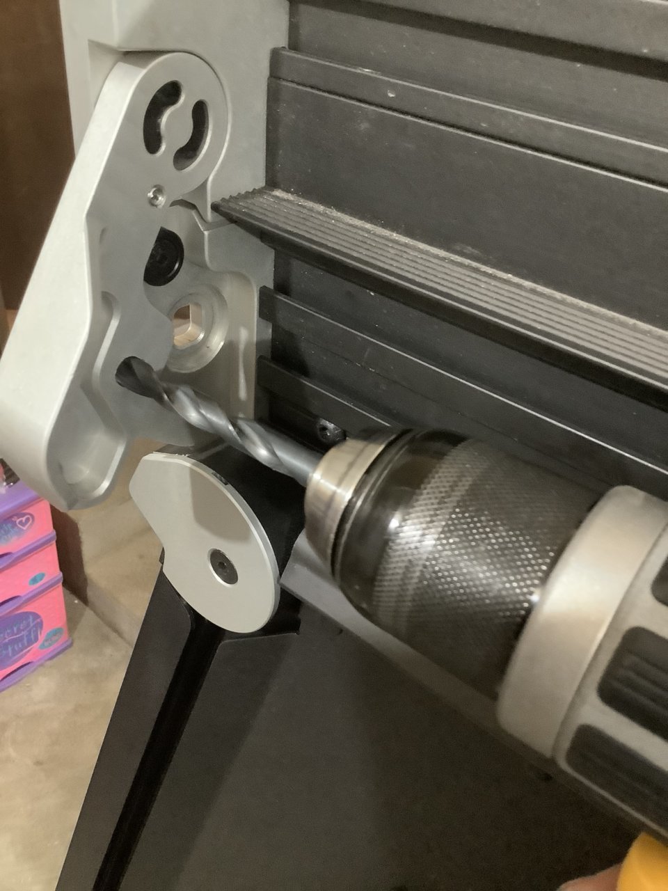

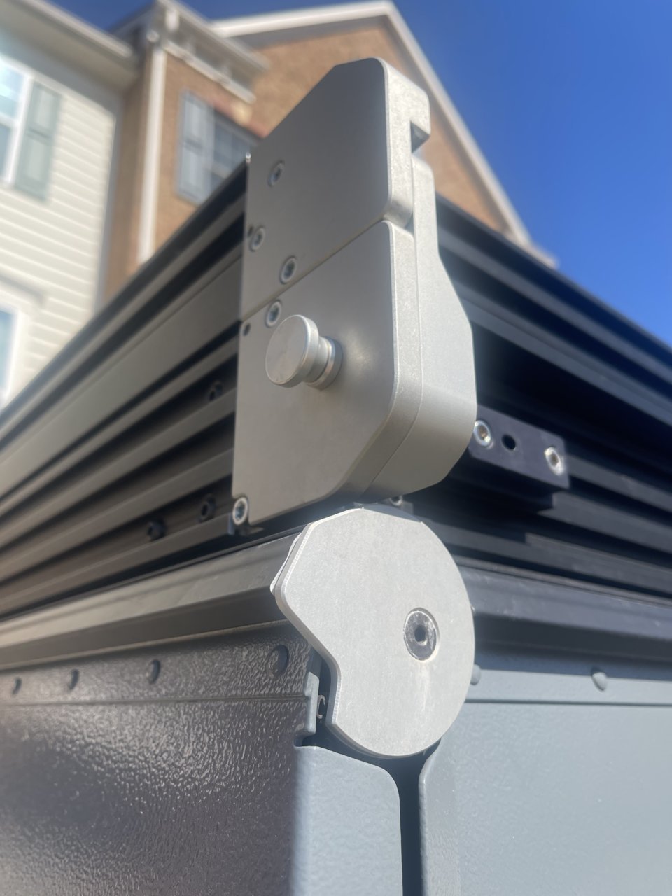

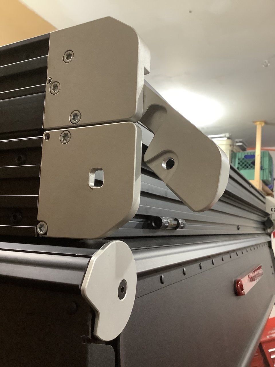

    Disclaimer- totally not my idea. CameraTech off of the GFC Forum came up with this, I just added a couple ideas.
    https://forum.gofastcampers.com/t/v2-tent-lock-failure/7524/39
    After pulling the latch pins, you are left with a rectangular hole on the frame bracket, and a small round hole on the hinge bracket. These trailer locks are slightly bigger than the small hole, and a 1/4” drill was not quite enough. I drilled the small hole on each side out to 5/16”. This Does not affect the closing at all, and you can pop the latch pins back in any time.
    For the trailer locks, I added a rubber washer on the outside, as well as cut the end off a rubber air valve cap and slid it on the shank. The rubber washer takes up the space side to side, and the rubber “sleeve” takes up the space inside the rectangular hole both for a very nice compressed fit when locked, no rattling, rubbing etc.
    These are the locks- they came keyed the same:
